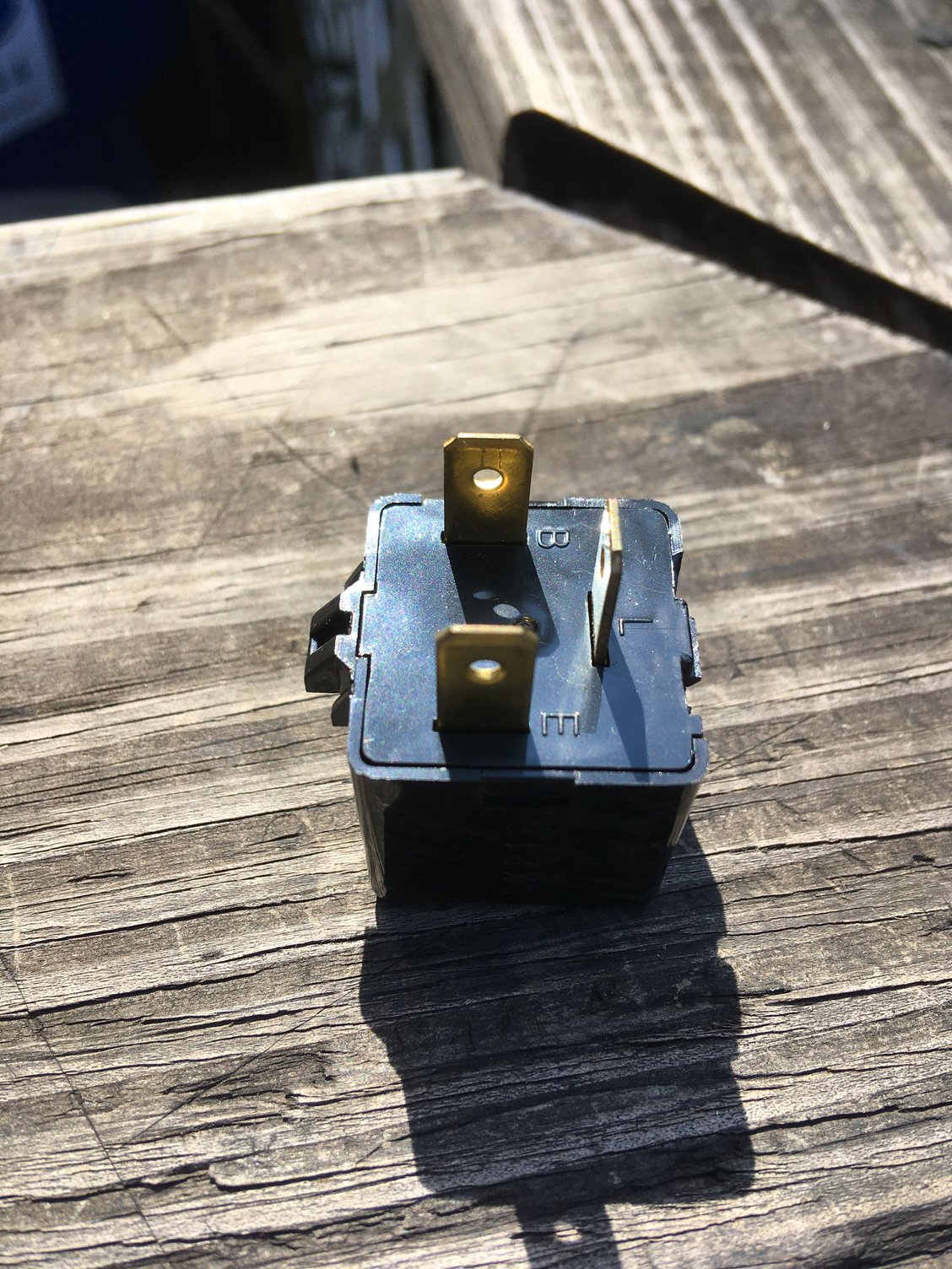

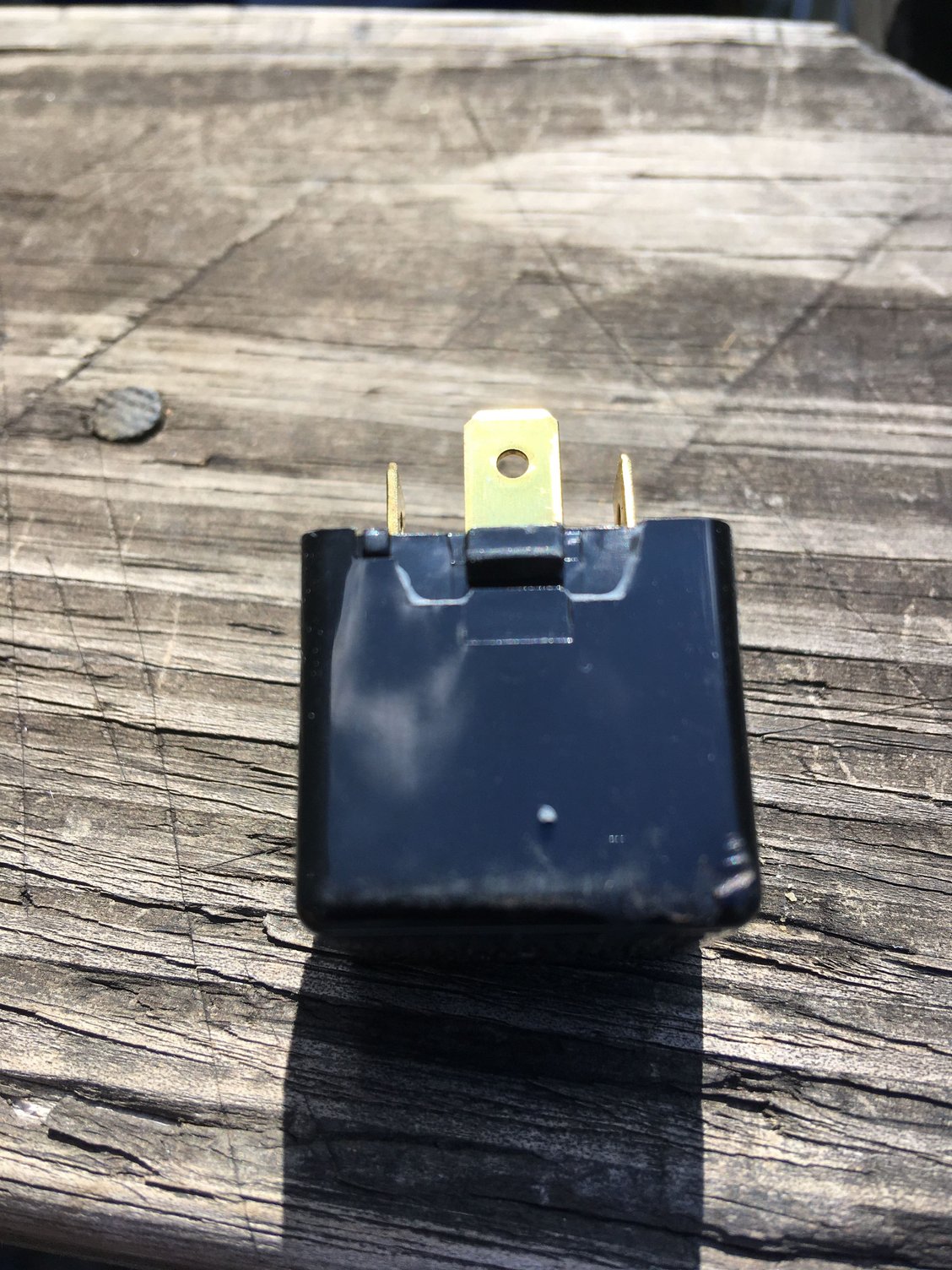

Look for clips on the sides and/or squeeze the relay sides. I broke mine forcing it out. Perhaps these photos will provide clues.

Look at the photo above. See where the 2 tabs are located? Get yourself 2 flathead screwdrivers (or plastic pry tools) and situate them between those 2 clips at the same time. Then use a rocking and pulling motion wiggle it free (don't be afraid to use some force). The tabs are completely unnecessary as the relay is secure just from the friction of the mating of the spades into the sockets of the fuse box....This is an unnecessarily frustrating job, but not impossible if approached properly.
