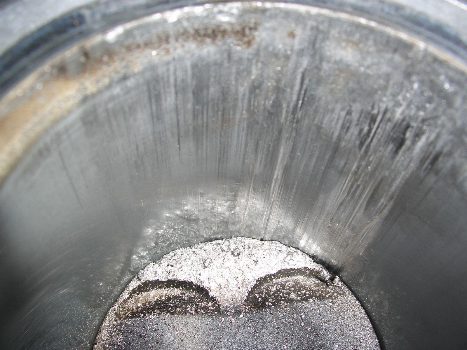

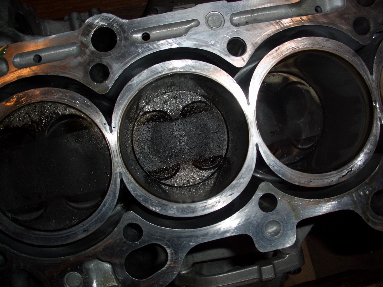

Well, I finally got the motor out and it sure looks like detonation. I took a few pics (cylinder 3 is the one show and the worst, 4 was going and 1/2 had burn marks) but they really don't show the extent of the damage. The short block and head are over at Laskey racing (he said the pistons were cracked and the rings broken and crumbling) to get bored and sleeved with a Darton Sleeve. I think I'm going to drop the compression to 10:1 and bore it to 88mm. I'm hoping the head can be salvaged but there was quite a lot of buildup on 3 and 4. Since the motors out, I plan to get a Berk header and high flow cat (straight pipe for the track), I just received an ACT l/w flywheel. If the head can be saved, I'll do a valve job and put in dual springs with titanium retainers and new valves.
It's unfortunate that it happened but I did have a good time buying tools and pulling the motor out. I must say, the Helm's manual is a lifesaver! I took lots of pictures and used number tape at all questionable connections. Hopefully it goes back together as smooth as it came apart!

holy detonation, batman
