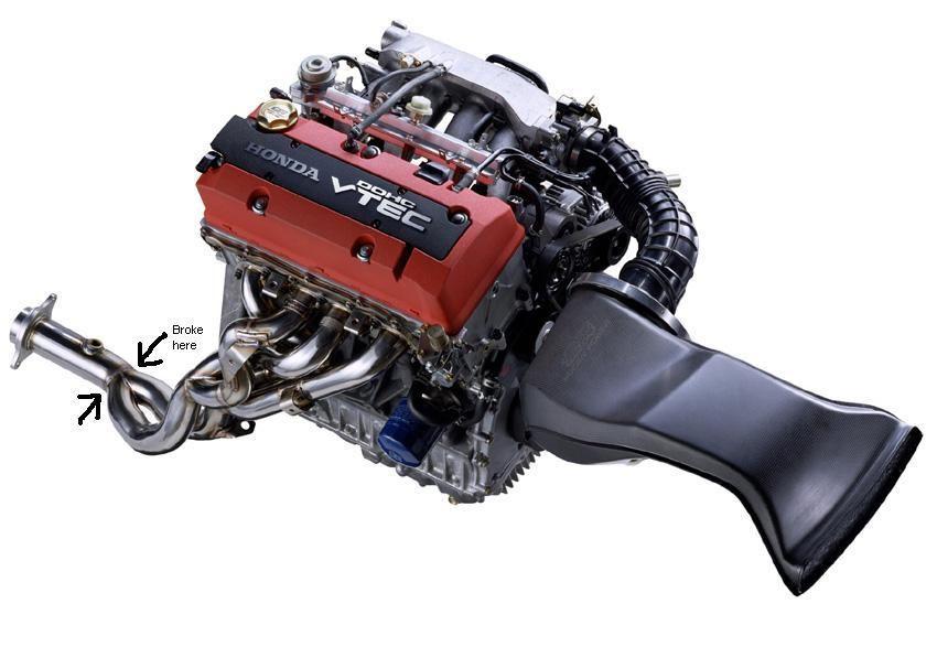

Has anyone had their headers break in two? I have heard of some bracket failures, but never the header itself failing.
While I was out driving the dragon today, my Mugen header (1.5 yrs. old) snappped into two pieces. The break occured at weld between the two intermediate pipes and the main pipe that extends to the catalytic converter.
Since the break occurred before the primary O2 sensor the engine would do little more than idle. This left the car stranded an hour away from home. I will try to post more pics when I get under the car today.

Here are a few pictures that I took today of the broken header.
I will let you all know how it turns out.
