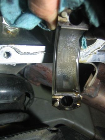

Do you have pics of the rod and crank bearings?

Ill post pictures of the rod bearings shortly.
keep in mind honda rod bearings have a silverish coating, not that dark color. not to mention that they were out of spec, max clearance was .0024" they were .0036'' and new clearance is .0012"
here they are: in order left to right, 1-4

Thanks! The wear on mine is similar:
I haven't been able to check the clearances, but I figured that since I knew the motor had been starved of oil and they looked worn, I should replace them.
