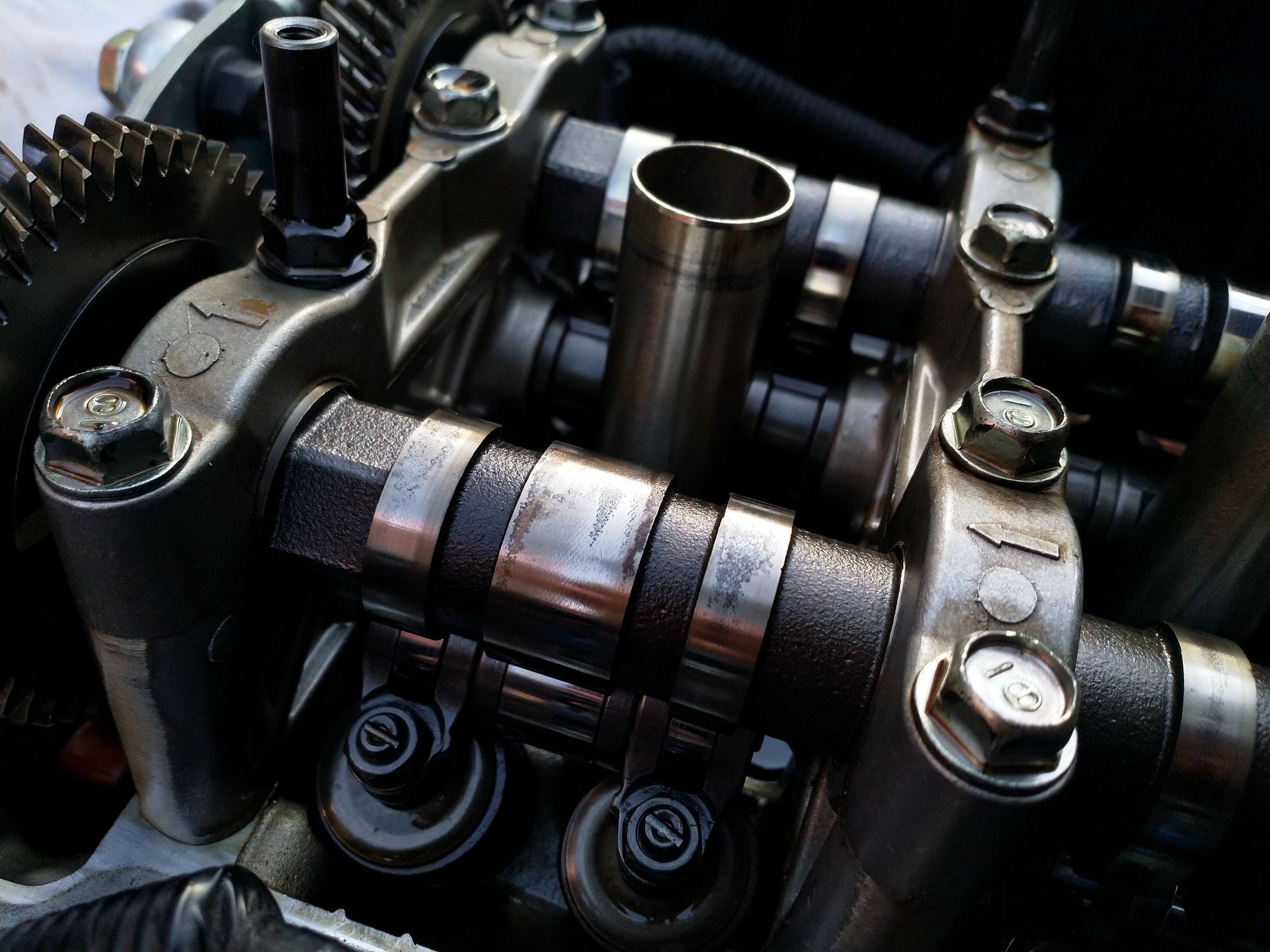

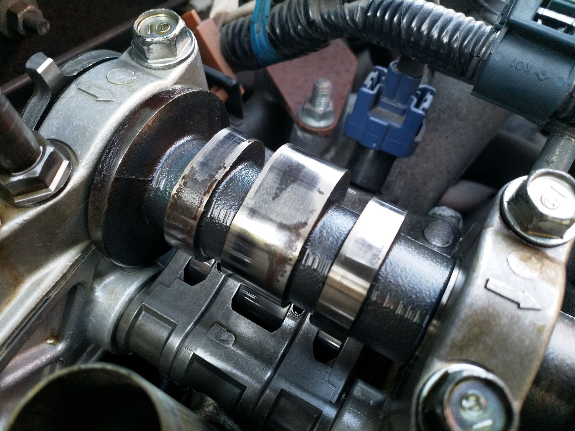

While checking valve retainers, clearances and the cylinder with an endoscope, I've found marks on the intake cam lobes, cylinders 1 and 4. There's enough there that you can feel it with a fingernail, but it almost feels proud of the surface rather than into it? 12k miles and ~10 track days ago, it was fine. Is this anything to worry about?
S2KI threads I've found are inconclusive (https://www.s2ki.com/.../s2000.../cam-lobes-wear-868838/) or "rust damage" followed by "oil change and run it for a while and it'll be fine" (https://www.s2ki.com/.../s2000.../burnt-cam-lobes-1184865/) - and neither thread was followed up on
This is a MY07 UK F20C "Facelift". Any thoughts or information would be very much appreciated...
Cam lobes for intake valves cyl 4
Cam lobes for intake values cyl 1

Water damage from prolonged exposure, engine sat dormant for a long period.

Thanks @Billman250 . Sat on the drive for ~9 months during lockdown in British weather, didn't expect that amount of hurt from that - it sounds like I might well have been wrong. Time to look at cam replacements.

All camshafts for the S2000 are junk except for oem. Does your car have a catch can? Not only do they catch oil, they catch water and spew it into the engine.

Nope, no catch can although I was thinking of installing one. That's me told. Also, bloody hell are OEM cams expensive. £1300 for the pair in the UK (imported from Japan)

If the price of OEM replacements are a deal breaker, maybe you can clean them up a bit, and / or add oil and see what happens with the ones you have. If and when you need new ones, you really should get the OEM ones as Billman recommended.
