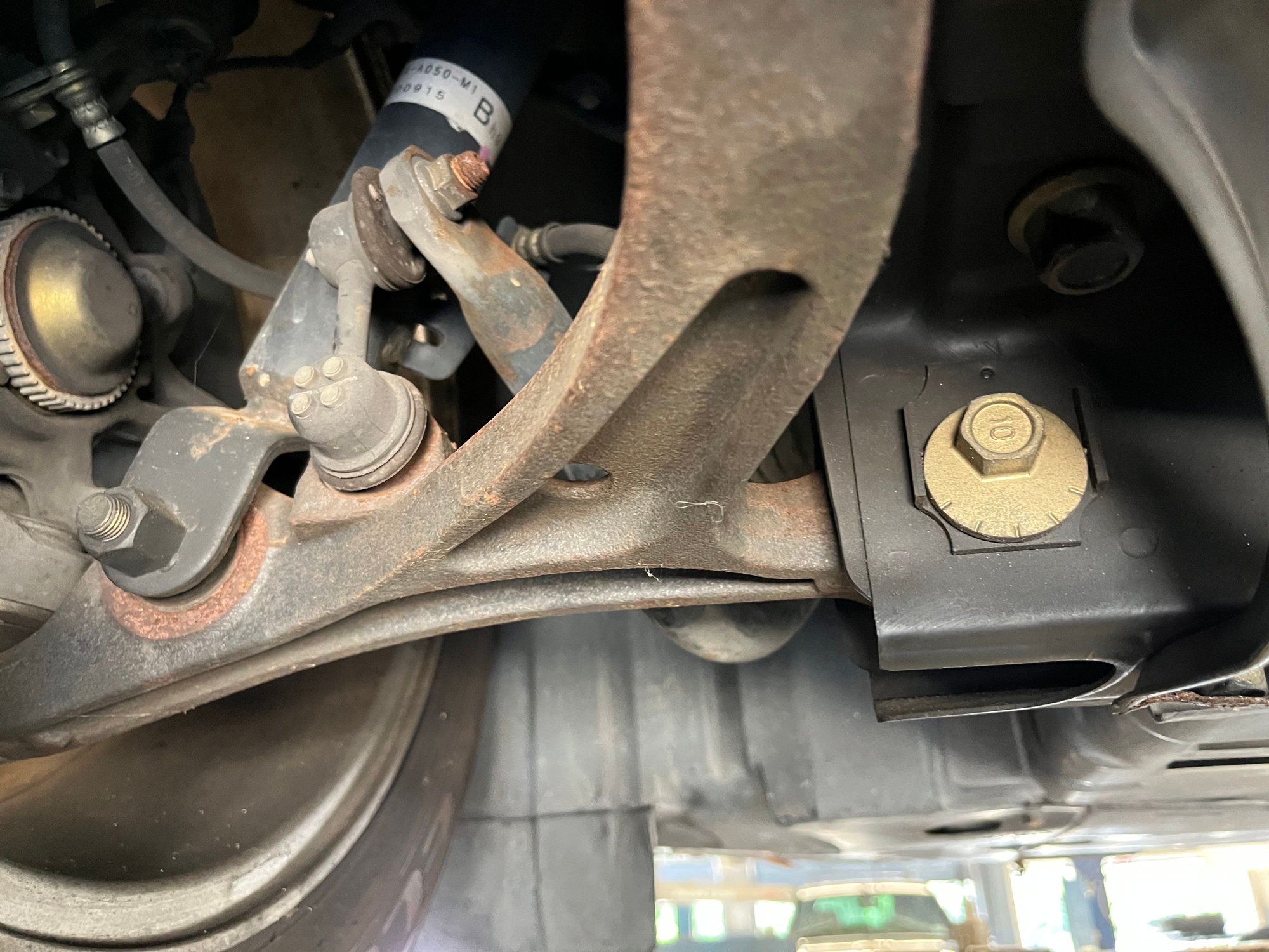

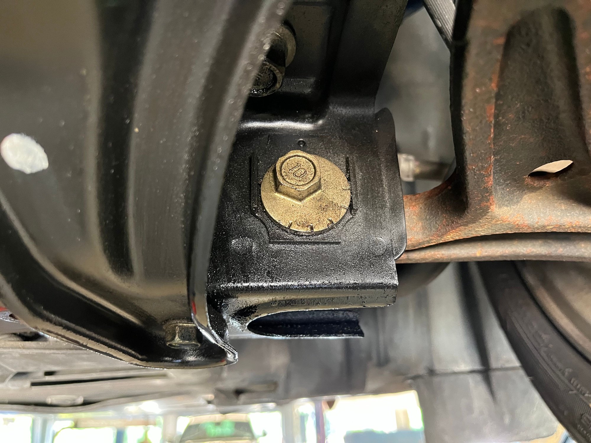

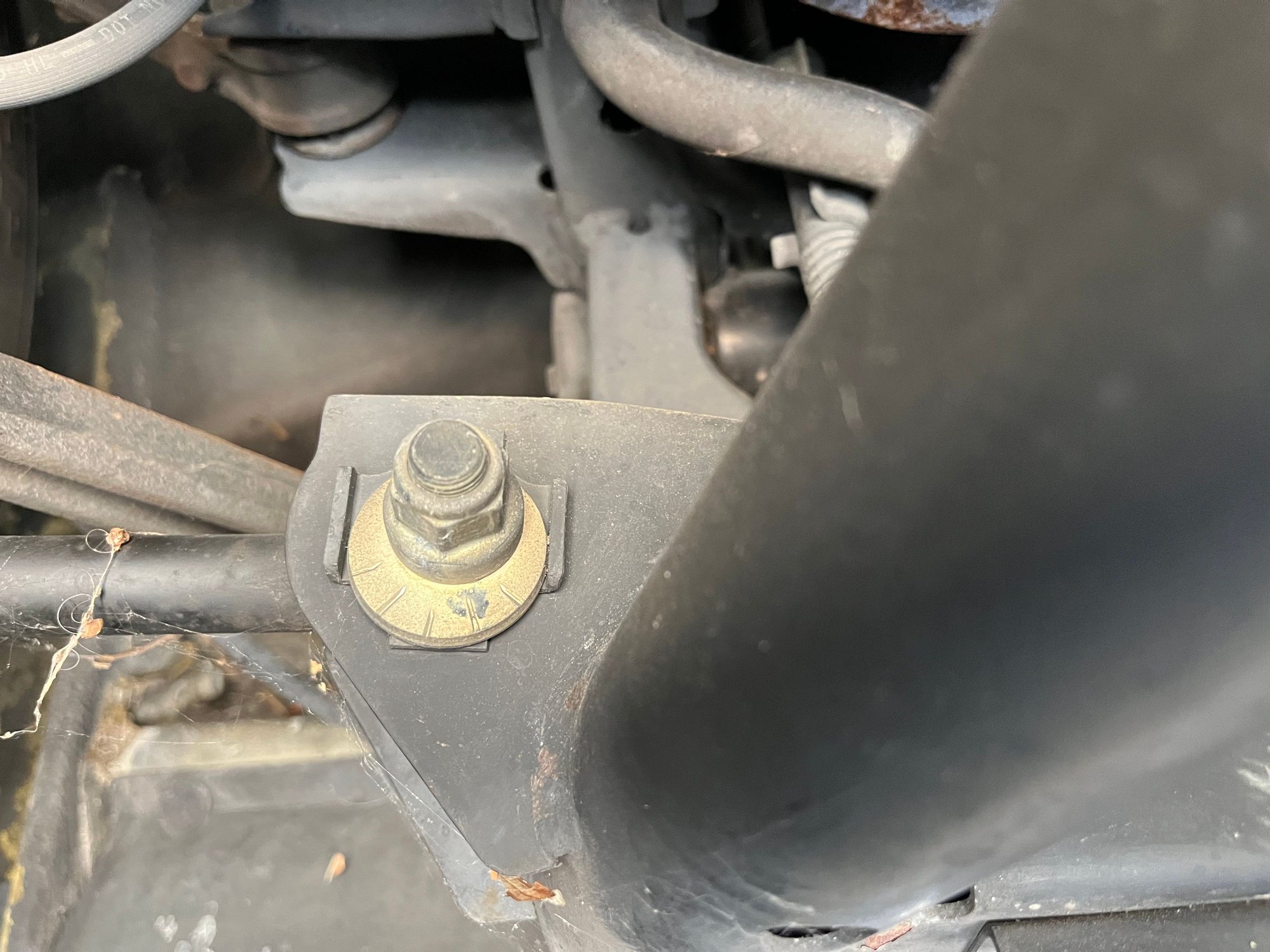

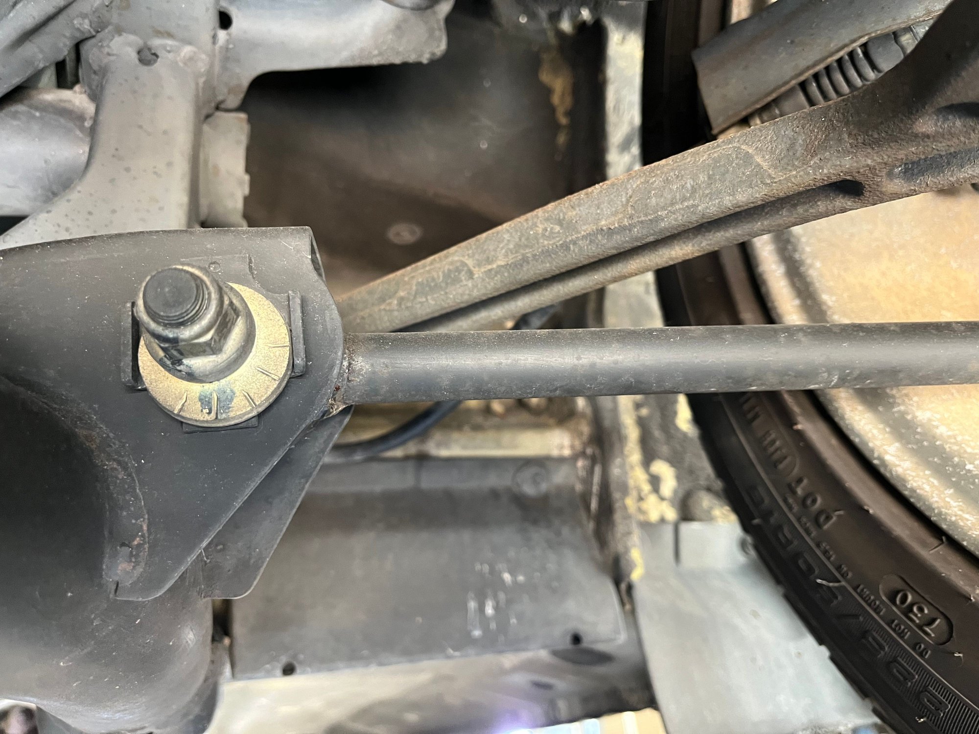

looking for recommendations for camber settings. Stock ap1, driven daily. Would a little neg camber help with the snappy rear end?
Front right
Front left
Rear right
Rear left

Some neg camber in the rear would help with lessening oversteer. You would need roughly double the front camber at the rear to experience this effect though. If you're lowered you will naturally get more camber but at stock height a decent amount (-1.5 to.8 ish) if I remember correctly.
