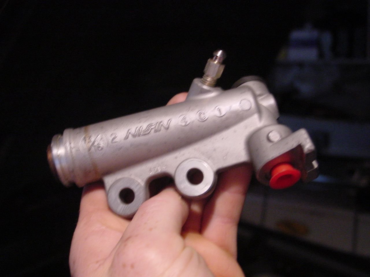

Aight....hold the slave just like this, make sure the master is full, and open the bleeder. You'll see bubbles

Where the black rubber boot covering is. There is a piece inside of there. Make sure it is pushed all the way into the cylinder. You can actually take the whole boot off to make sure. There will be a black piece with a spring on it. Make sure it is pushed down into the cylinder like the above picture. This happened to me, and I had to push it in so I could bleed.
