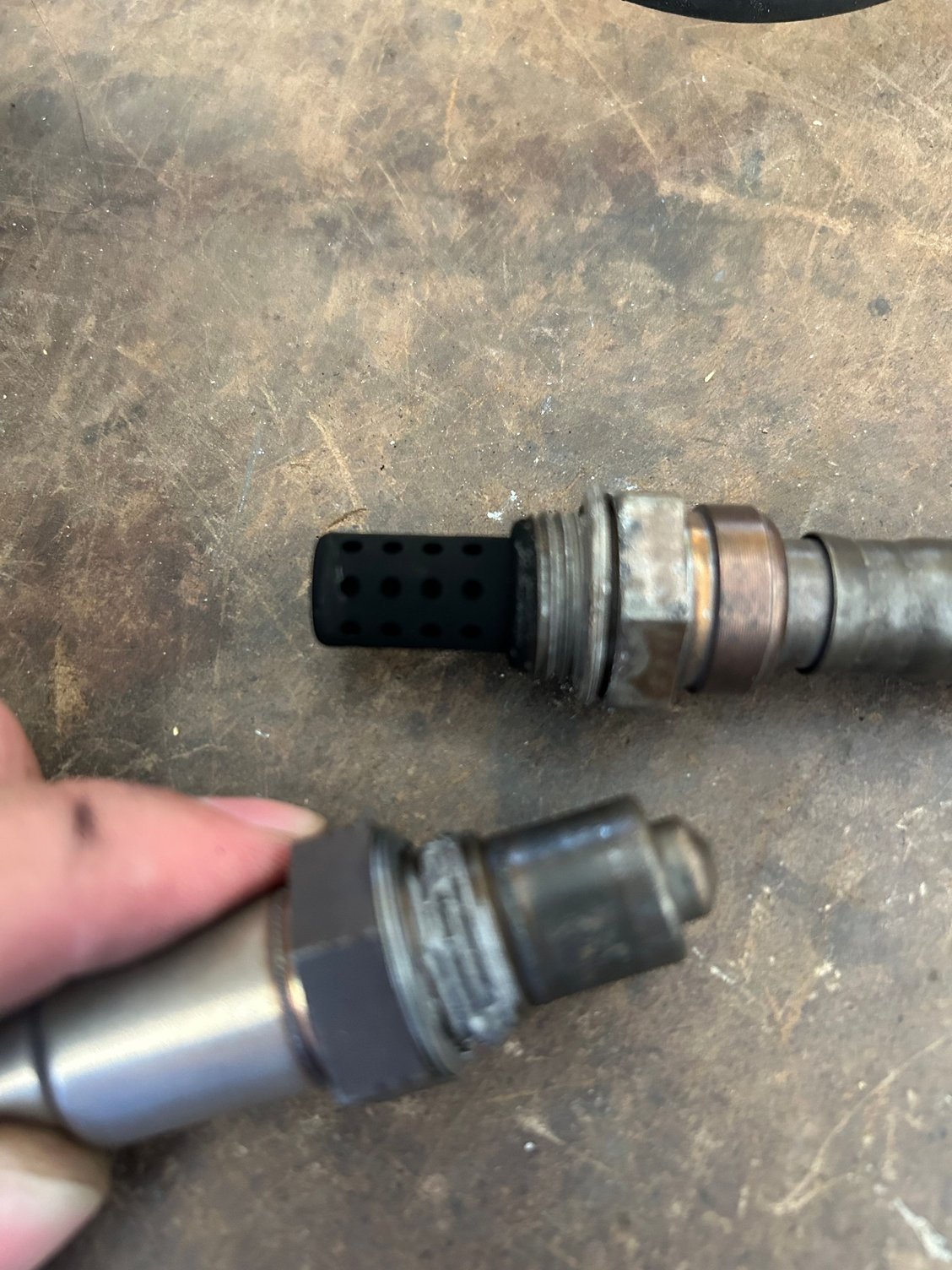

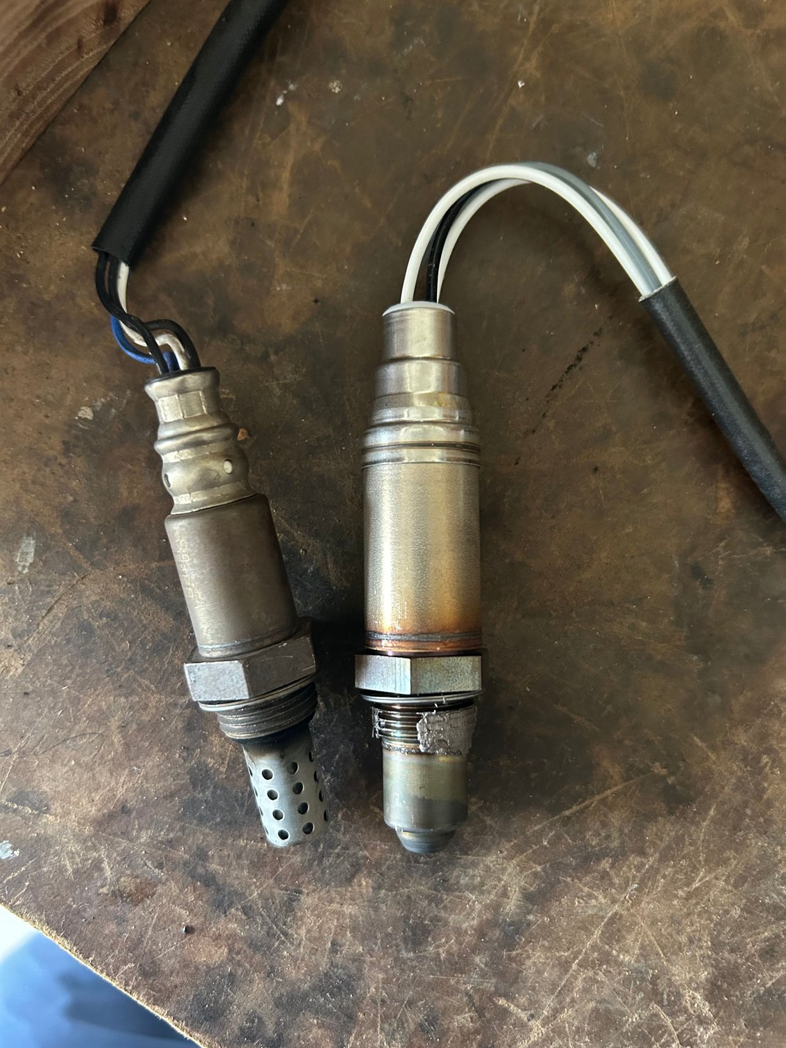

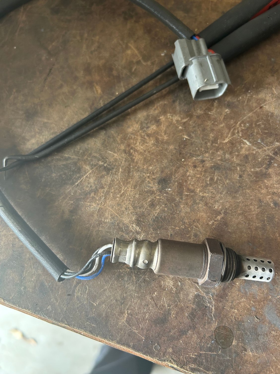

Bought a cheap $30 o2 sensor to see if it would fix my afr
Clearly different from the oem, although, I’m not certain these are the OE sensors.
If the new upstream sensor doesn’t fix my Rick fuel ratio, not sure where to go next.

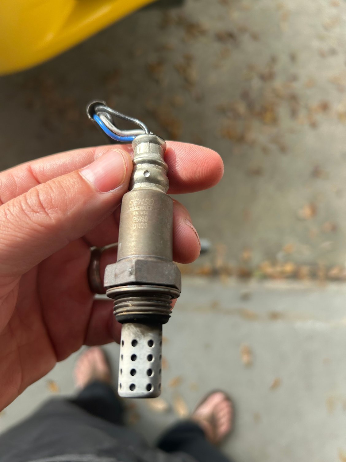

Picture says Denso USA. Would it be safe to assume this was a dealer installed replacement?

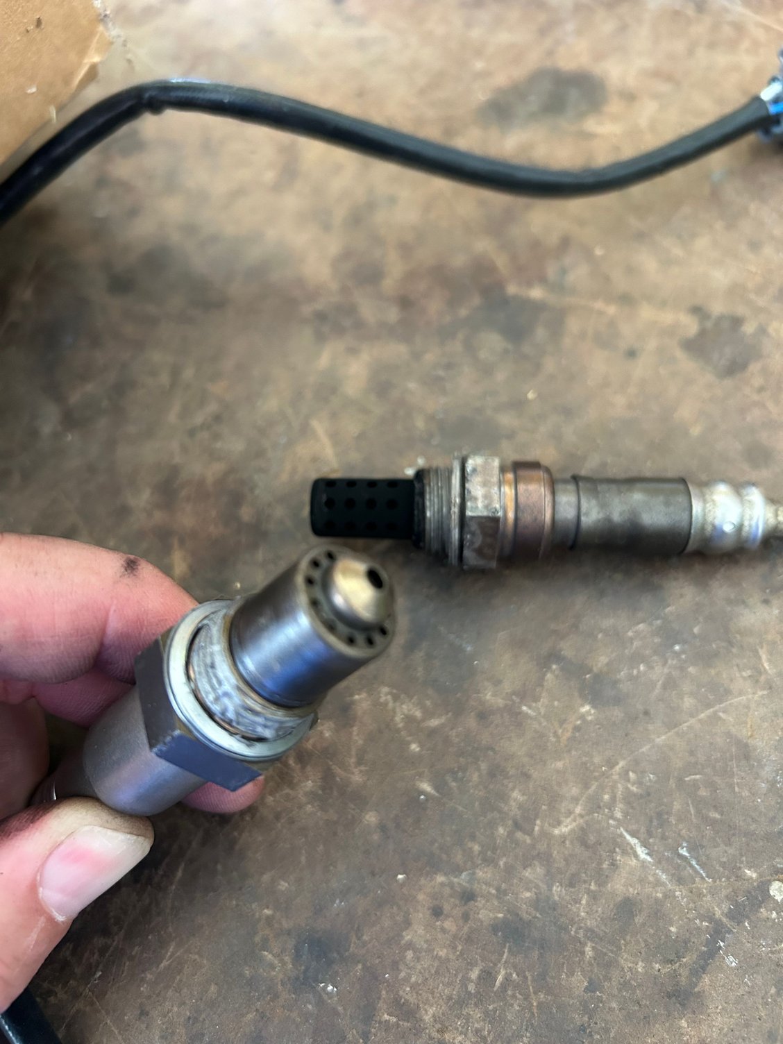

You can see the difference between the Bosch and the denso unit. I hope the 1/2” increase in height doesn’t interfere. Otherwise it’s back to the drawing board

That Bosch sensor is going to cause a CEL.
Why are you changing your O2 sensor?
Old Mar 31, 2025 | 09:46 AM
Dibsen's Avatar
Joined: Aug 2023
Posts: 800
Likes: 277
why is that?
I’ve been having some fuel problems causing the car to lose power and “stumble” on occasion. Trouble shooting lead me here. So far, seems to have fixed the issue
