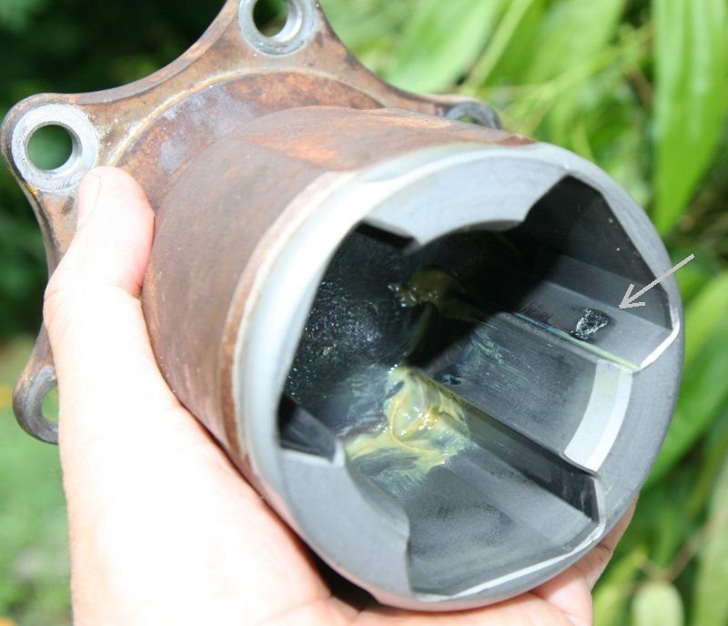

click, click, click

Excuse my mechanic noobness - but what is that?
Old Jun 20, 2009 | 04:25 AM
  #29
S2Kart's Avatar
Joined: Nov 2006
Posts: 748
From: PDX west
That's an inner CV (constant velocity) Hub. It bolts up to the differential and the axle has a 3-roller spider that rides in the CV Hub. This one was on the left (driver's) side. You can swap the left and right hubs if one or both are making noise or causing vibration - instructions are in the DIY section.
Thanks for the help - If I had to ask a mechanic to do it, what would I say?
