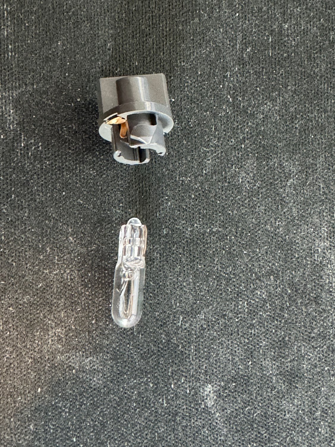

Hadn't ever heard this before but the bulb in the S2000 cluster only has a unique plastic base that can be re-used. The bulbs are standard #74 bulbs you can buy very cheaply. Realized this after I bought a full set from Honda and realized you can just pull the bulb out of the existing base and replace. Hopefully it'll help someone else.....

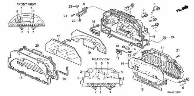

Picture shows them as separate items but Honda doesn't seem to sell them separate but this is definitely good to know though.
