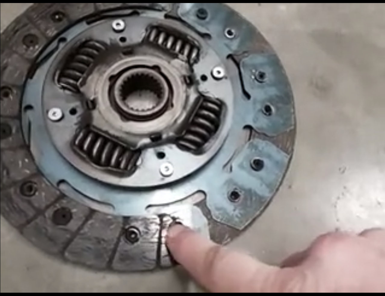

I purchased my 04 a little over a month ago and last week I began experiencing clutch issues. It started when I lost all clutch pressure while driving down the highway but then it came back, albeit fairly weak, but still driveable. I assumed master cylinder so I replaced and bled the system. Still had the same issue. I then noticed lots of shaking and juddering getting going in first or reverse and also while turning right at low speeds but the car otherwise drove fine, shifting through all the gears without issue. The most bizarre symptom it demonstrated was if I brought it up to high rpms I would lose all clutch pressure again only to return shortly thereafter. I elected to bring it to Honda who quoted me $3,200 for parts and labor. I bought the parts myself: OEM friction disc, ACT pressure plate, OEM release and pilot bearings, release bearing guide, and a new lightweight flywheel. Labor was quoted at $800 for the install.
Honda called me today with a video and some info on my car. Now I had known when I purchased this car that it was lightly modified but the car was VERY clean, the engine ran very smooth, and transmission felt as it should. As it turns out the engine is from another car and the trans is also from another car. No biggie, however whoever did this work really ****ed up. Cross threaded 3 bolt holes, trans mount was loose and misaligned, etc. With the symptoms I was experiencing I had guessed either the pressure plate was damaged or one of the springs in the friction disc had let go. Nope. Half of the friction material just came apart from the disc. Picture below.
Interesting. Coincidentally, I am having those same excessive shaking/juddering symptoms right now as well.
I guess my friction-disc probably looks like that too, or similar.
It makes sense tho - uneven/broken pads on friction-disc will most likely mean uneven contact with flywheel/PP, causing chatter/shake/judder.

Looks like an Exedy disk too (or some other cheap 3rd-party disk).
Previous owner of mine also put in an Exedy in the car.

That's not a factory disk
It looks like an Exedy. It was bound to fail.
