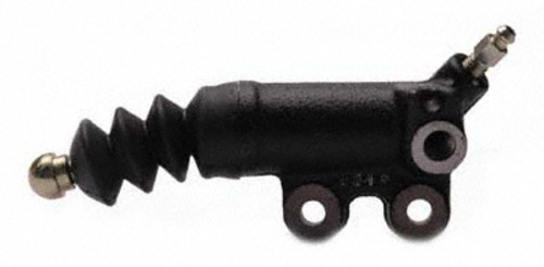

Bleeder is the nipple with 8mm hex head, upper right side of slave, in photo. Opening this = fluid to flow. Attach hose to nipple.
Unless you are built like Thinman, I recommend lifting the car off the ground, onto jack stands.
http://images.wrenchead.com/smartpag...C360112-11.jpg
