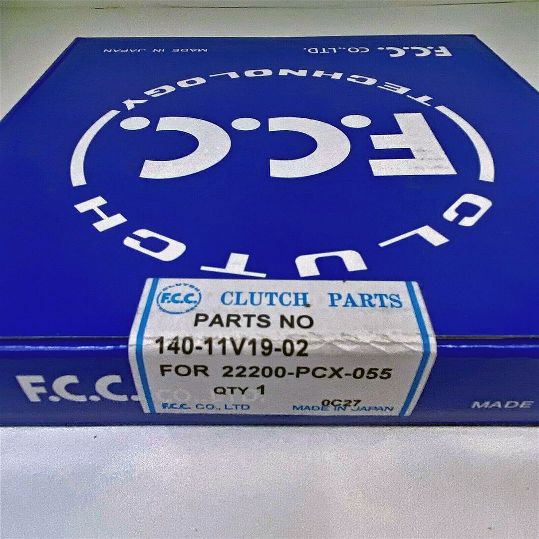

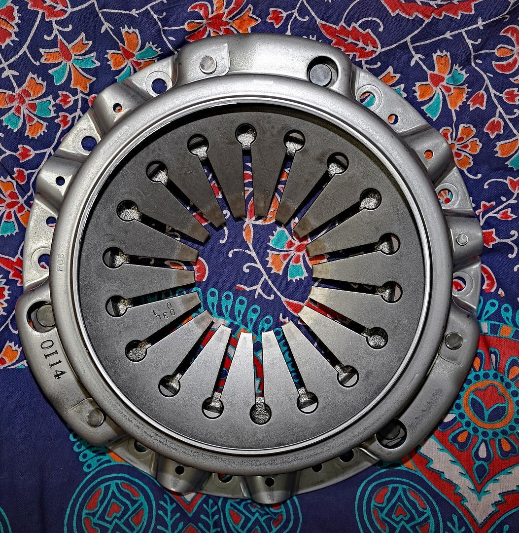

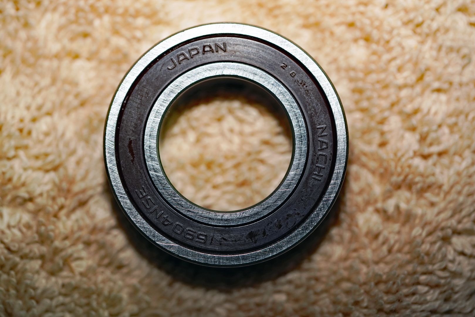

I bought a clutch kit (disc, pressure plate, throw-out & pilot bearings) from a seller in CA. The kit was total $400, shipped (May 2021) — and appears to be manufactured by the same company that supplies Honda. It took 3 days to arrive at my house.
Pressure plate.
Disc box.
A dealer bought the disc on the left. The disc from kit is on the right.

The kit’s pilot bearing.
