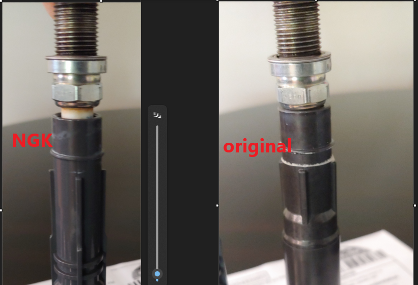

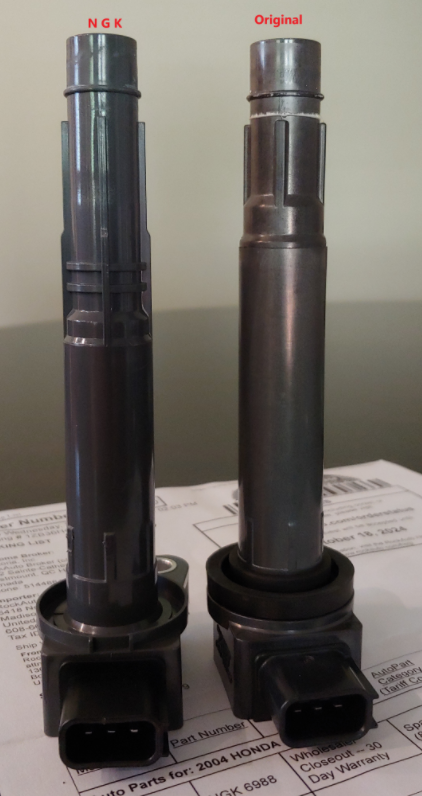

Coils are exactly the same height, but as you can see, the plug doesn't sit as far down in the NGK coil. Maybe that's fine and as intended, and it's the valve cover that is the culprit here -- I've got the original '02 cover.
