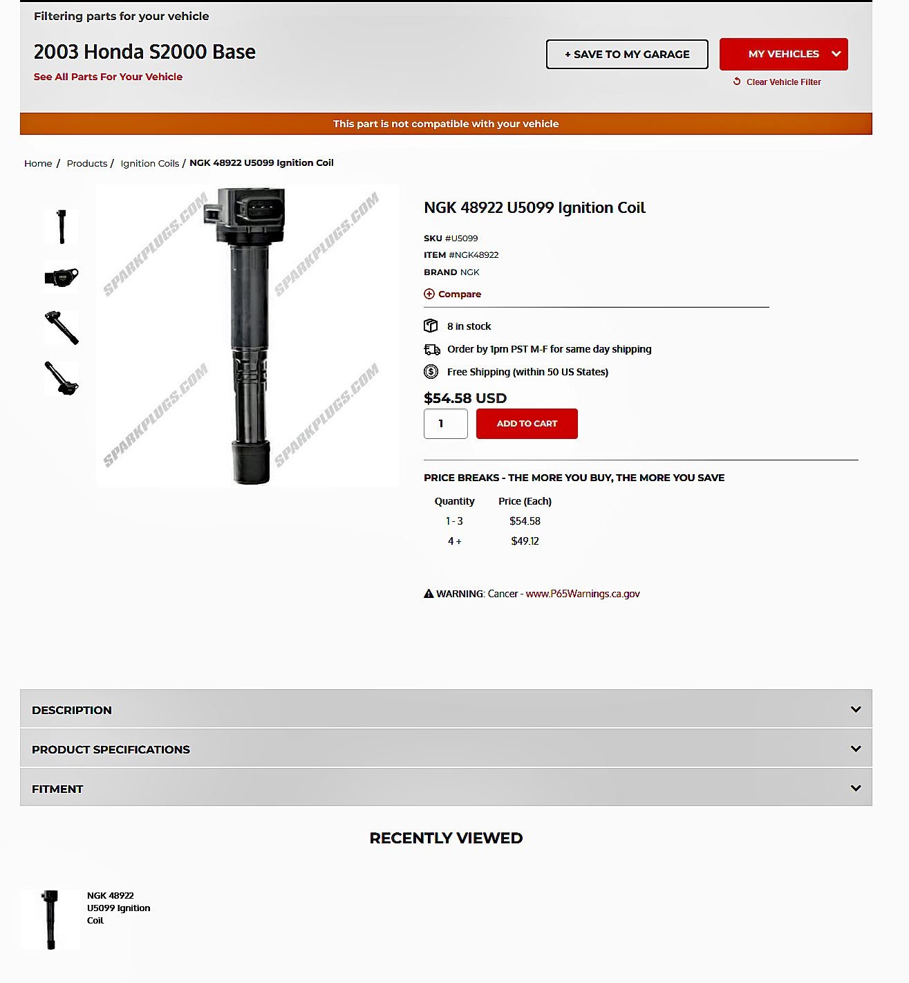

I've got an '02 S2000 and want to replace the original coil packs to see if that resolves my hesitation issue. Anyway, on Rock Auto, the 02-03 packs are $151 each, but '04 (Part #U5099) are $33... so I bought a pack of the less expensive ones. Who knows why the others are 151... that's nuts.
Anyway, I heard that the '04 coils would fit, but I'm struggling with them. I put an old plug into one of them and I can see that the top of the plug doesn't reach the 'bottom' of the neck of the coil. The same plug will sit all the way down in an old coil and goes 'thunk' as it hits the contact within that neck. It's difficult to describe.
Maybe past iterations of these particular coils *did* also fit pre-'04 cars and for whatever reason they don't now.
I doubt I can return them, but maybe I can manipulate them in some way such that they will seat completely on the plug. Maybe remove the spring and replace with one from the old coil?
It's definitely not the rubber seal (either top or bottom) that is the culprit, as even with the bottom one removed, the plug doesn't sit all the way into the coil.

This is what I got from NGK site. I guess you'll need to send them back.

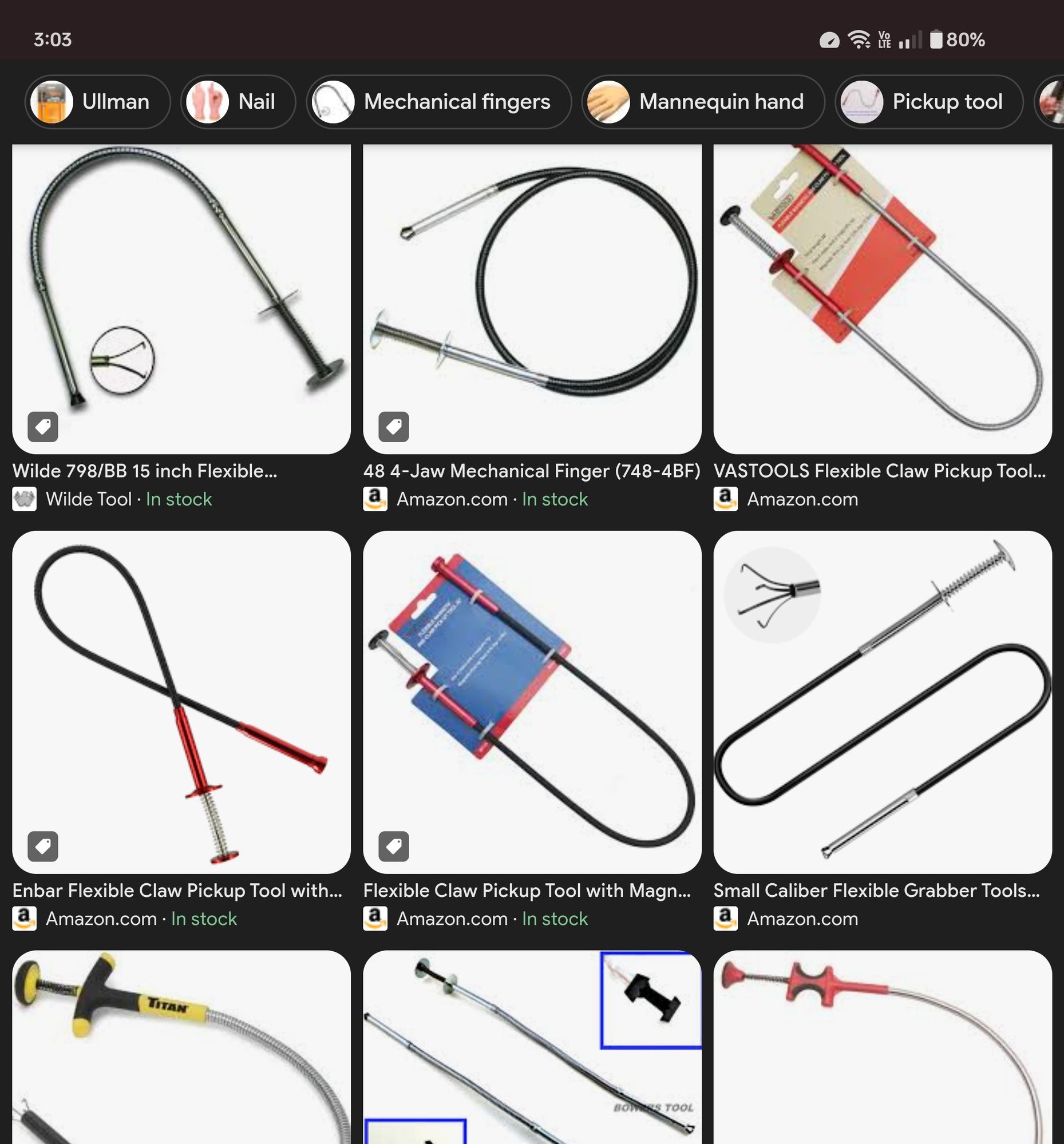

If you don't own a set of fingers you should

** UPDATE ** : got the little bugger out. Thanks all. Now back to searching for an affordable set of coils for this fricking thing.
Thanks, but those fingers wouldn't have enough clasping strength to pull it off the plug.
I tried putting the coils on the car and noticed that the bracket thing (with the screw hole) wouldn't fit flush with the cover. Try as I might, none of them would sit down far enough. On inspection with them removed and using an old plug, I see that they won't fit all the way down over the exposed end of the plug. They are simply the wrong part and most definitely won't work on this car. Live and learn.. that's what I get for trying to save some money.
But, bigger problem is that I now have to get this rubber cap off the plug. I'll have to go buy an extra long set of needle nose pliers.

This is what NGK says:
https://www.ngk.com/ngk-48664-u5245-ignition-coil
Denso packs are no longer available. Prolly why NGK is so expensive.

The NGK coils I bought from Rock Auto are in fact meant for only '04 + '05, which their site (and Rock Auto) is clear about ($50 each):
https://www.ngk.com/ngk-48922-u5099-ignition-coil
These are the NGK coils that would fit my car, as winhund116 mentioned ($150 each!):
For various reasons, I was reasonably confident that the *NGK* coils meant for '04/'05 would work on my AP1, as the '04/'05 *Denso* coils do (as you mention). But apparently that's not the case for the NGKs. Or at least, I am not able to make them work.
