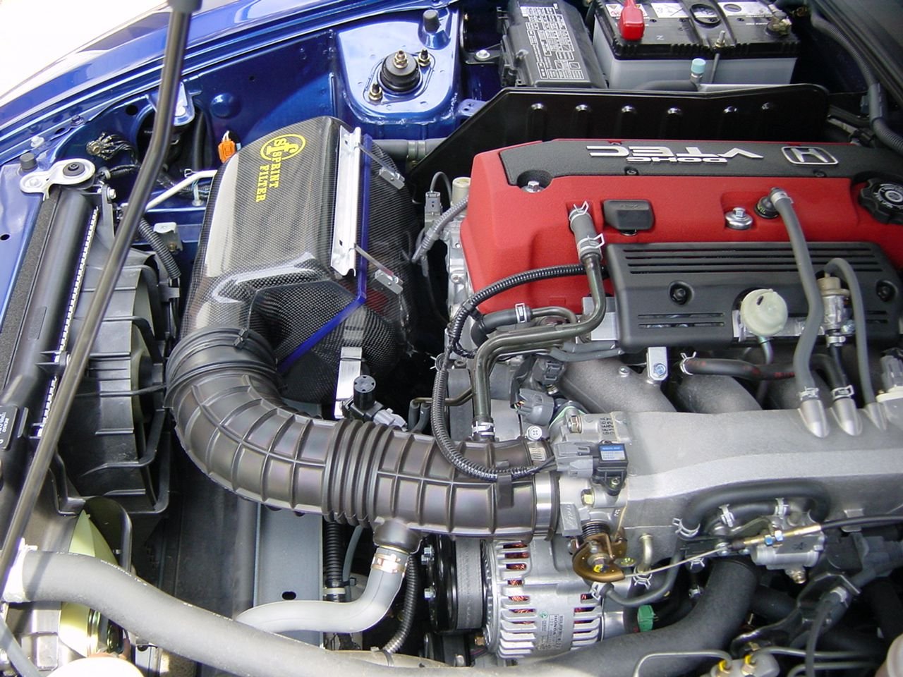

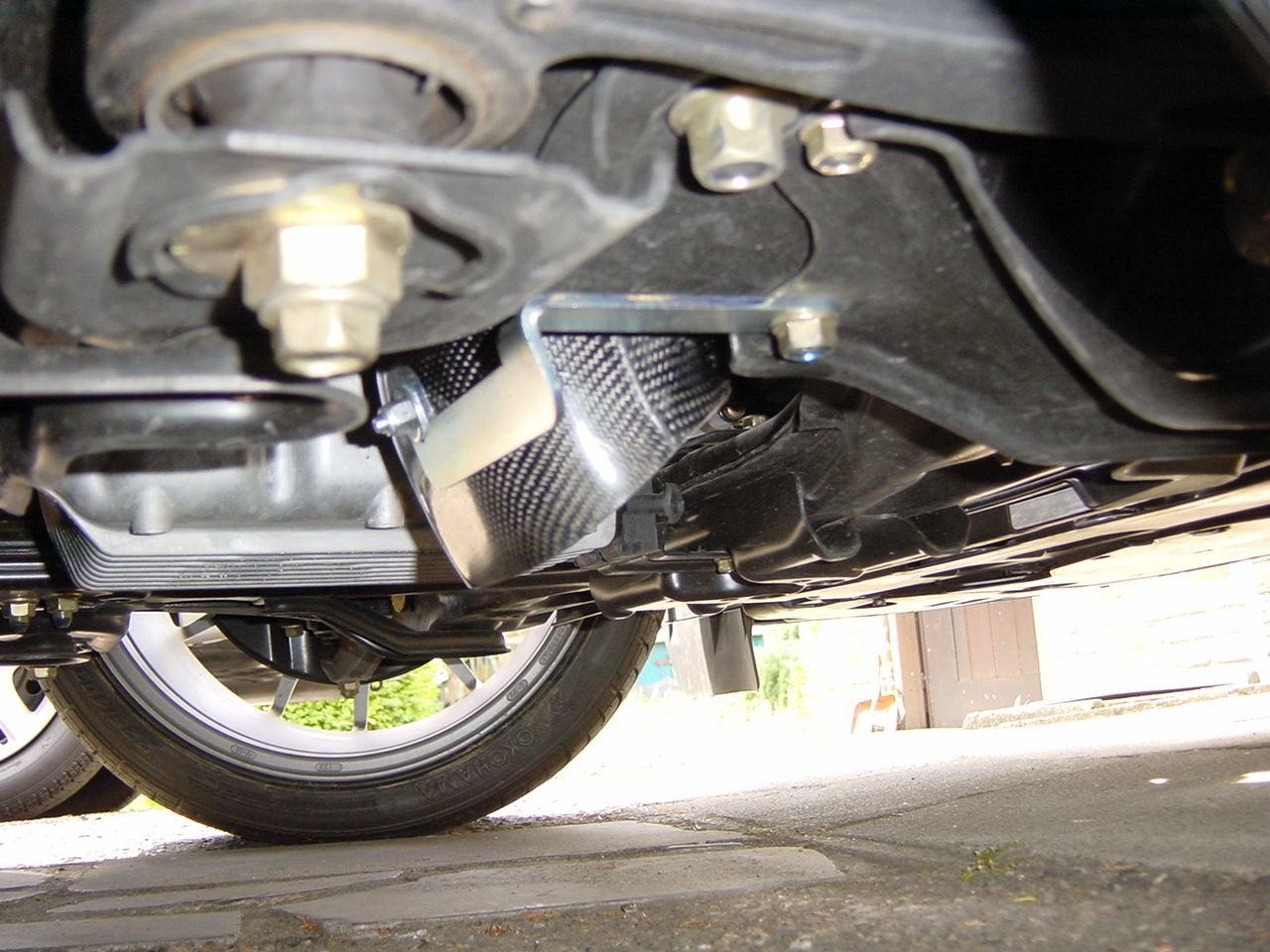

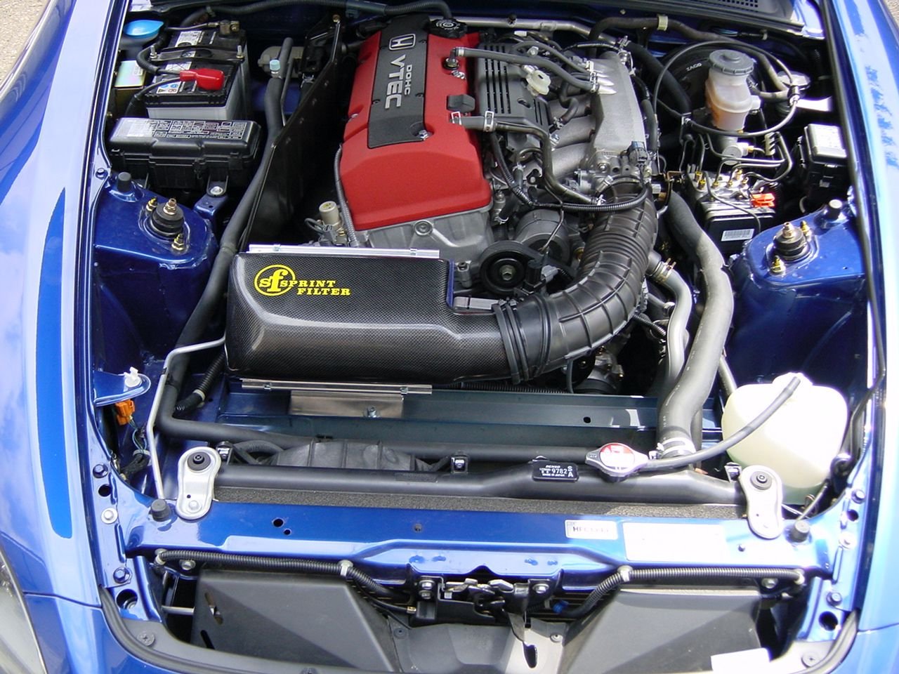

MG Racing carbon fiber intake -
here are some threads you can check into.
https://www.s2ki.com/forums/showthread.php?...?threadid=27700
https://www.s2ki.com/forums/showthread.php?...?threadid=14285
this is an awesome intake. they go for $600 new on mptuning.com
i have been looking for a used one for a while now but have yet to find one. this is the only intake i will consider. 6-7 dyno proven HP and 12 HP to the wheels at speed!!!
i have been talking to a carbon fiber manufacturer about making some intakes similar to this for a group buy. we will see if i can put it together. it is atleast a month away.
here are some pictures of the MG Racing intake
