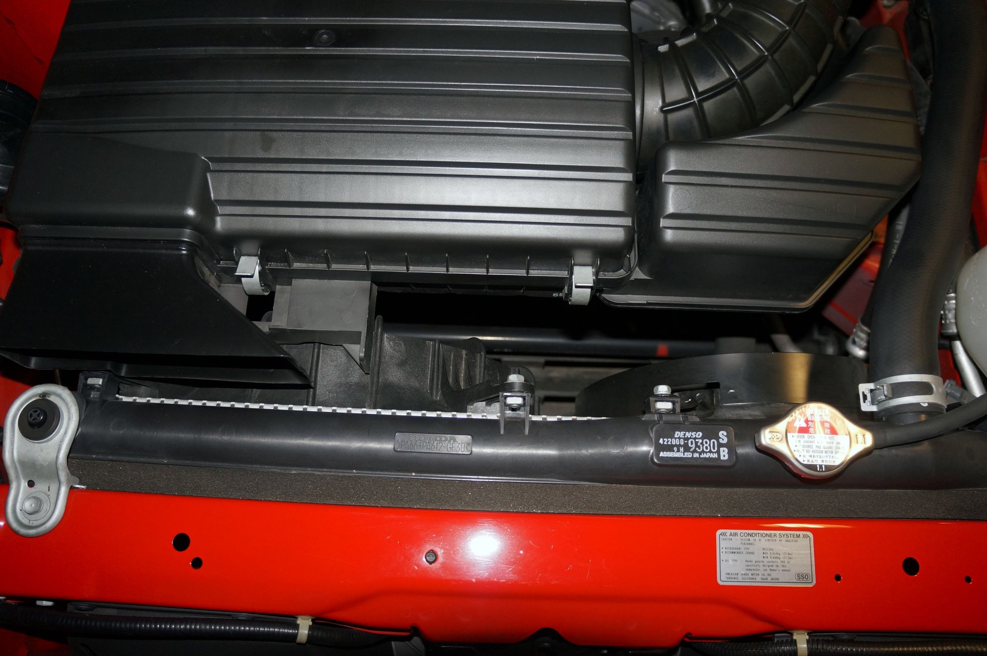

Wear a heat protection glove (I like the Makita workshop ones) and squeeze the upper return hose while at idle. It helps to free up trapped bubbles at the top of the system.
The long hose is on the right of the photo.
