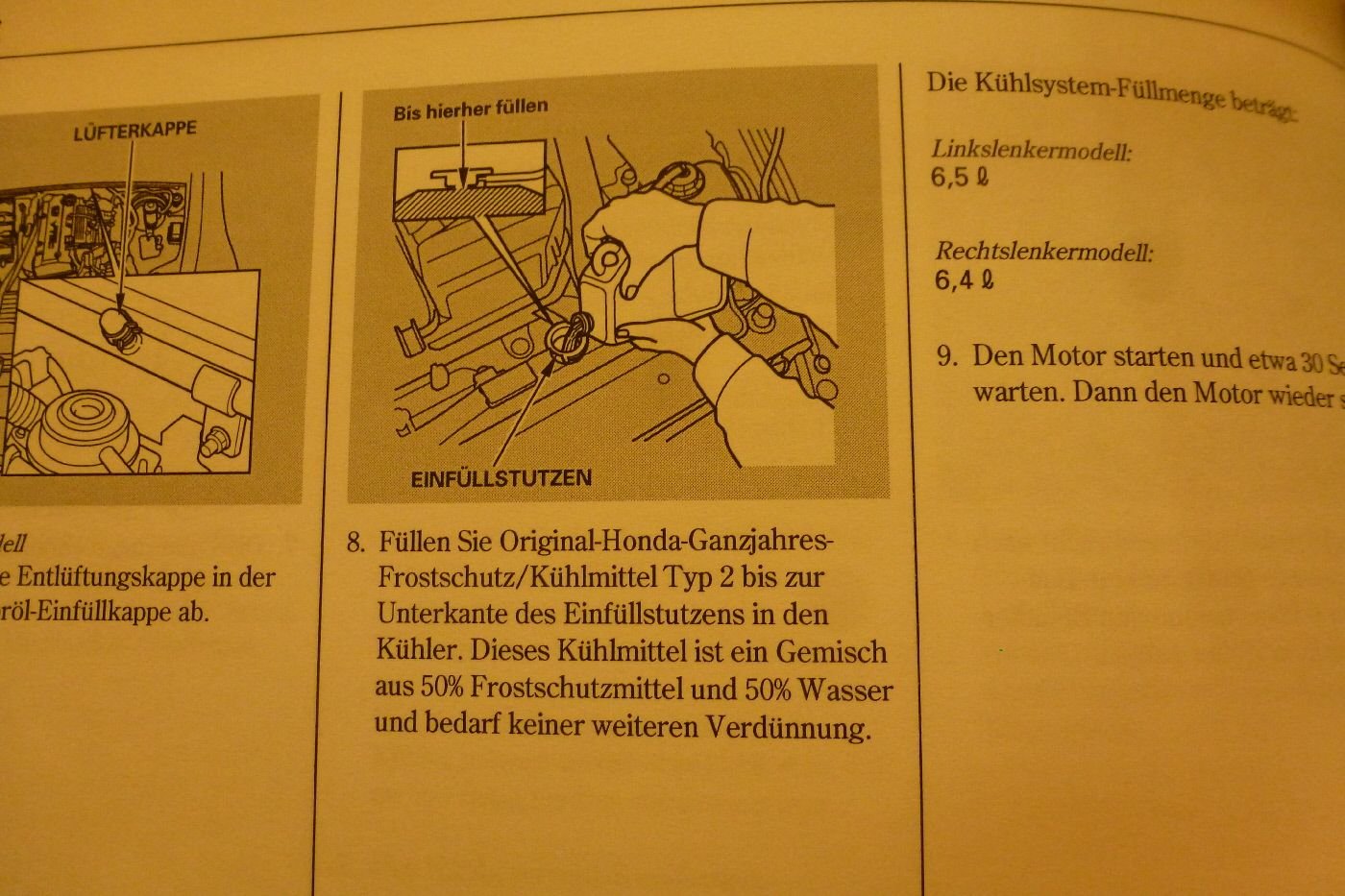

German owner manual. The only information you get is: Use Honda Type 2 coolant, it is a mixture of 50% antifreze and 50% water. (German: 50% Frostschutzmittel und 50% Wasser)
Thats all the lousy, useless information we get here. No ASTM Number, no hint about silicate, nothing. Zero. Same for the orignal honda germany workshop manual, at least for my del Sol. Exact the same useless information as in the owner manual. If you ask a Honda dealer here, he shrugs. Thast why i ( HAVE TO ) rely on the recommendation of reputable coolant manufaturers.

The label notes "Type 2" on both the front and back of the bottle. And it's blue. This is the genuine coolant made in Thailand (where Honda makes many motorcycles).
Even the German-language specifies Honda Type 2. Have to take your word it doesn't specify an emergency or temporary substitute. Just use Type 2.
