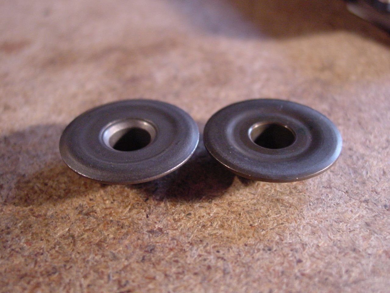

As per spitfire I'll keep it IC (internationally correct)
Any customer of mine that has cracked retainers gets F22 retainers on the intakes only. Maybe me too...goin to pull my cover.
F22 retainer on left, F20 retainer on right. The distinct visual difference is the angled margin. Note the F20 has no margin, just a sharp edge.
Here's a side pic. I won't even tell you guys which is which, because it is so obvious. The F22 retainer has substantial walls and is much stronger.
