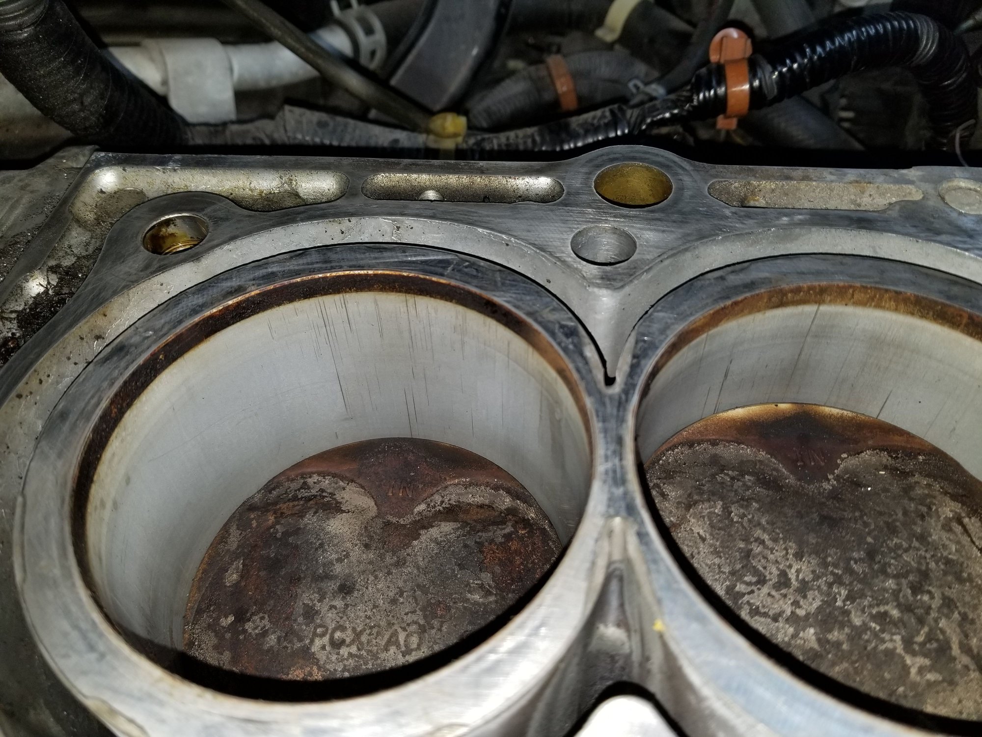

Posts: 56
What do you guys think of these cylinder walls? I can feel some with my finger nail but nothing crazy.
As long as it doesn’t catch a finger nail and doesn’t run the length of the cylinder you should be ok.

Posts: 56
Some of them got caught on my fingernail but wasnt much and none of them go all the way down. I am stuck on what i should do. Hearing rebuilding and sleeving the motor it may not last long as oem...
