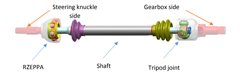

@ Jarvis: The topic of this thread here is clearly the failure of the inner (Differential side) tripod joints. Thats what alle the discussion is about. Nothing else. Some members here call them CV joints, some call them Tripods. If this is wrong or rigth.... i dont care.
However, if you really read all the valuable information here, you should understand it. And then there are pictures, too....
