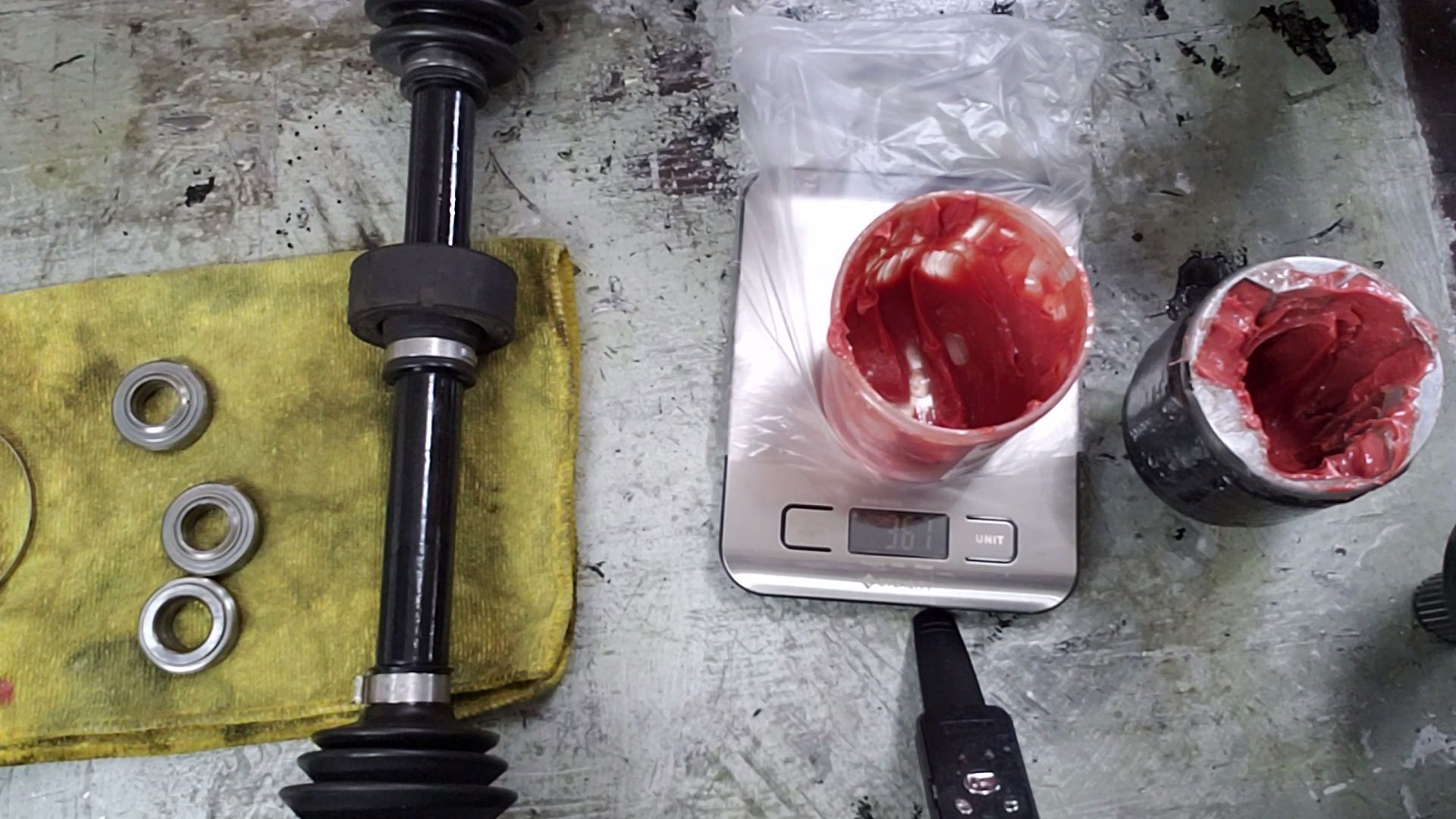

Too much grease will blow out the boot. Use a measuring device, you witch doctor scientists!
I use a food scale and put the tub of grease on it. When the tub weighs 5.x ounces less...the joint is full.
I fill virtually the entire volume into the cup side. that way, the grease for sure has to "submerge" all the moving parts.

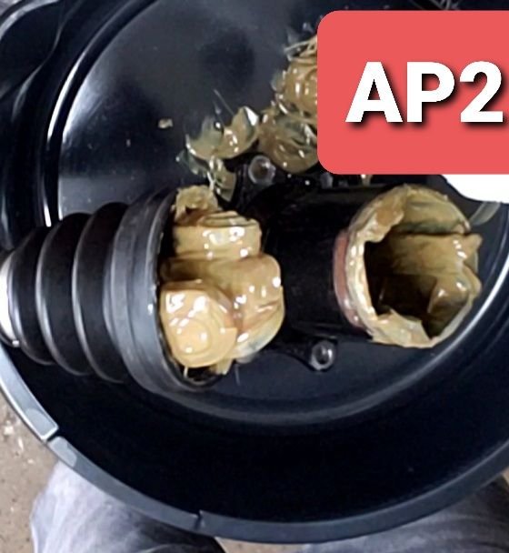

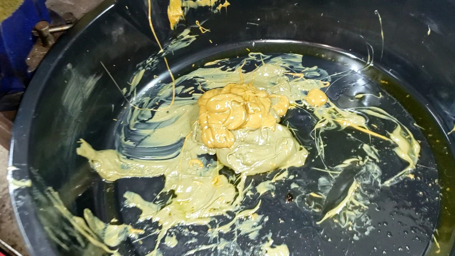

Also...AP1 grease is mustard yellow. AP2 (and other late model honda/acuras) have a greenish grease. Idk what this means. All 00-14 Hondas seem to have pitting issues. Not sure why.
Just did an AP1 AND AP2 rebuild this last weekend... AP1 grease on top. AP2 is the lower layer. FWIW, the AP1 is a JDM axle.
04+ TSX's also have the greenish grease.
