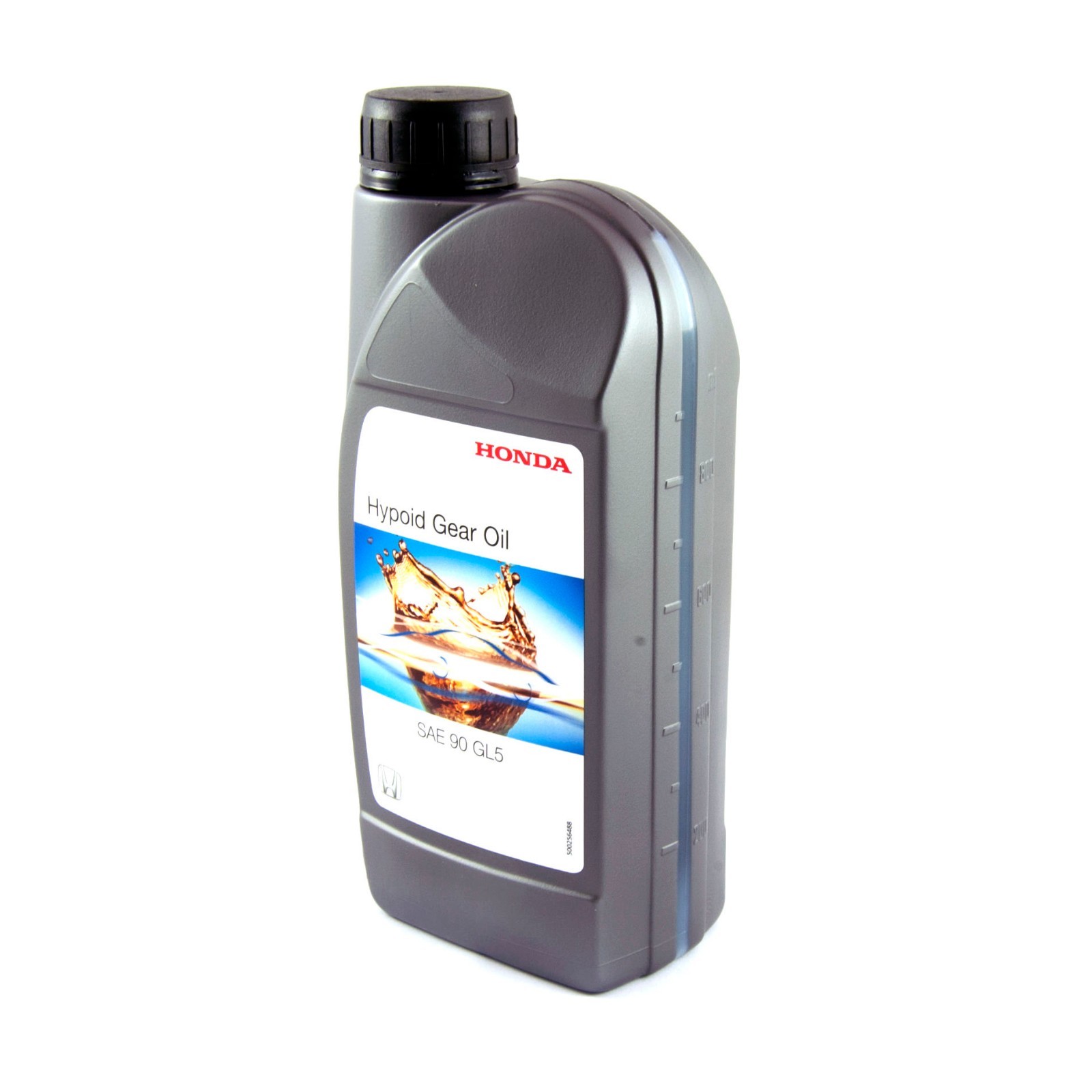

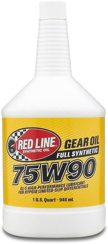

The little bottle pumps only have an intake tube long enough to reach the bottom of the standard kinda squat quart plastic bottle.
This type bottle should work with the standard little pump:
This bottle probably won't:
Ignore the bottle contents, that's another topic.
