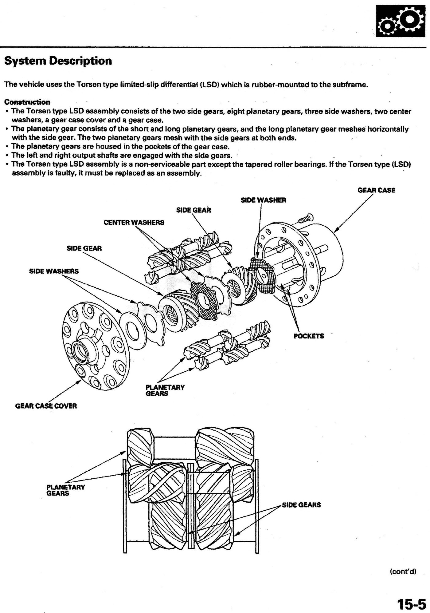

Originally Posted by RolanTHUNDER
There are no clutch plates in the S2000 Torsen diff as it is helical and not mechanical (clutch packs) or viscous (fluid dependent).
Here are the related pages from the workshop manual. It has "Clutch discs" and it relies on friction.

It relies on friction yes but not necessarily friction caused purely by the fluid like a viscous unit does and there is no mention of "clutch discs" in that manual.

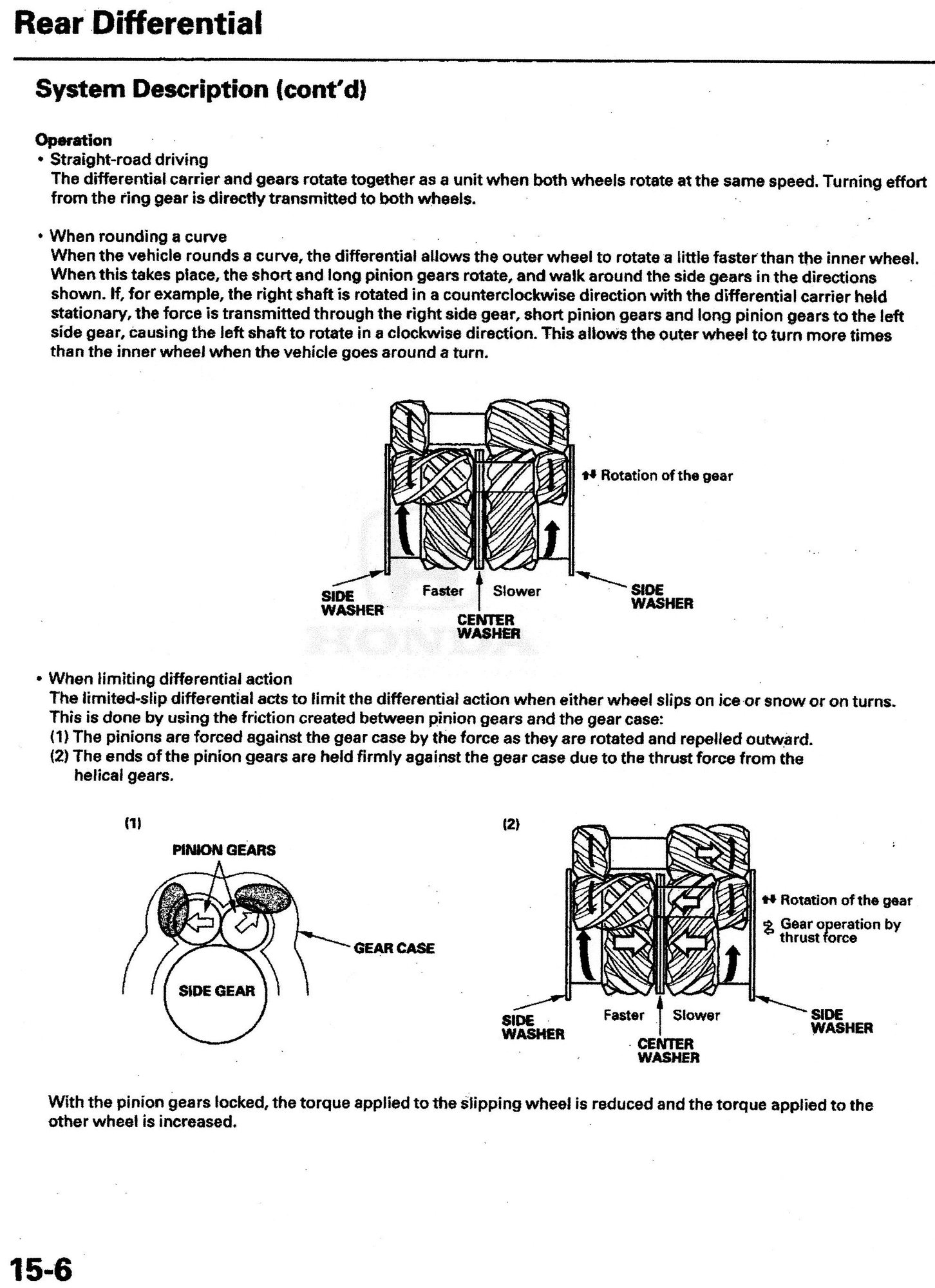

@ Rolan Thunder. Clutch disc, Friction Disc, Washer, how ever you call them, they are there. And to me they are very similar in form and function to a motorcycle clutch.
And in a motorcycle, the type of oil used could make a huge difference. Use the wrong oil and the clutch slips....
@ All: So, i am still puzzled what a difference a LS gear oil could make and if it is safe to use it in the S2000 Differential?
It is mentioned here in the thread that sometiems the tabs of the clutch or friction discs are sheared off and come out the next fluid change.
Could this be caused by using a LS Diff fluid, creating to much friction on the clutch or friction disc and cause them to shear off?

Yes it is absolutely fine to use an LS diff oil in a diff that doesn't require it, the only real difference is friction modifier. I doubt you would notice any difference in the way the diff behaves if I am honest.
