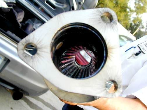

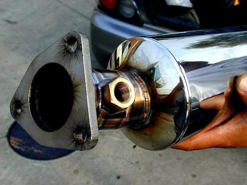

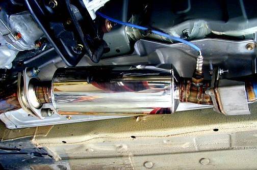

Ask and you shall recieve, well partially from me...
Here is my old pictures that you were searching for.
stock catalytic converter inside
Pinky, I have my serious doubt that the Spoon or any other straight pipes for that matter would be any better than BYS one.

The BYS looks interesting. Indeed, the Spoon is a straight pipe that probably is lighter than BYS and -might- flow better due to normal pipe wall versus resonator type construction of the BYS with perforations in the wall.
The bung for the O2 sensor of the Spoon is facing down which makes slight rerouting of the lead necessary to get adequate lead length, and makes 'offroading' or going over rocks a slight concern with more O2 sensor exposure.
