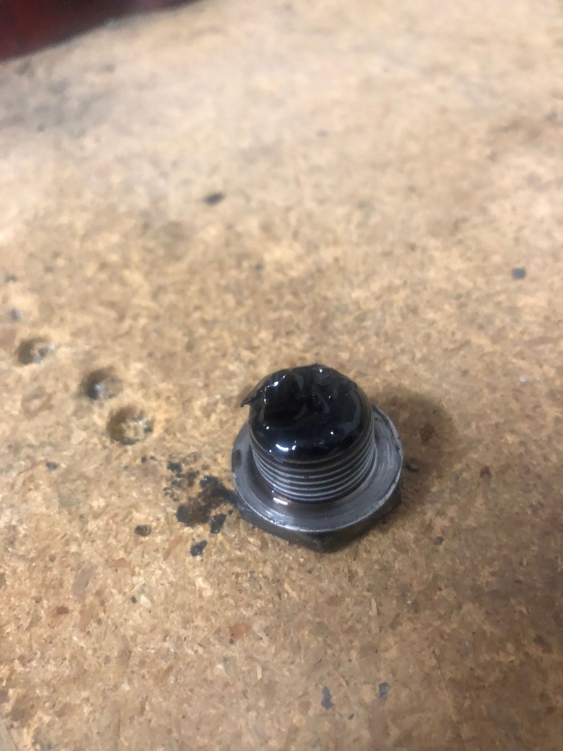

Drained the fluid. Looks like my diff turned itself into a blender.
Rebuild, replace with ap1 or replace with ap2? Or upgrade?

Honda has a SAE90 GL5 diff fluid, they also have a lot of other fluids.
If you use the wrong ones which seems to have happened a few times then yes the diff will take damage, but the correct one is perfectly fine to use.
For the OP, I would put some new fluid in there and see how it works, maybe drain in after some short use and see if more stuff comes out.
The black smudge on the magnet doesn't look that bad but those loose metal parts does raise more concern.
Hopefully some expert here might have an idea where they might have come from.

Those bits look like they came from the outer diameter of the ring gear.
AFAIK the pinion doesn't have the fillet / rounded edges.
So that's not good.
The pinion is most likely damaged too.
The fact it didn't go BOOM means the damage is still relatively small but I don't think you can trust it anymore (I wouldn't)
Are there any other bigger metal parts and are they softer, malleable metal and not black / brittle?
IMO this diff is done, sorry.

Pulled it apart.. shes done! Time for a new diff.
