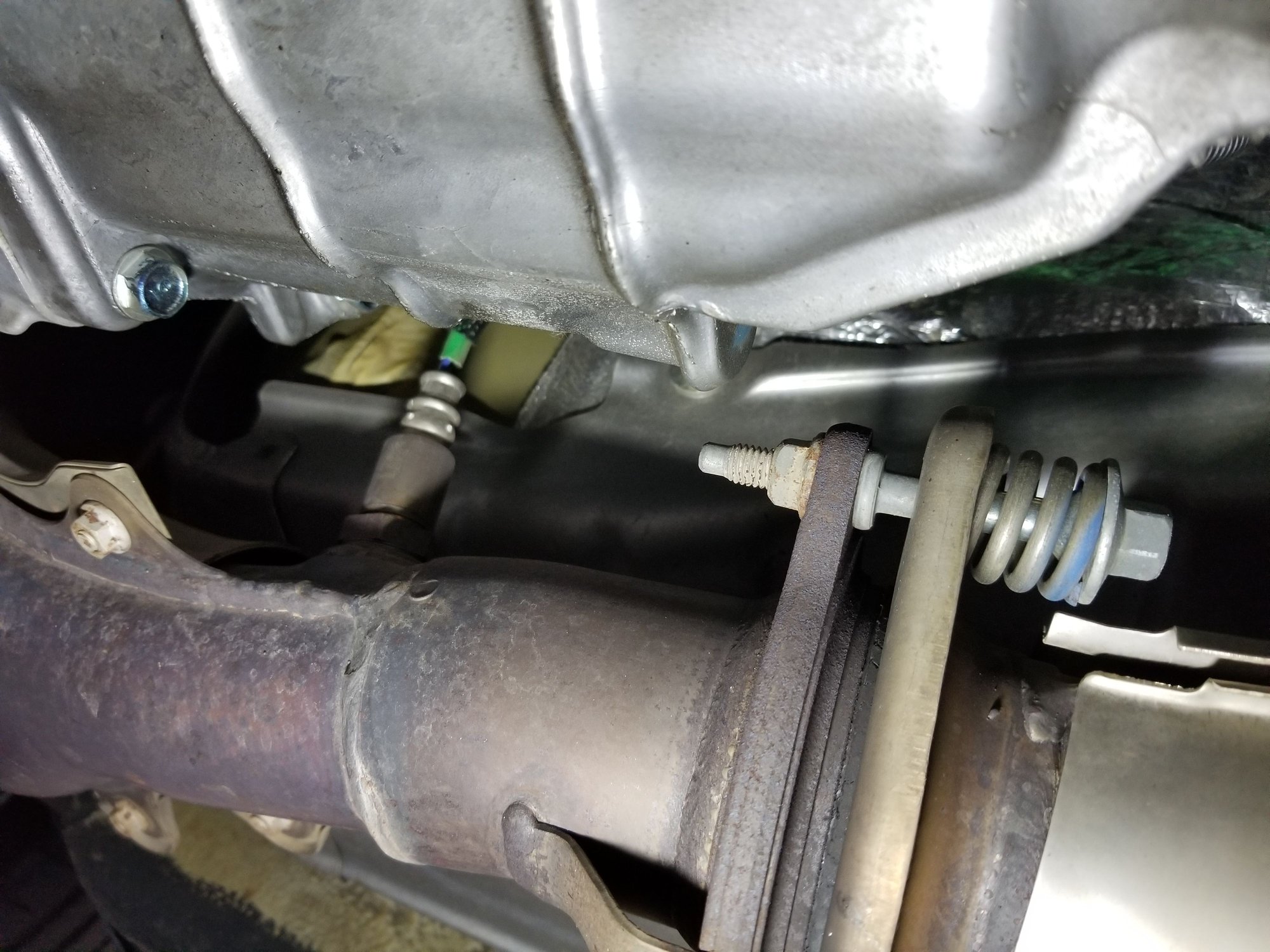

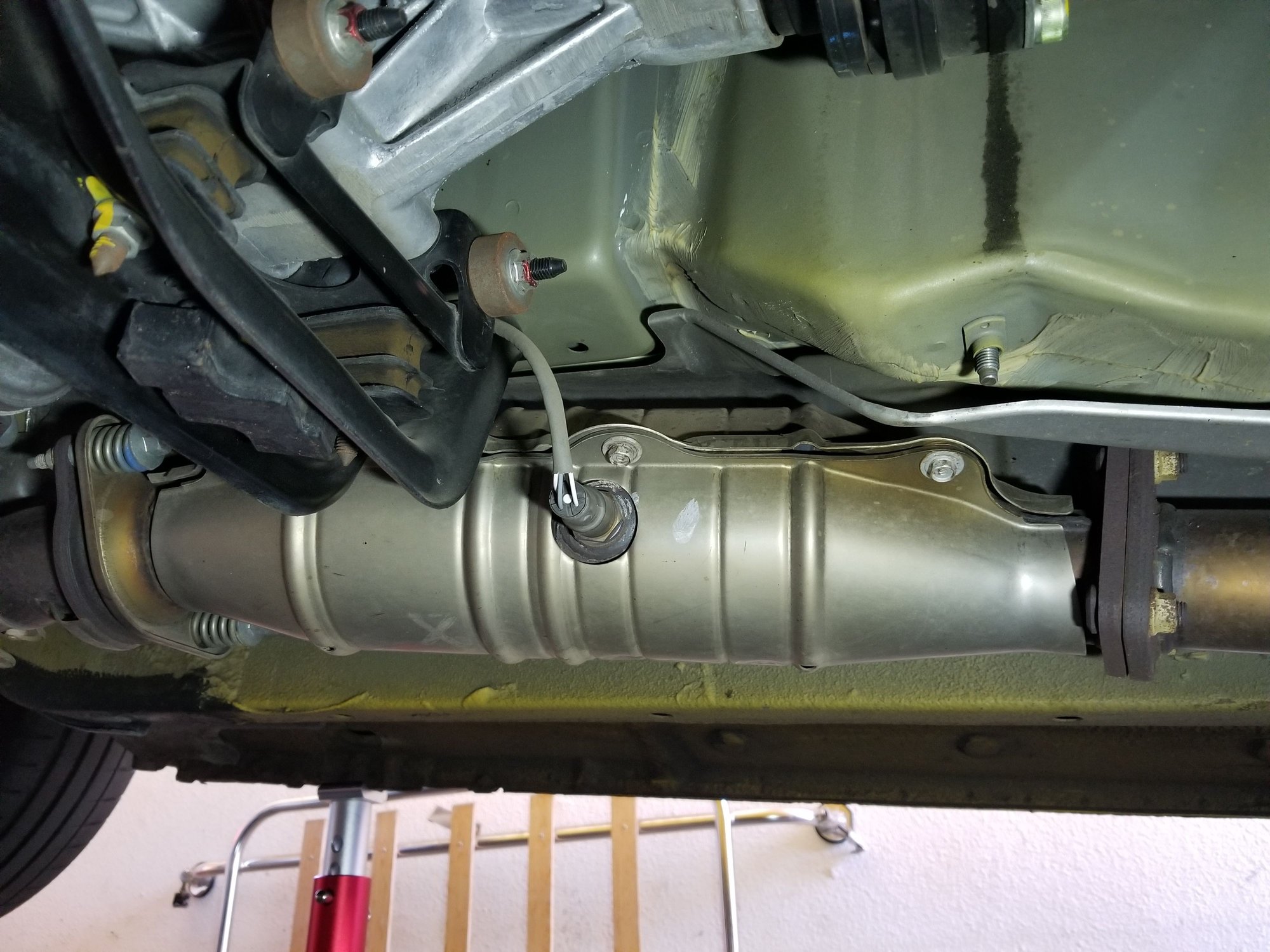

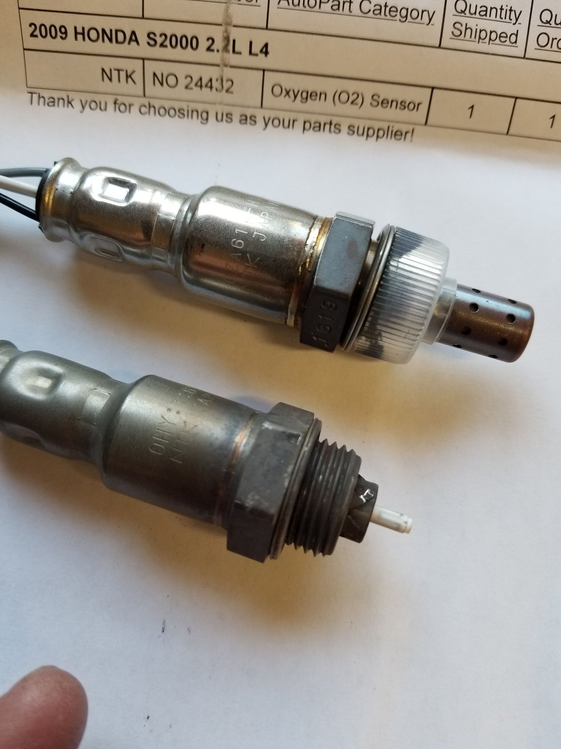

FedEx dropped of the package today. I spent the extra $6 for them as the Post Office will destroy it and keep it for a week longer. The NTK appears to be identical to the OEM one. It has the clips pre-attached and a plastic cover to protect the anti-seize from smearing until installation.
As I carefully removed the sensor, I heard a clink as something fell off inside the CAT. Sure enough, only part of the core of the sensor probe was intact. You can compare the new and the old. I took a peek in the CAT and there was the honeycomb with the indentation of the probe. My fingers were too fat to fit the hole but my pinkie was and I was able to easily slide the comb forward out of the way. Of course that means it will be easy for it to slide forward again.
I am looking to remove the CAT and see if I cannot find a way to lock the front honeycomb in position as well as remove the pieces of the damaged sensor. The manual says I should replace the fore and aft gaskets as well as the bolts that go through the front springs and locking nuts. Same for the rear. Have to stop by our friendly dealer and pick them up on Monday.
Last week I came across the thread that a guy used a C clamp to dent the CAT in a few places to keep things locked down. What a great idea. I like that better than screws. However, for the life of me I cannot find it again.
I also wonder if some piece of metal placed inside between the two pieces of honeycomb would work. Maybe some JB Weld to keep it in place. Not sure how the high temps would do for JB however.

I know there is honeycomb fore and aft with a uniform space for the sensor. I stuck a remote camera in there and looked around. The surfaces of the honeycomb, fore and aft facing the space are perfectly flat. I could not get the camera to see exactly straight down.
I am getting a spacer and will install the new sensor and see if I get a rattle from the small parts that fell off the failed sensor. I suspect you are correct in saying the smog (next year for me) inspection will not see it and flag it. I know a shop and the owner well to do that.
If a rattle does rear it's head, I will have to remove the converter and empty the parts out. I tried to get in there today but the parts are not magnetic and I could not get my small parts gripper to latch on. I was blind. I have dental inspection mirrors and they won't even fit the opening. If I remove it I will do as you suggest to make some dimples.
