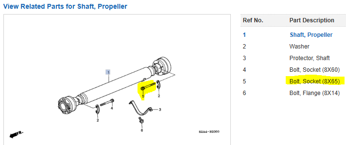

OEM bolts are 8x60mm and 8x65mm for the AP1.
I have a specialty bolt shop nearby that stocks a high grade metric 12.9 grade black socket head cap (allen head) bolts. My honda dealer does not stock these bolts.
The shop has a 8x60mm, so that's covered.
But I can't find a 8x65mm...
will a 8x70mm bolt be ok instead...or does it need to be 65mm exactly??? If it's 5mm to long, will it damage anything?

most people I know get the belmetrics with the 12pt head if switching to something other than OEM. They are 60mm and 65mm lengths. 65 for the diff end, 60 for the trans end.
BTP8X65BLK for one end
BTP8X60BLK for the other

A bolt that is 5mm too long may hit the diff. So...I wouldn't do that.
The 12pt ones do work. The ability to use an external drive with a 12pt is an advantage. But unfortunately, they are black oxide coated which will rust quickly.
FWIW, the ideal fastener is a C10.9 with zinc plating or C10.9 or 12.9 with galvanizing.
Belmetric has C12.9 galvanized (flake coating) in the right sizing. Enjoy your new bolts.
