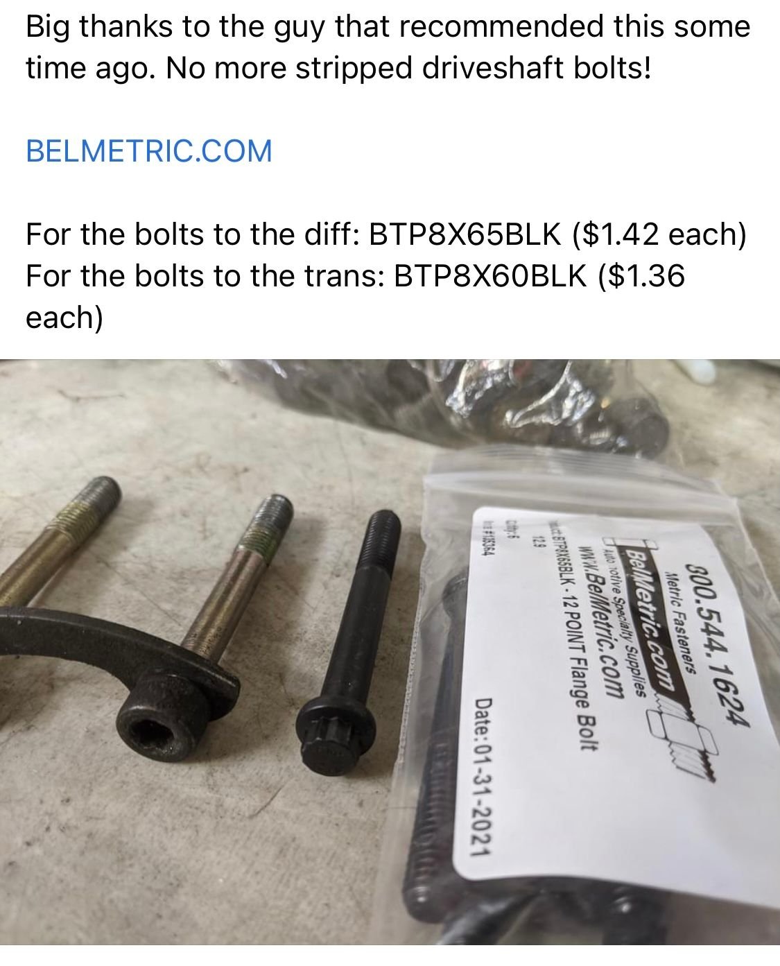

For those who don’t have Facebook. These were recommended cheaper options bolts for the AP1 driveshaft.

Not big on any aftermarket bolts.
Except for these
Part numbers seem to designate exact oem lengths (60mm and 65mm)
Looks like a great alternative! AP1 2000-2003 only here.
2004-2009 are a larger hex drive and typically not a problem.

Nice find! IMO the only thing that makes the AP1 bolts prone to strip is the wrong tool being used. I'm convinced by the ease I had removing and installing AP1 bolts Gearwrench part number 81034 and MATCO P/N: AXYS6M are the ideal tools to remove AP1 bolts. Those two fit right in between the prop shaft and the CV joint, and the hex socket sits nice and flush with the bolt. The ratchet is 1/4" for excellent feel and has a 9" long handle to give you plenty of leverage.

I've had no issue removing and reinstalling the AP1 bolts, but a lot of cars I see end up already being mangled. These are an awesome find for those people & funny enough are what LHT has been using for awhile without telling anybody...

Any advantages for AP2 to run such aftermarket bolts? AP2 uses BOLT, SOCKET 10X62, 12 pcs in total. 6 pcs on both ends, same part number.

It's harder to strip ap2 bolts. But if you use the right tool both bolt types are easy to work with.

AP2 bolts are great, no need to change.

The LHT bolts are still socket cap bolts like OEM. I’d say the closest replacement can be found through McMaster. Should just be regular depth.
60mm: https://www.mcmaster.com/products/sc...d-type~socket/
65mm: https://www.mcmaster.com/products/sc.../length~65-mm/
