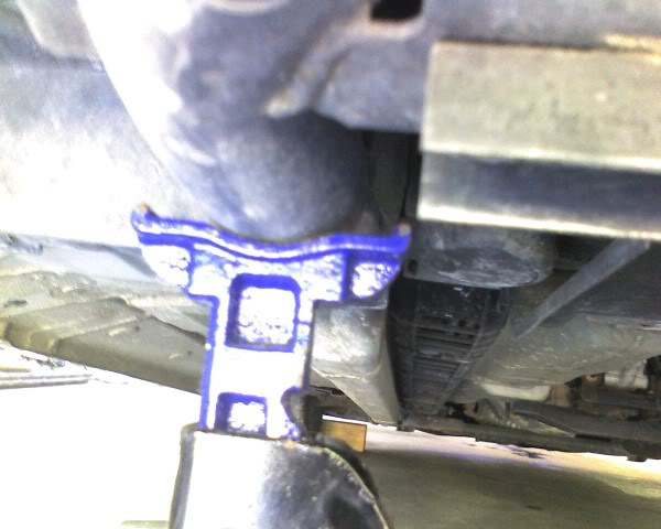

3rd
Place a jackstand on each side of the vehicle, I used these spots...
