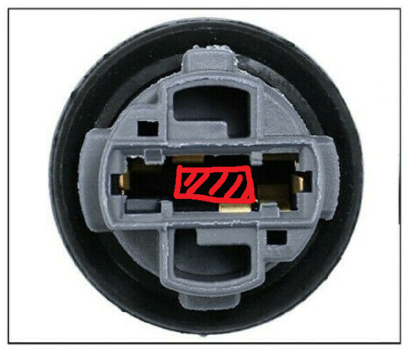

Case: I was fiddling around with my reverse light bulbs and put bulb that was too small into the socket (Fig 1).
Fig 1.
Note. I'm an idiot.
I turned the key to ignition, gear is in reverse, and my instrumental panel lights go out.

Check all the fuses. You can test them in place, as there are probe windows on top side of fuse.
The fuse sequence numbering in the service manual vs owners manual is reversed. This makes it challenging when you look something up and it says, say, fuse #9, which fuse is that really? When you have a perplexing issue, just check them all. Again, can be done without removing fuses.

Fuse 42 under the hood (40 amp)
