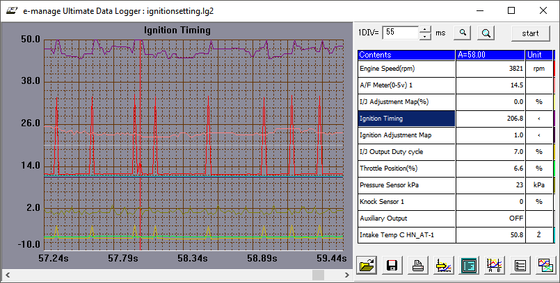

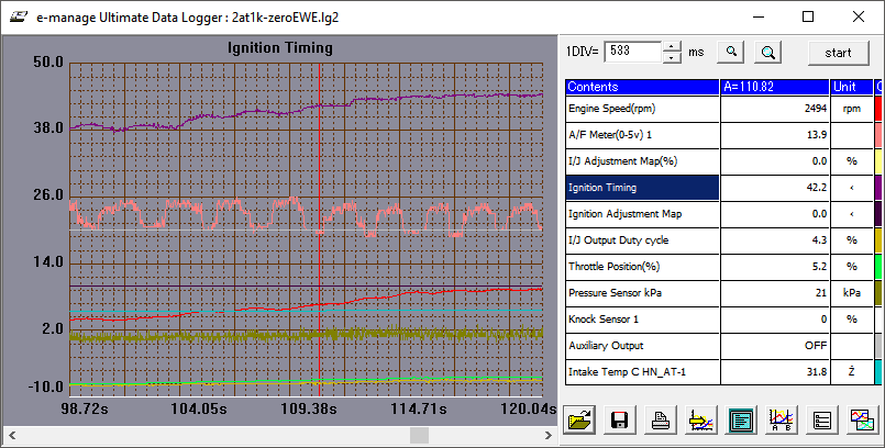

Timing IssueI deliberately set the "RPM signal type" to ignition signal to show more clearly, If I set the ignition tables to anything other than zero I get misfires. Is my EMU unit bad? Is there something else going on? This ignition map I set the whole range to 1 degree advance, if I set it to zero I have no issues. The below picture shows a map with 2* at 1k. It does misfire a little below 2k RPM as timing is being added all the way up to 2k.
Zero above 1k RPM
