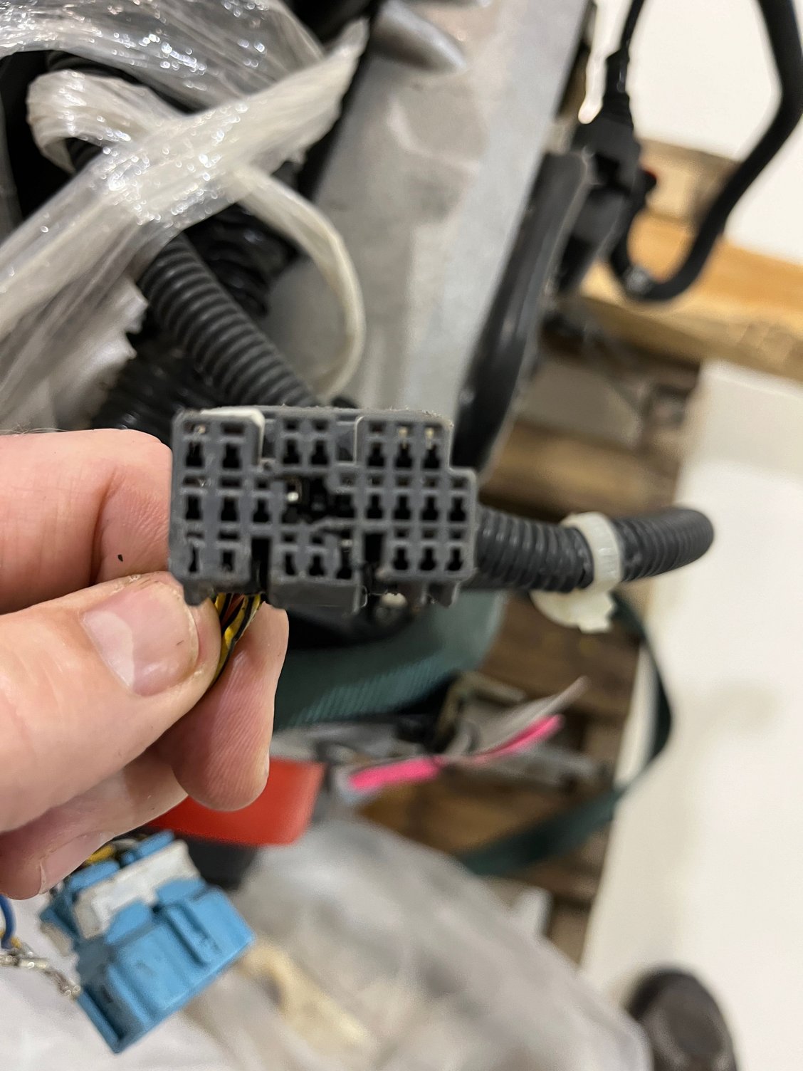

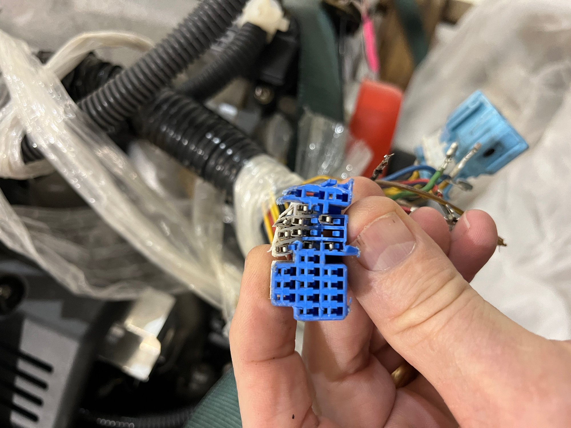

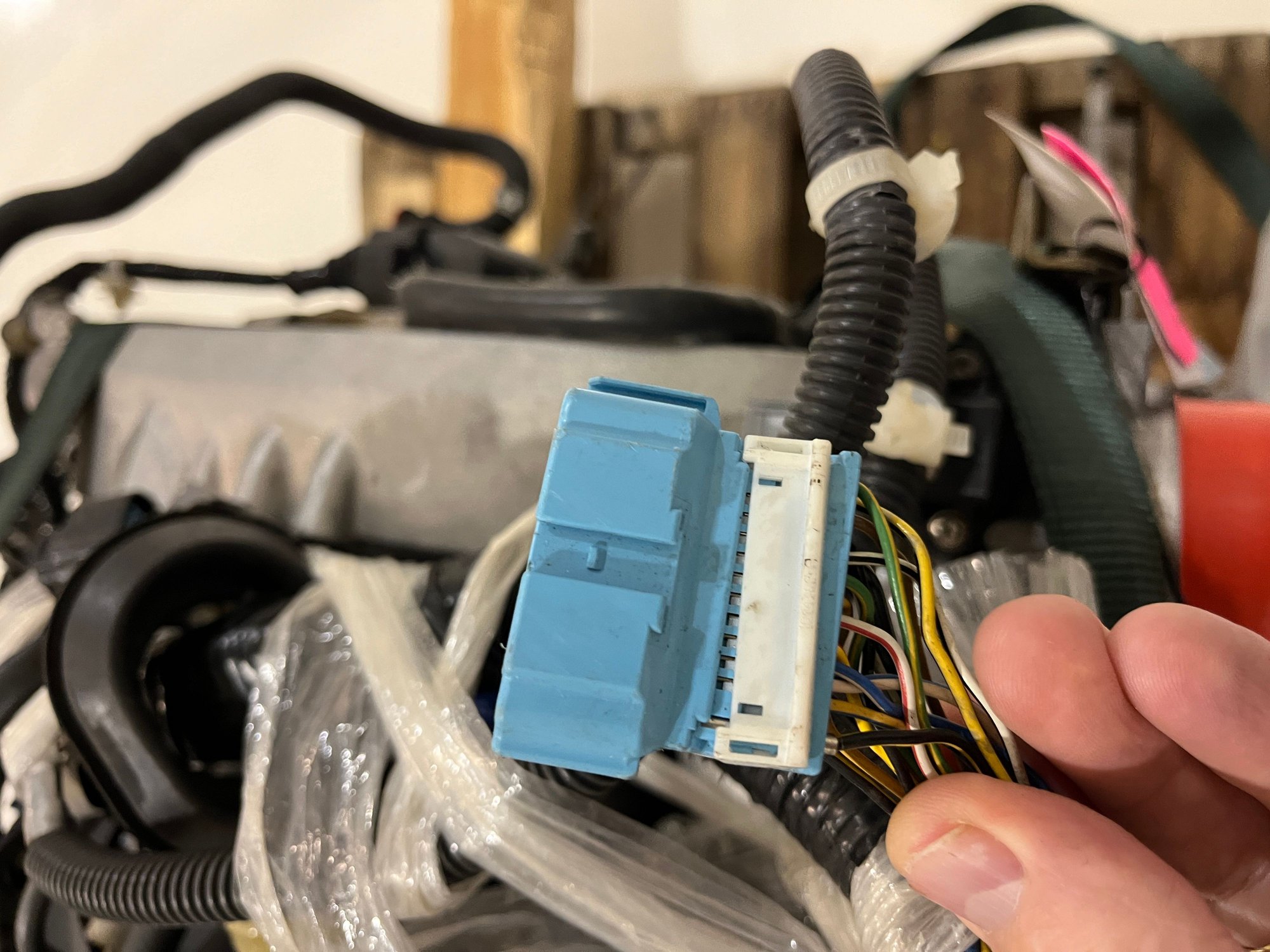

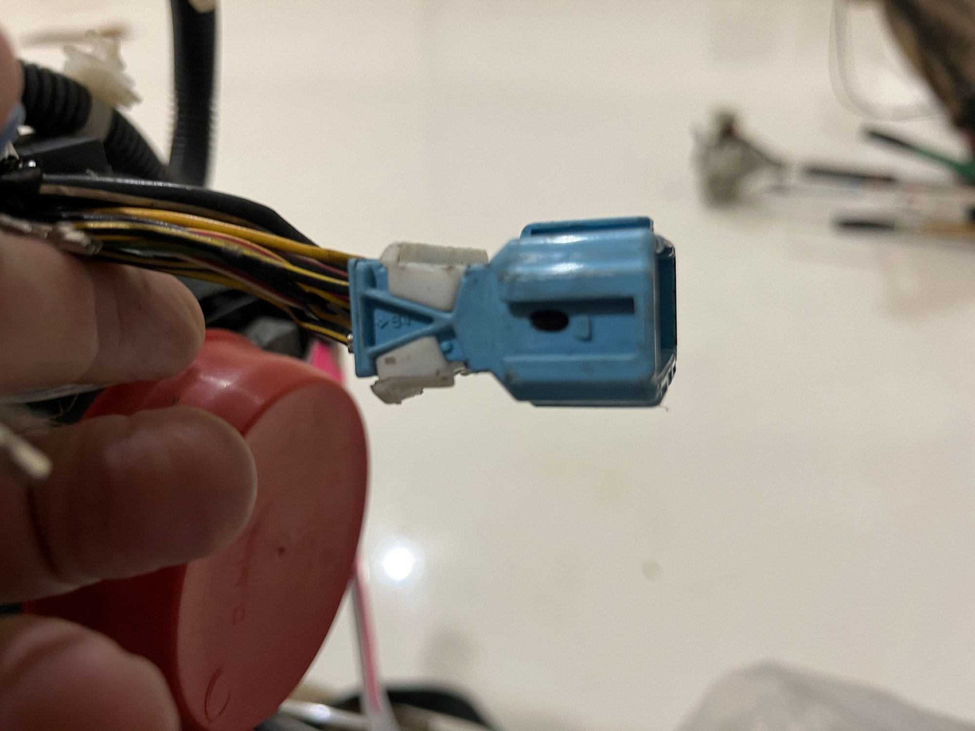

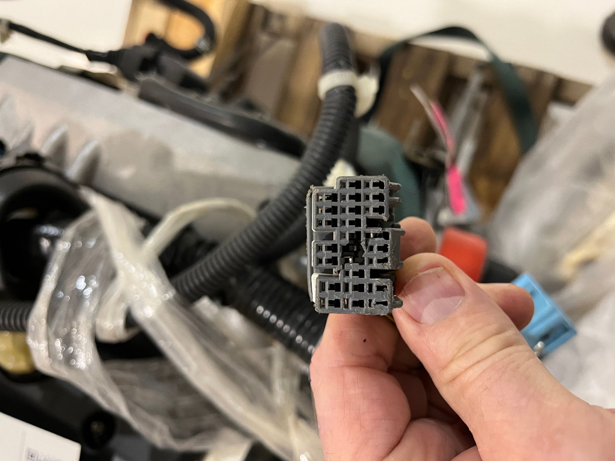

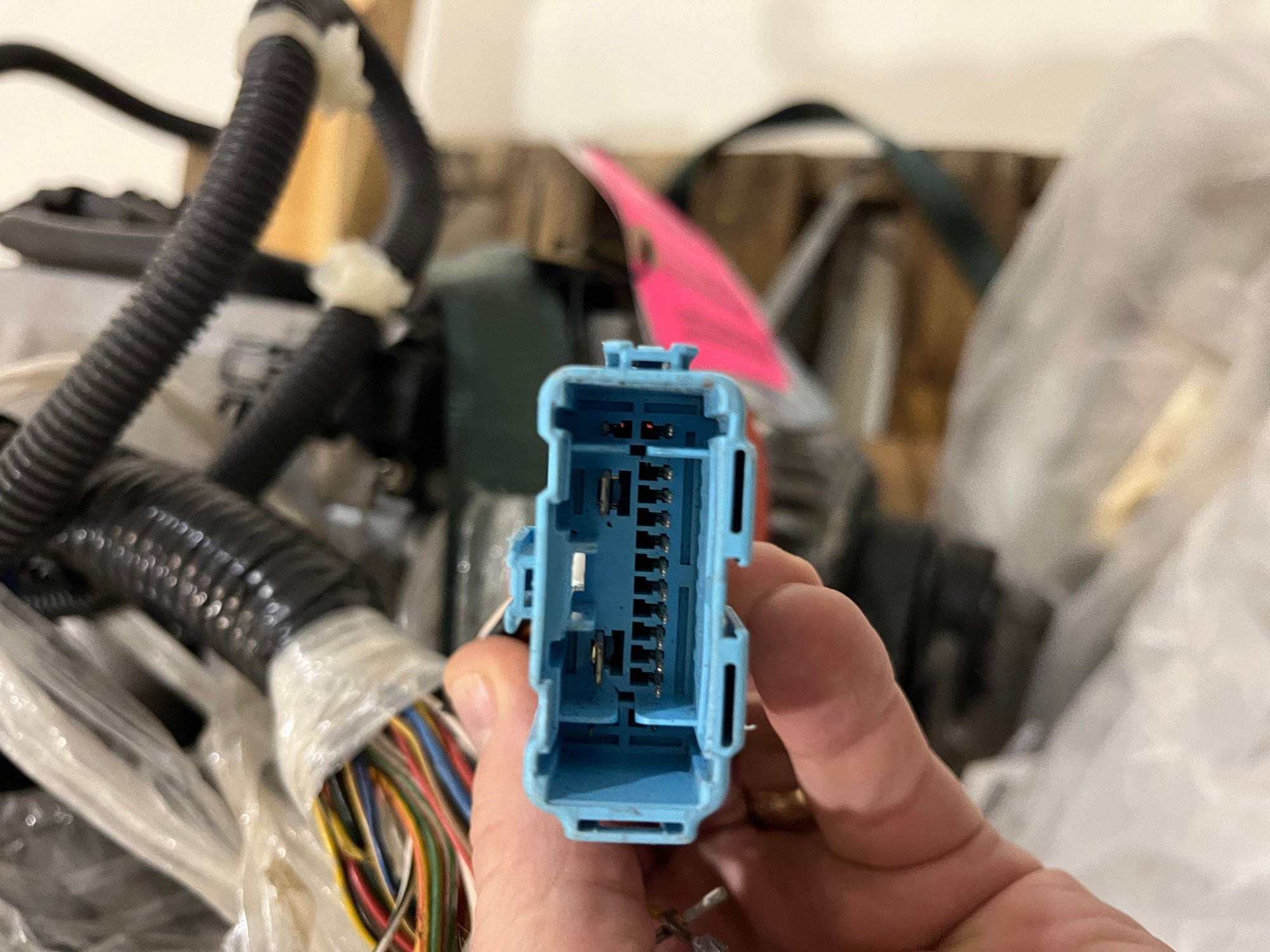

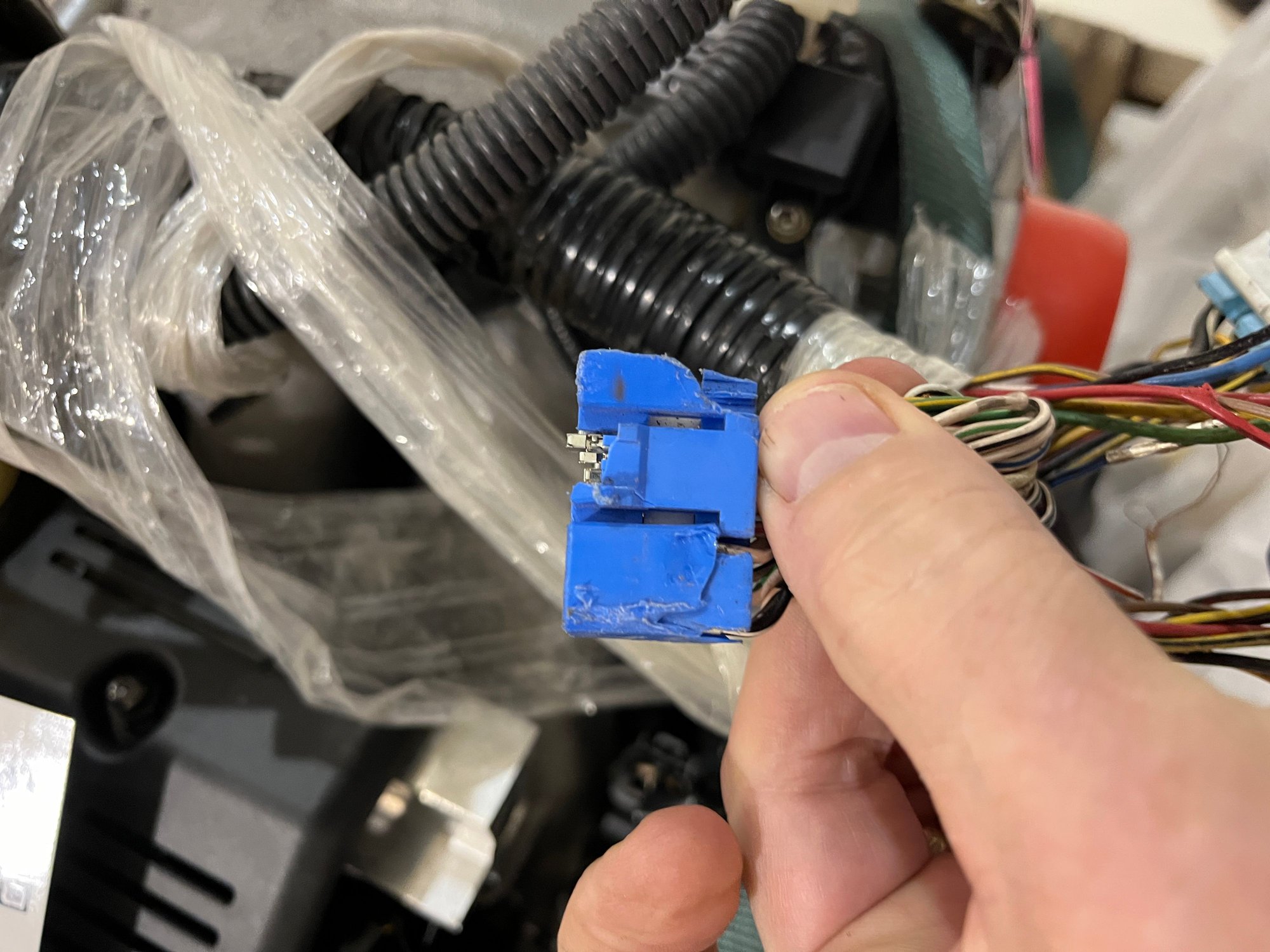

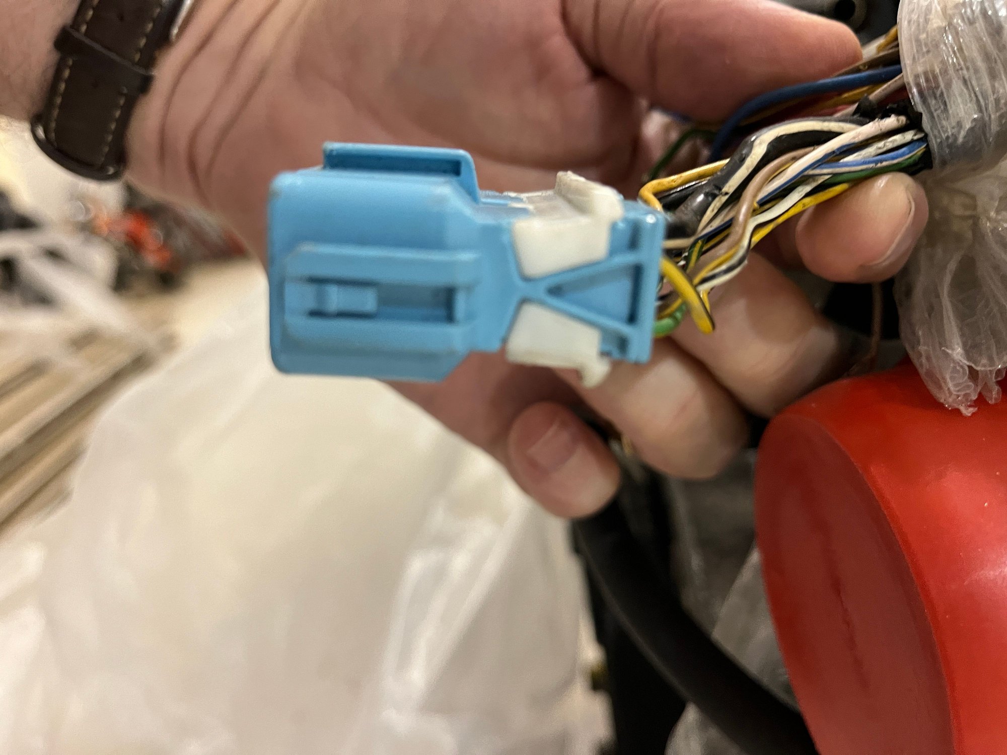

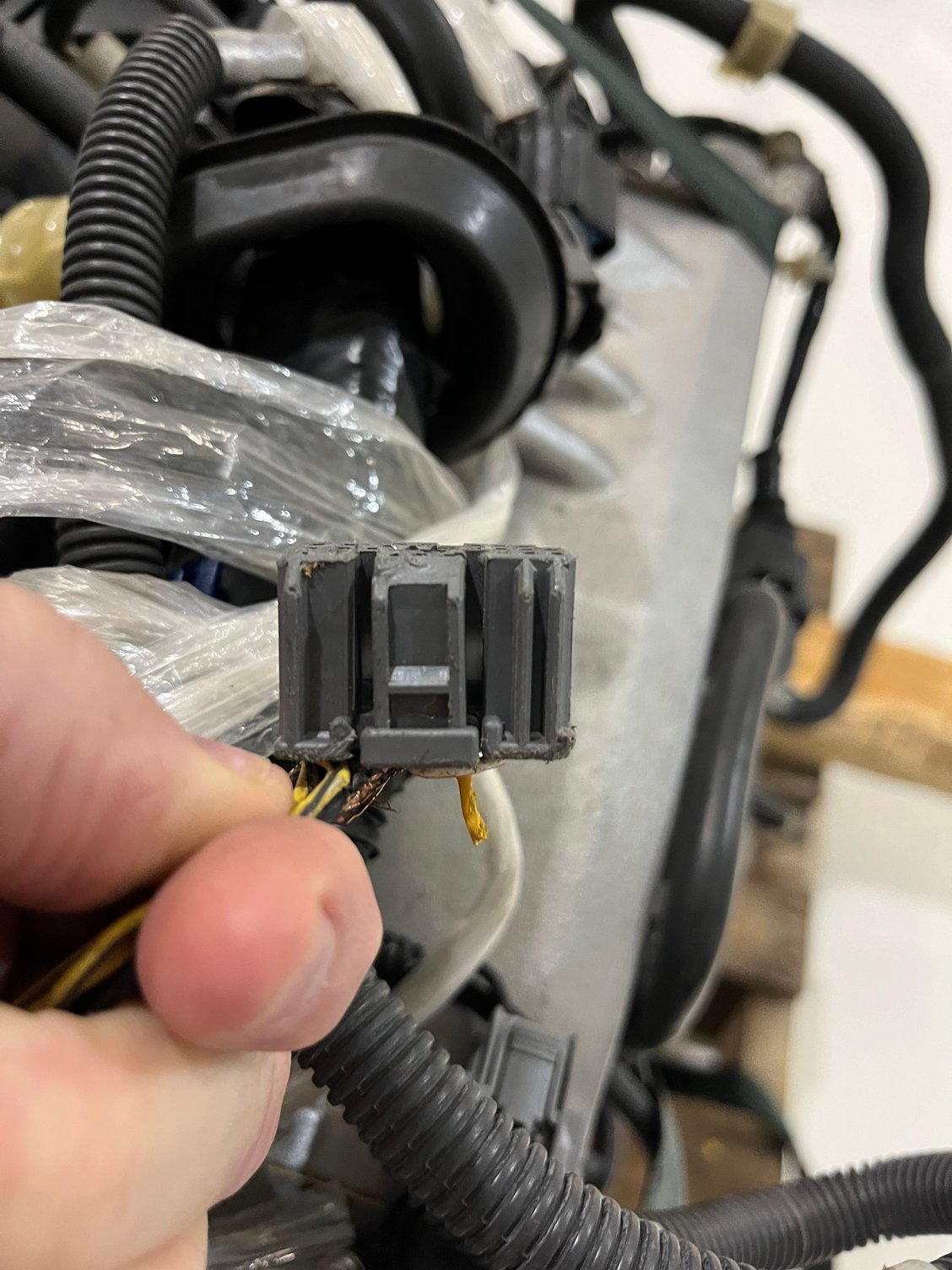

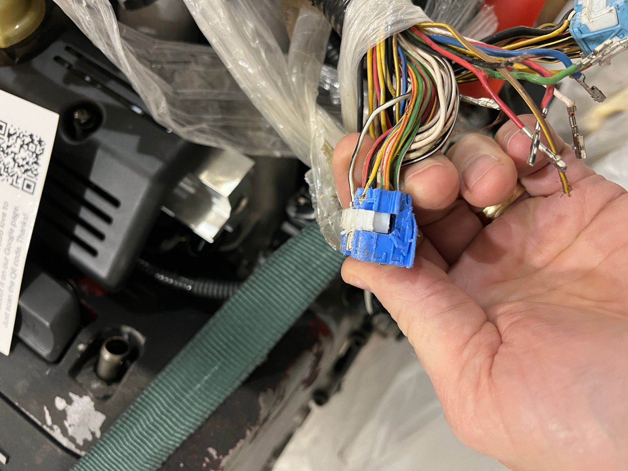

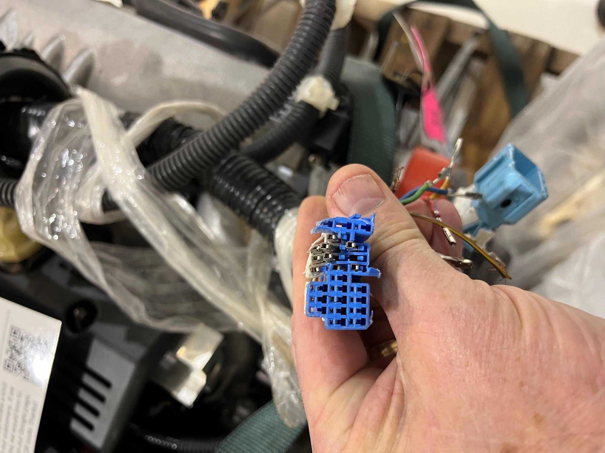

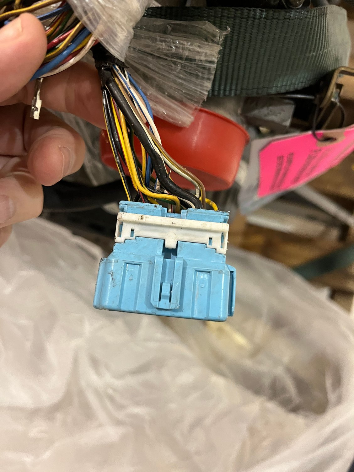

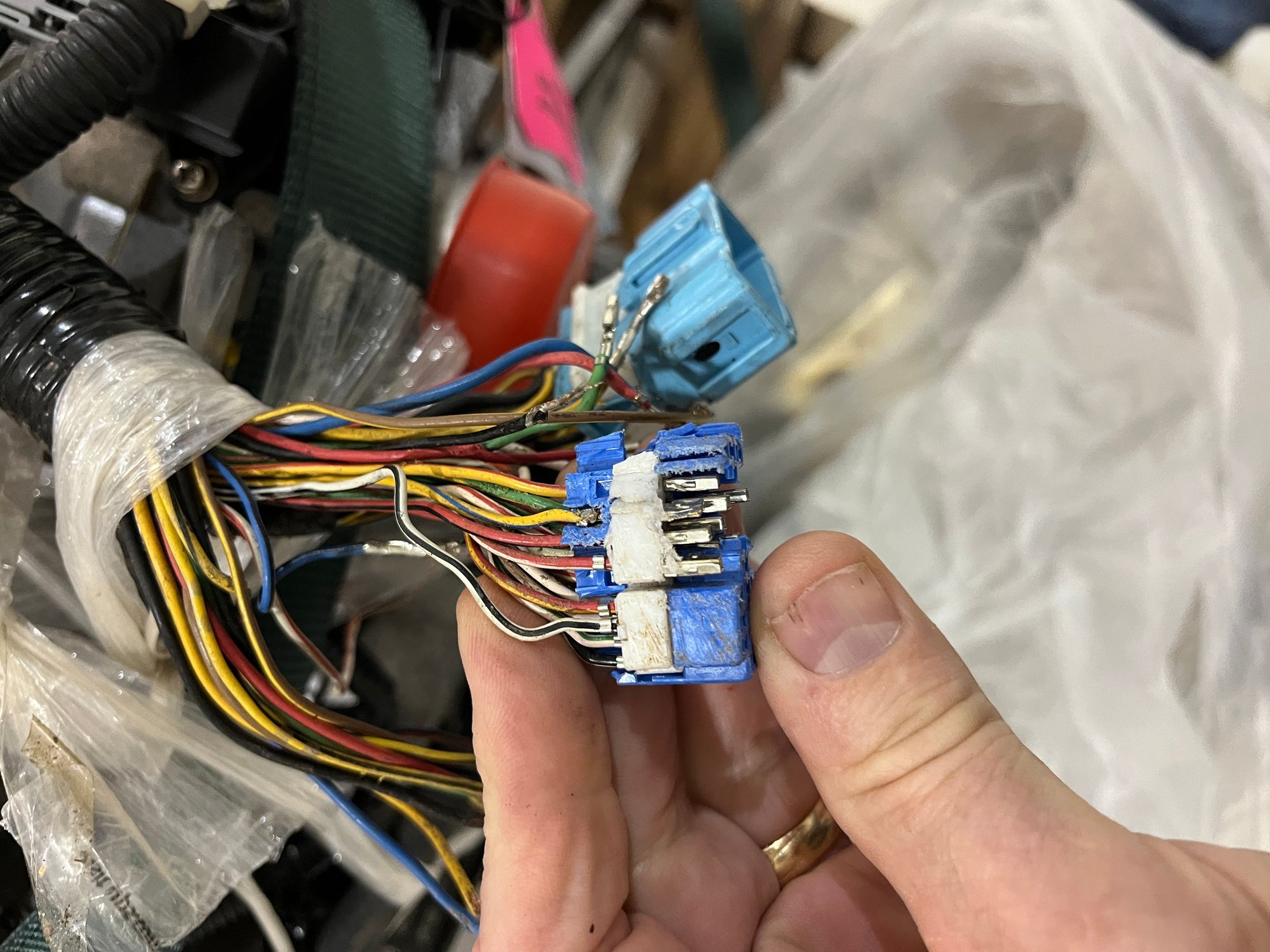

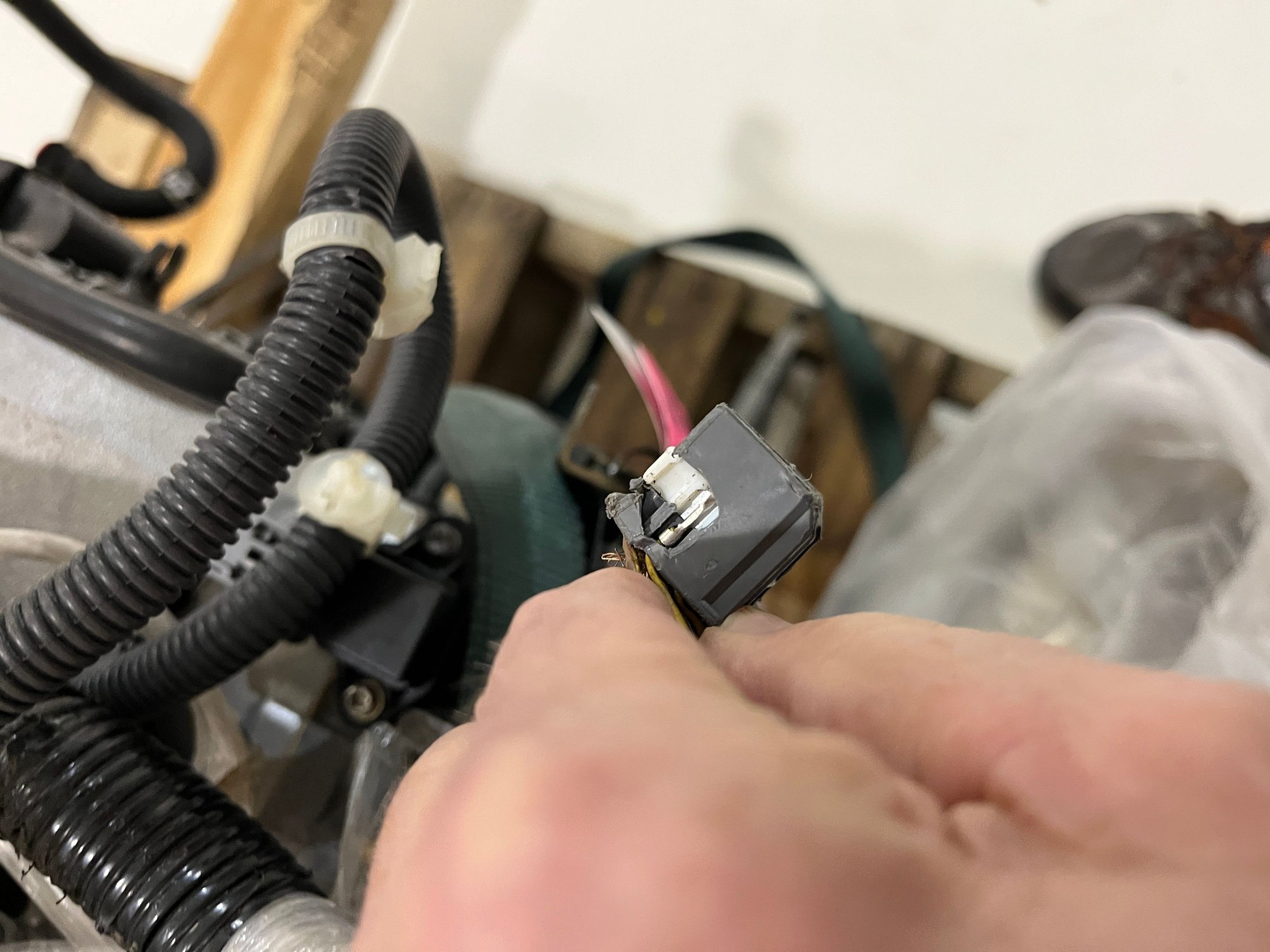

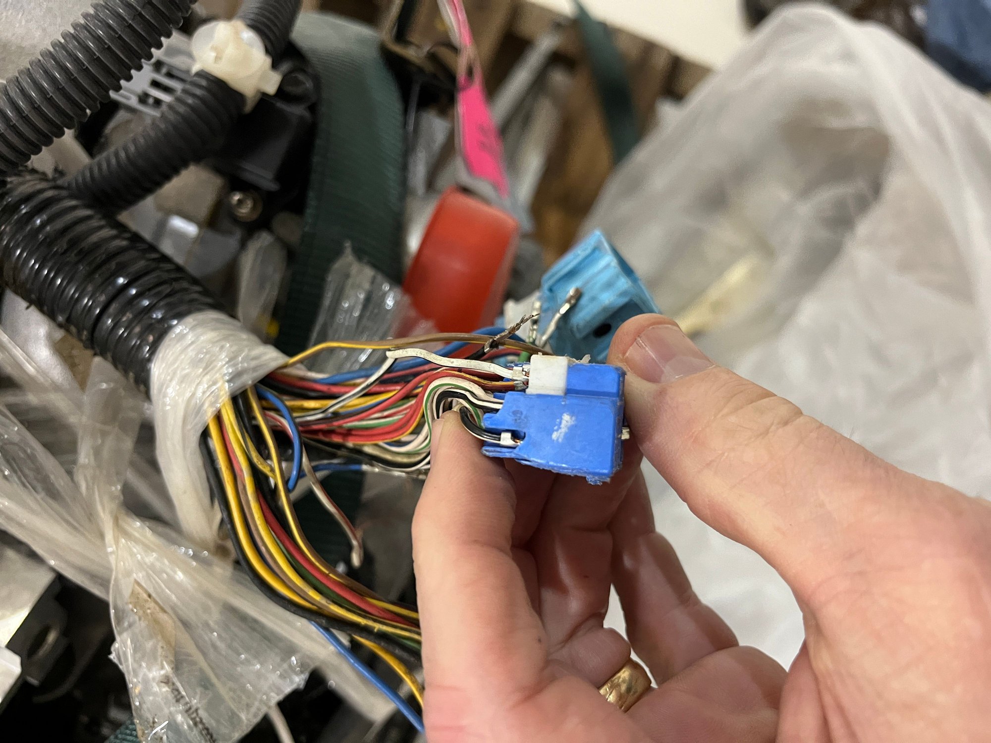

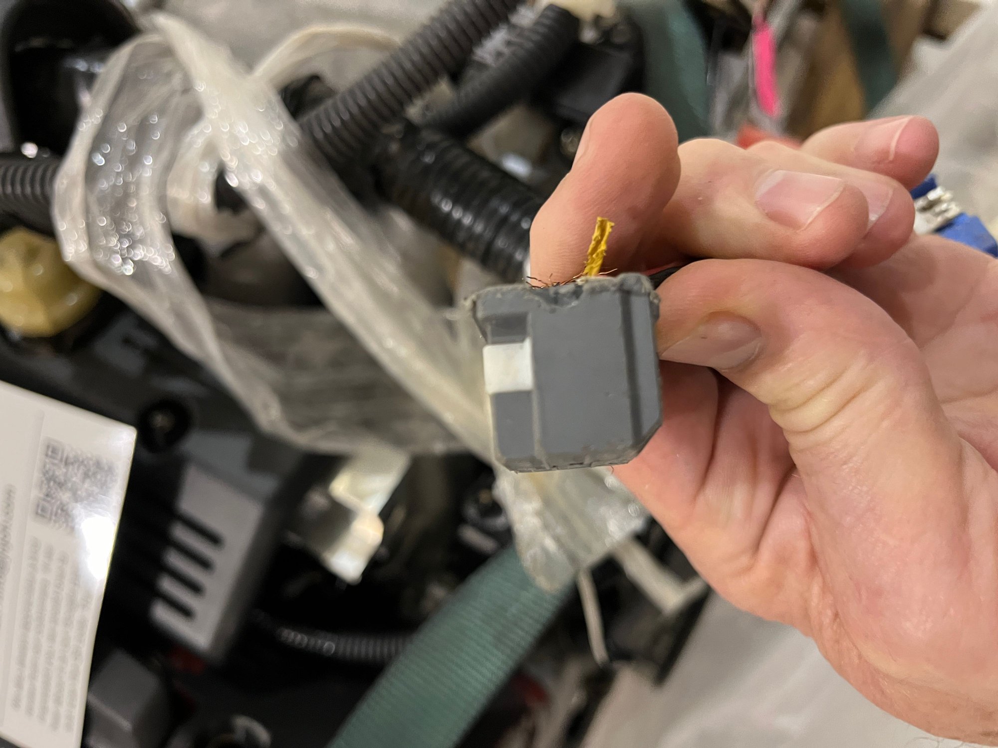

I purchased an engine from a reputable salvage yard that have full video of the engine running and provided a guarantee to go into my S2000 (2002). I purchased the S2000 with a blown engine and I'm in the middle of an engine swap. The issue is that they damaged the wiring harness when the pulled the engine. It looks like they crushed it with setting the engine on the shipping pallet. I need to see if I can find these three connectors. Any and all help will be appreciated. I have checked with Ballenger Motorsports and they said they didn't have any of the three. I'm new to the forum and I thank you for your help.

Ouch. A Solutions may be a source to get used ones but they may want to sell an entire harness vs cutting one up.
I know a friend said they use findpigtails.com to find OEM style connectors. Maybe an option but I have not ordered from them

That is my backup plan. I will still need to identify the pins used, some are damaged. If you have any suggestions on the pins used that information would be welcomed. Thanks for the quick response.

https://www.corsa-technic.com/item.php?item_id=1343
Here's the first one, check for the rest.
