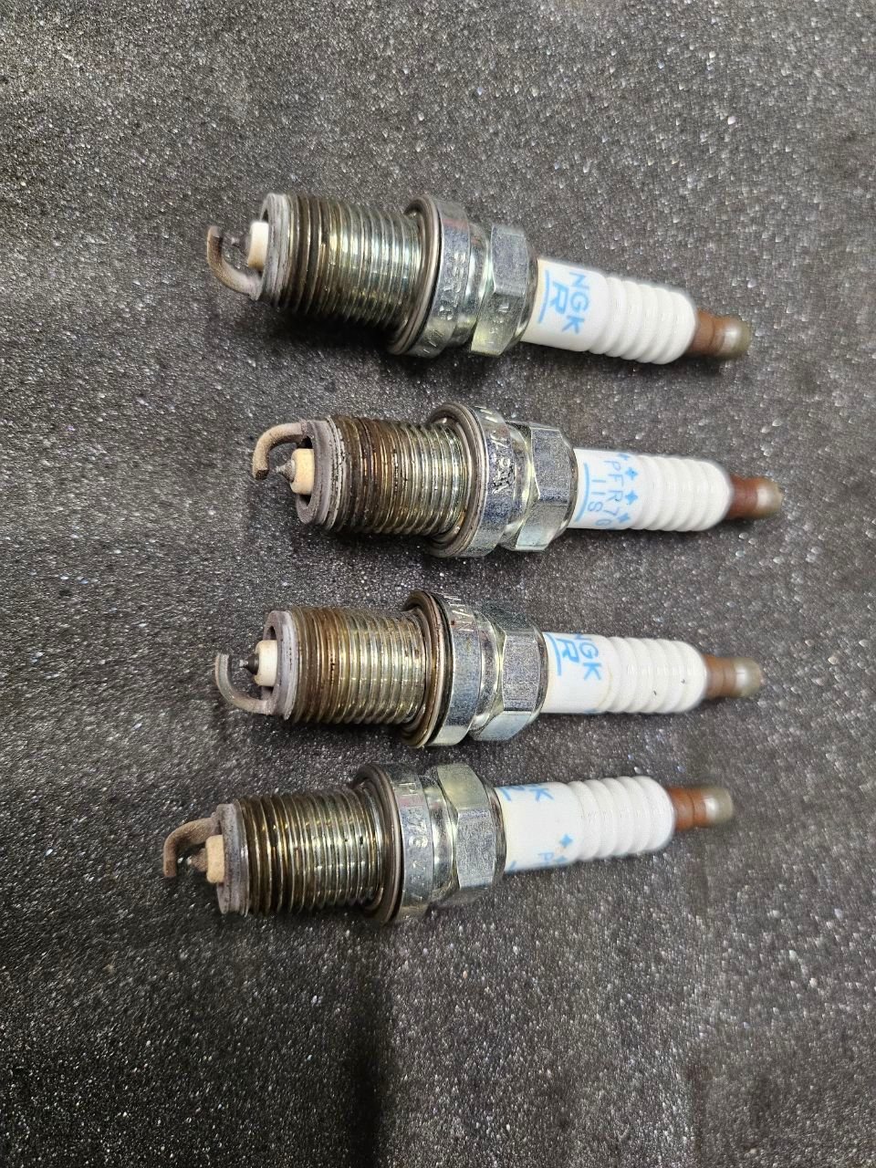

In the last two events last year (WGI), I was getting multiple cylinder misfire and cylinder 1 misfire codes. After clearing the codes they would typically pop up when idling in the paddock (not while on track).
What's been done so far:
- replaced all the coilpacks with new denso ones
- got replacement spark plugs, but the previous ones were fine (changed maybe ~1 year ago) so left them (see pics below)
- valve adjustment (with guidance of my s2k mechanic friend) -> this cleared the multiple misfire code, not the cylinder 1 misfire
- compression test (it was a cheap tester so the gauge might have just been off; will retry with a different kit later)

Your plugs dont indicate bad rings or even a misfire.
However, inverting your cyl 1 leakdown numbers, it would point to like a 80% leakdown. Your friend would hear that even if she were deaf and 5 miles away. Imagine opening a valve on the air compressor to allow 80% of the pressurized air to escape.
Double check your leakdown test. Post here to get more advice.
For the 3 sets of results, she did repeat the test three times for each cylinder for validation. I also found it odd that she couldn't hear where the leaking 60 psi was going, but hopefully we get some more info tomorrow and I'll update the thread accordingly.
In terms of the plugs, what would I expect in such a case?

If your engine's bottom end was leaking all that compression, your plugs would be oil blackened and wet. And you'd be blowing massive smoke.
So it turns out that the leakage was coming through the throttle body.
