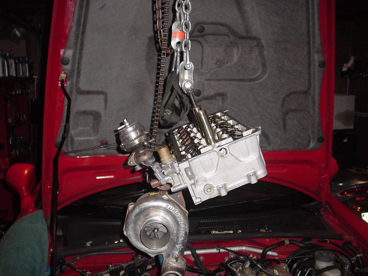

Billman, I noticed in one of your threads a while ago you were using some eye bolt looking things you screwed into the spark plug holes to use as attachment points for the engine hoist. Could you post some pictures of them and tell us where you got them?

I made them from old plugs, long bolts, and large washers.
Would you trust two of them to lift the whole engine out?

Two are without a doubt strong enough to pull the engine. As long as you grab full length on the spark plug threads.
