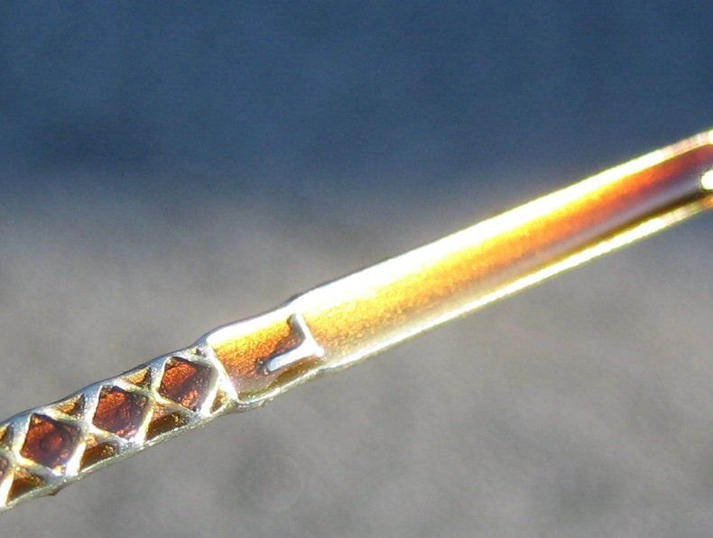

Tuesday night, I drained the oil and replaced the filter. I did not see any noticable metallic bits in the oil. This fill had about 3500 miles on it when I drained it:
After replacing the filter and filling it back up with fresh oil, the whine/screech from the motor was still there, but I saw my normal 80psi of oil pressure. There's still definitely an additional unhealthy noise. I posted a video capture to google here: link to video

After reading your post. If you pull the pan and don't see any signs of metal shavings inside, you should also check for bearing material in the oil. You can visually inspect it by looking for a greyish soot like material in the bottom of the pan; the bearings themselves are usually made from a nickel derived material and it is easily distinguishable in your pan.
