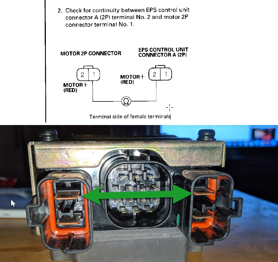

Hey All,
My car has an EPS light on originally its had CODE 3 and CODE 23. I swapped it out with one I bought on Ebay and now I just have CODE 3.
I read the manual and a little confused on it. Does it want to to test connectivity between the two 2P connectors or the 2P connect to the EPS Module?
Old Aug 16, 2019 | 02:51 PM
Longvl85's Avatar
Joined: Aug 2019
Posts: 34
I think maybe they want me to the unit itself....
If that is the case then there is connection there.
Old Aug 16, 2019 | 02:55 PM
Longvl85's Avatar
Joined: Aug 2019
Posts: 34
Then step 3 says to test the next set. there is no continuity between those. So it says to repair the wire between EPS and Gear Box? I think this is the RED and Green Wire.
