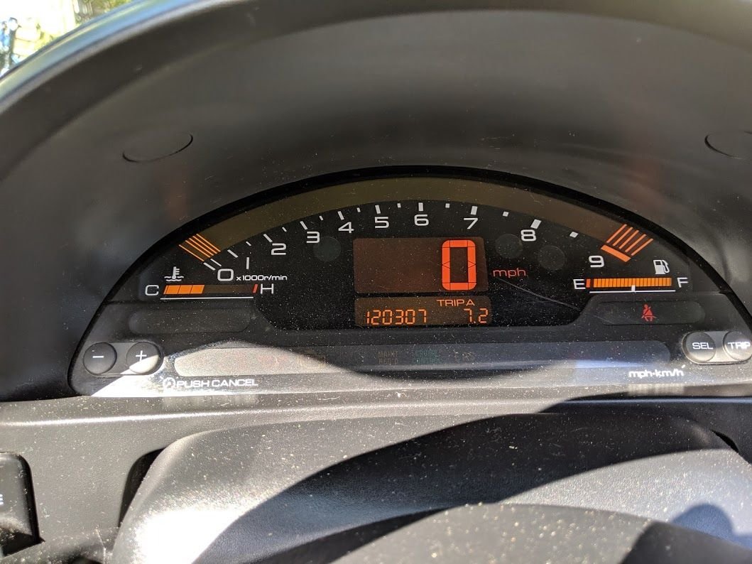

I am happy to report that I have power steering agian. It was definitely a learning experience doing this all my help. so to sup this up
Issue 1:
EPS CODE 23
Resolution:
Replaced EPS Module and do Relearn
Issue 2:
EPS CODE 3
Resolution:
Replaced Steering Rack.
Old Aug 26, 2019 | 11:47 AM
Longvl85's Avatar
Joined: Aug 2019
Posts: 34
Nice to have no EPS Code flashing.
