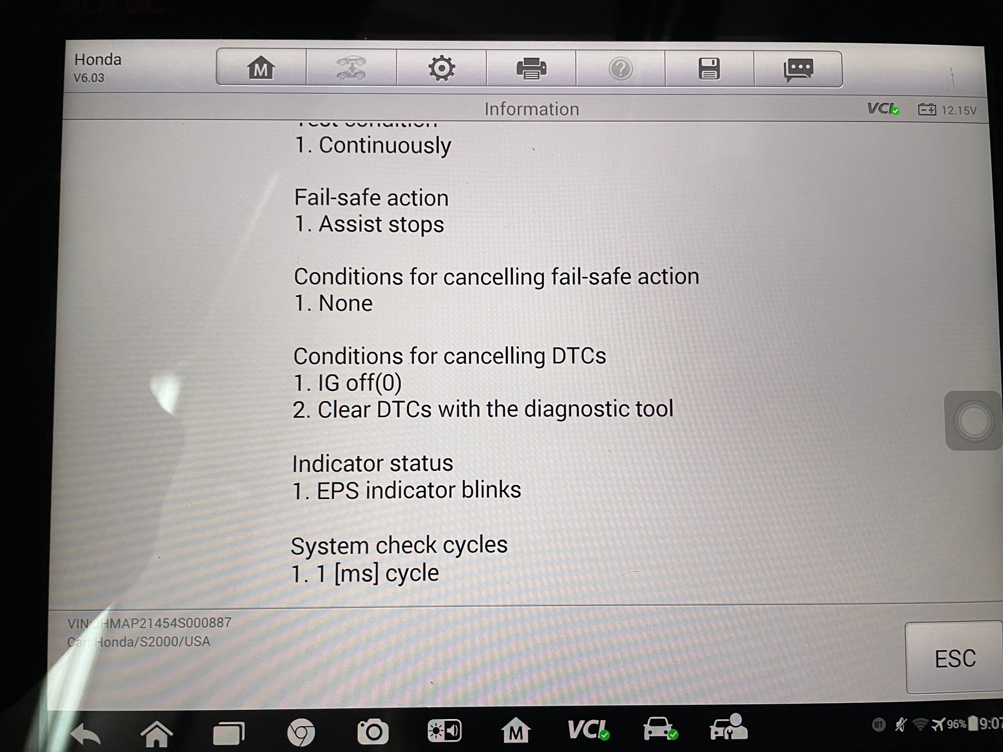

I currently own a 2004 S2k with 42,000 miles on it. I have been struggling with the dreaded EPS issue and I cannot figure it out. I would love some help if anyone has had success sorting theirs out.
What’s happening:

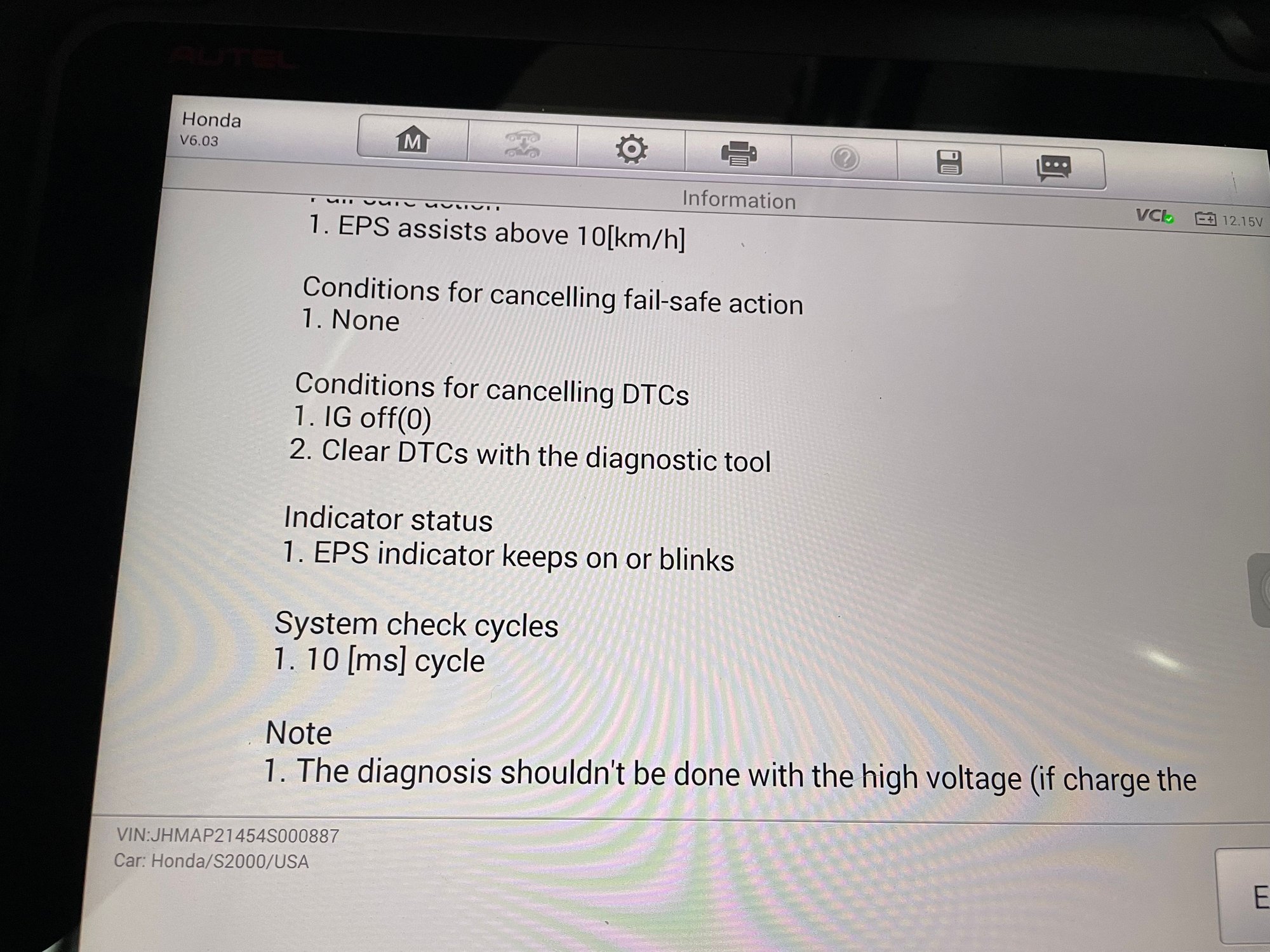

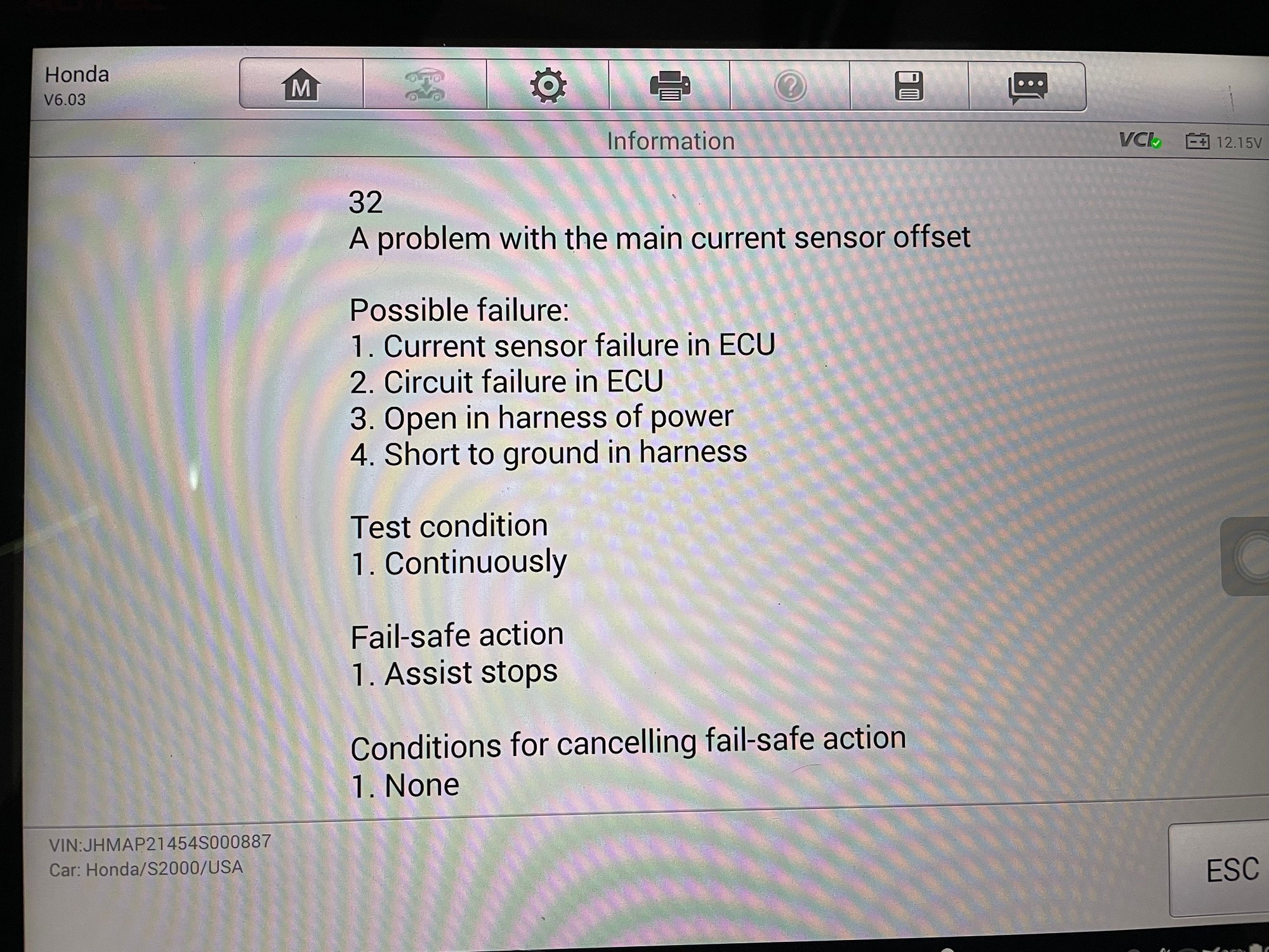

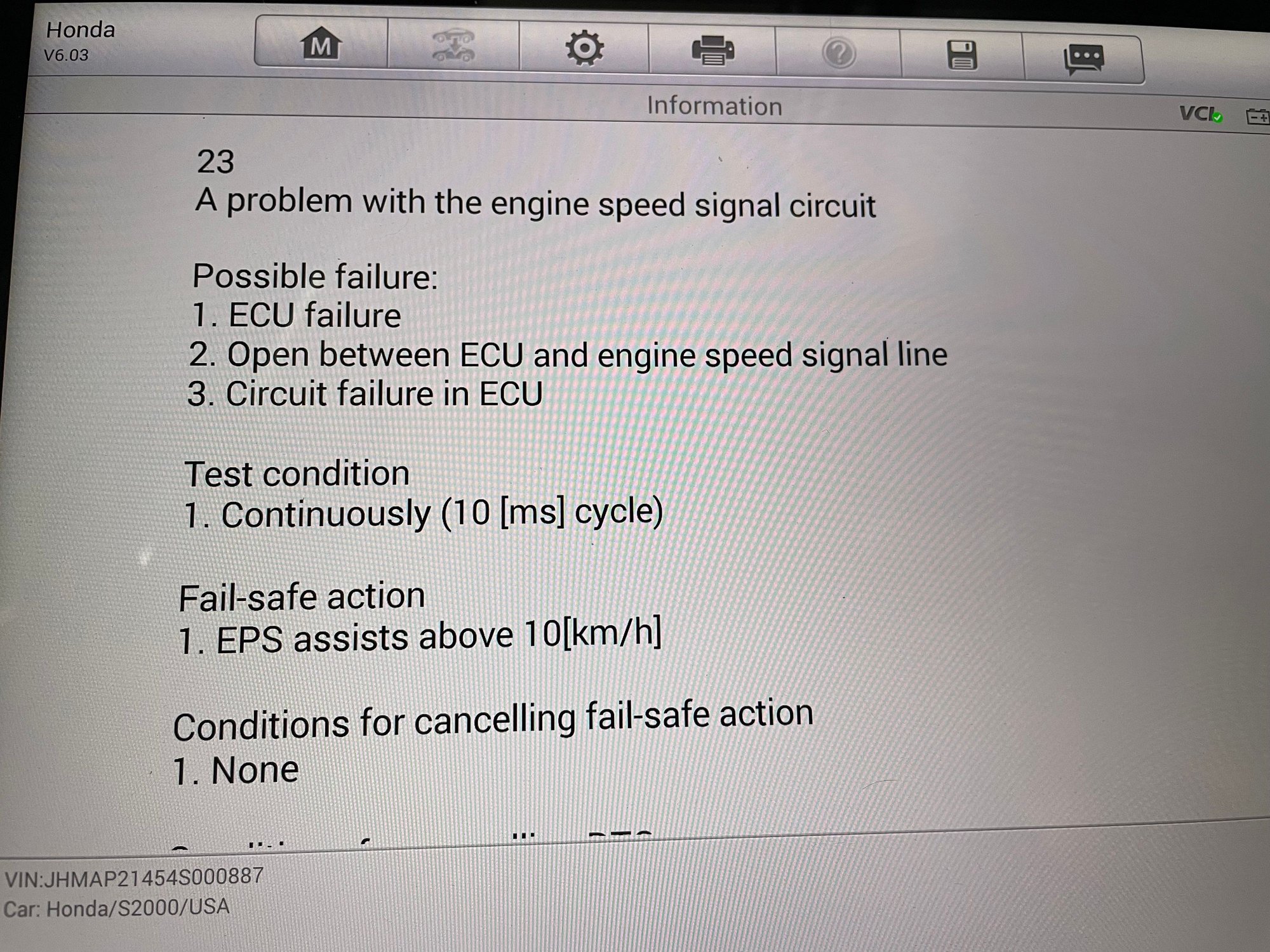

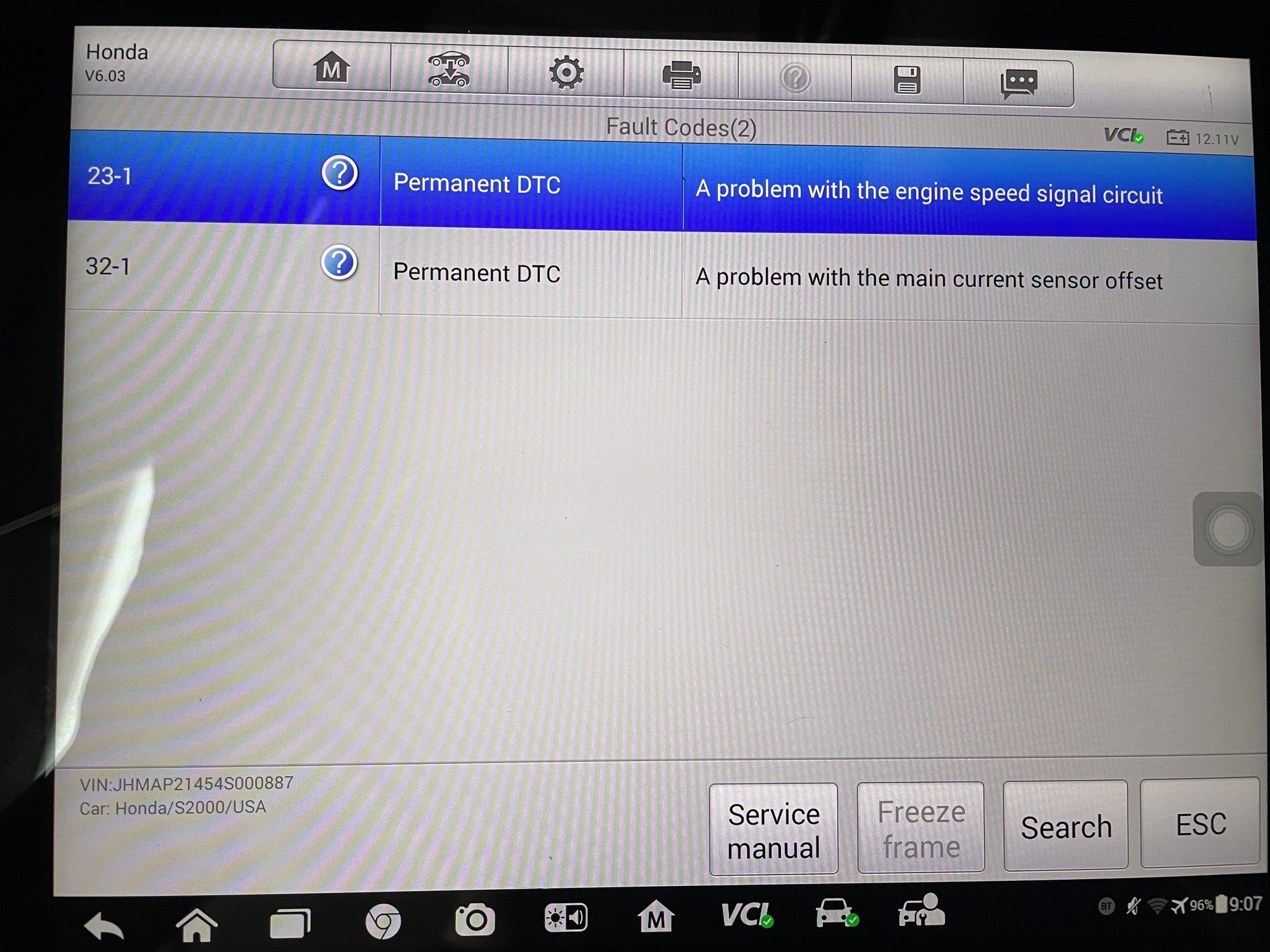

When I start the car and back it out of my garage, as I am turning the steering wheel left I feel small jerk in the steering wheel then I completely lose power steering. I have a friend who is a mechanic who scanned the car and the following codes are coming up. See the attached picture.

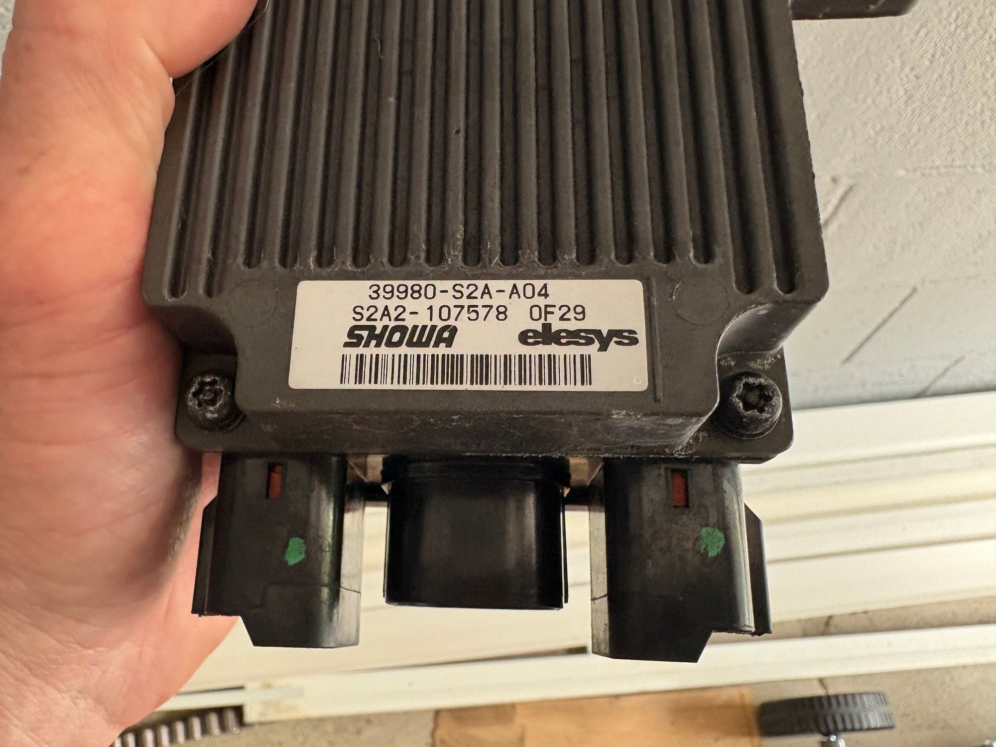

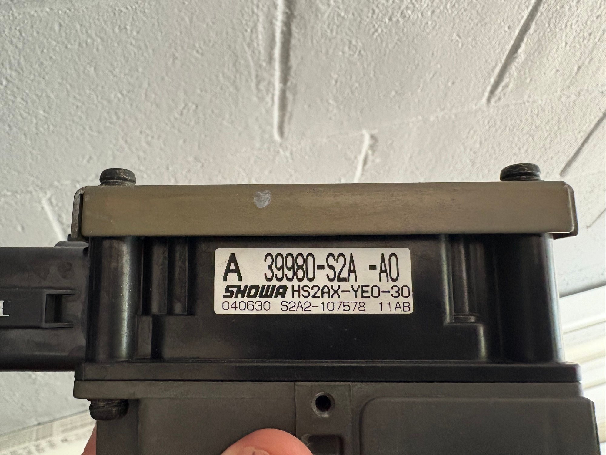

The photos are different sides of the same EPS, right? These parts are fairly common on Ebay.
According to a Honda part search, the following EPS control units are interchangeable for 2004-2009 US Base AP2 models: 39980-S2A-A03, 39980-S2A-A04, 39980-S2A-A05.
I didn't find an A0 ((zero) but A01 and A02 are for the early (2000-2003) cars with a faster steering ratio, 13.8:1 compared to 14.9:1. Early 2.4 vs later 2.6 steering wheel turns lock to lock.
