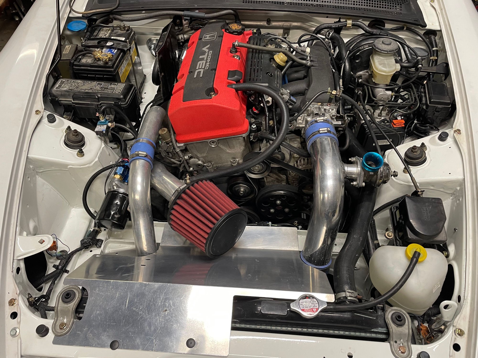

Hey guys, hoping to get some ideas on an extremely odd issue I can't figure out - here's the important facts
- car sat for about 2 years now for maintenance and turbo kit - but ran perfect before it was put back together
- Pulled the engine and everything in the engine bay for a full bay respray
- Has a greddy turbo kit installed with a KPRO v4 - Ballade no sensor swap harness ( tried two of them) but also issue happens on stock ECU and no harness
-While the engine was out, did the usual stuff, valve adjustment , installed a oil baffle plate, revised oil squirters, new clutch, PP, flywheel
Main issue : Car will only start maybe 1 out of every 20 times, but when it does start it idles fine and everything seems okay, the tune is obviously crap on the kpro since it's not tuned yet but this happens as well with the stock ECU and injectors.
Sometimes when the car cranks and starts up, it does run for a second and dies, but the injectors still run and the fuel pump is still running , could be a hint ?
Most of the time it's a crank / no start situation
So far I've:
Verified the grounds are connected - G101 behind the head, and the 2 at the driver underneath
Tried factory injectors , Map sensor and ECU - Happens with both RC550's and stock injectors
Checked plugs (were new) and coil pack resistance
Checked crank position and cam sensors
checked map sensors - both with stock map and hondata 4 bar map
Timing is 100% good
Here's a video of what's going on -
Most of the time it's the crank no start -
Things to do: it doesnt seem like it would be the issue but I'll be installing a fuel pressure gauge into the fuel rail so im able to see if it's a pressure issue but doesnt seem like it. What else can I check? Car is not throwing a CEL either
