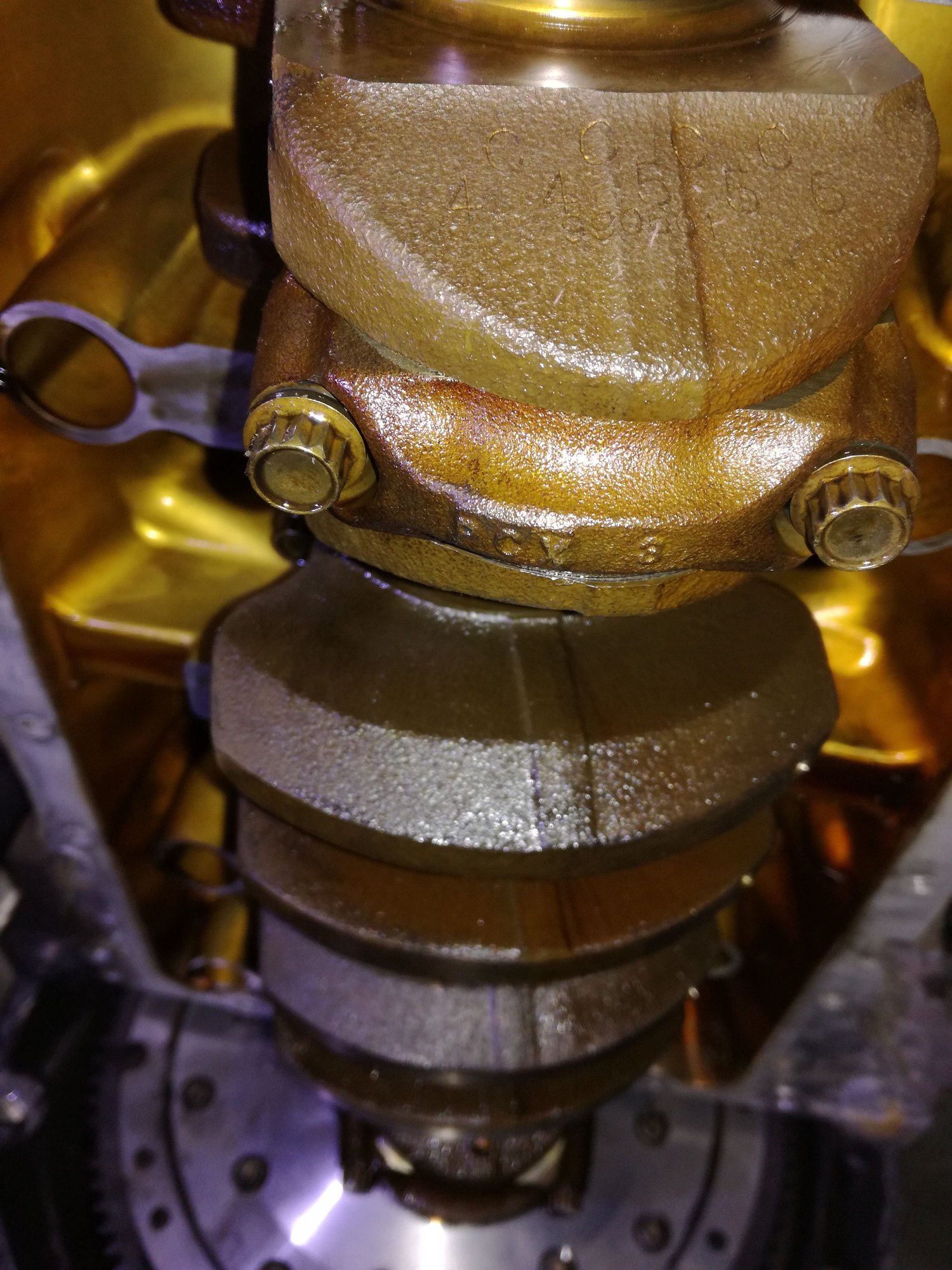

Let's say all my bearings are fine, and I just to replace them as a preventive measure, can somebody now please tell me what OEM part number should I order, taking in consideration all my markings and charts above ?

I can't see the paint, probablly because of the heat, but I can see the markings, let's say main bearing no 1: D9F top, D9F bottom. What OEM part numer should I order ?

Those are my rod bearings, they are perfectlly fine, can you tell me what Oem part numer they are ?

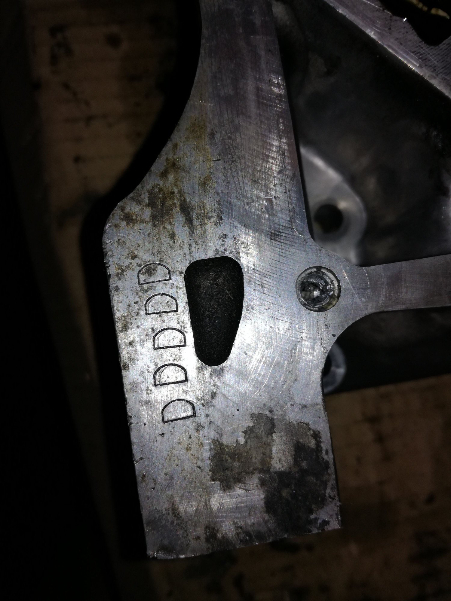

Crank numers is Cccc 44556 and block is ddddd

The connecting rod bearings pictured are not oem. The numbers do not coincide with the Honda color coding system.
A lot of S2000 conn-rod bearings are green, if you are looking for a baseline. But there can be any combination of colors in one motor. Your motor could have come B-Y-Y-G. So just order green, whatever Honda part number that may be. Or you can enter the crank and block letters into the Honda color size chart to gauge the original color bearing.
But I believe you will find out that it may not spec correctly due to usage, and you will need to move along the color chart to adjust the clearance to proper.
