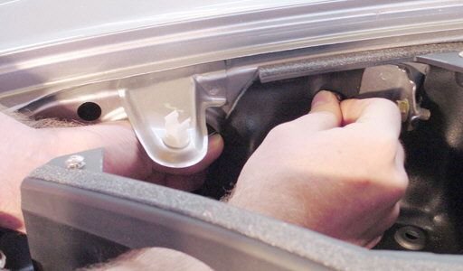

Here's a pic of this step from my Ice Box install. Note Darkknight's tiny little hands fit nicely into the fender hole to hold the bracket while he hand threads the bolt through the screw hole by sticking his hand through the filter hole. You have to be a bit of a contortionist.
Mean while, I'm snapping pictures while he works on my car. Hummm, what's wrong with this picture John? I swear to god that my hands were too big to fit .. really. Next time you get to take the pictures.
