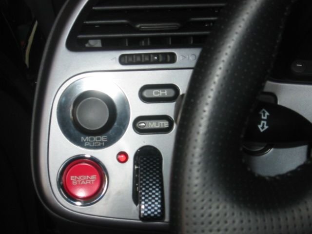

Custom Nitrous switch and ARM LED:

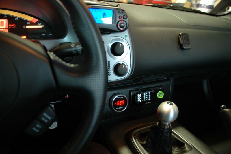

Remote Nitrous Gauge in radio door:

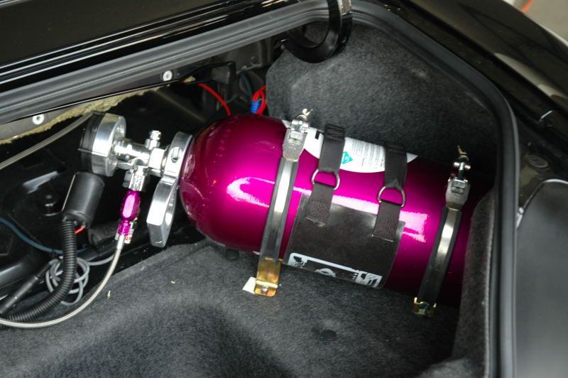

Remote Nitrous bottle opener, heater, and pressure sender:

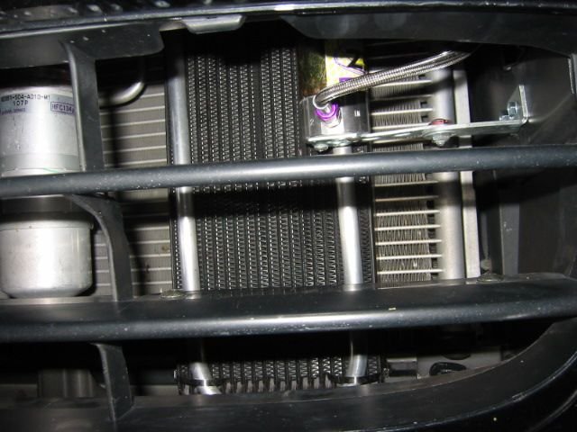

Purge kit into Vortech Aftercooler (N-ter cooler style)
