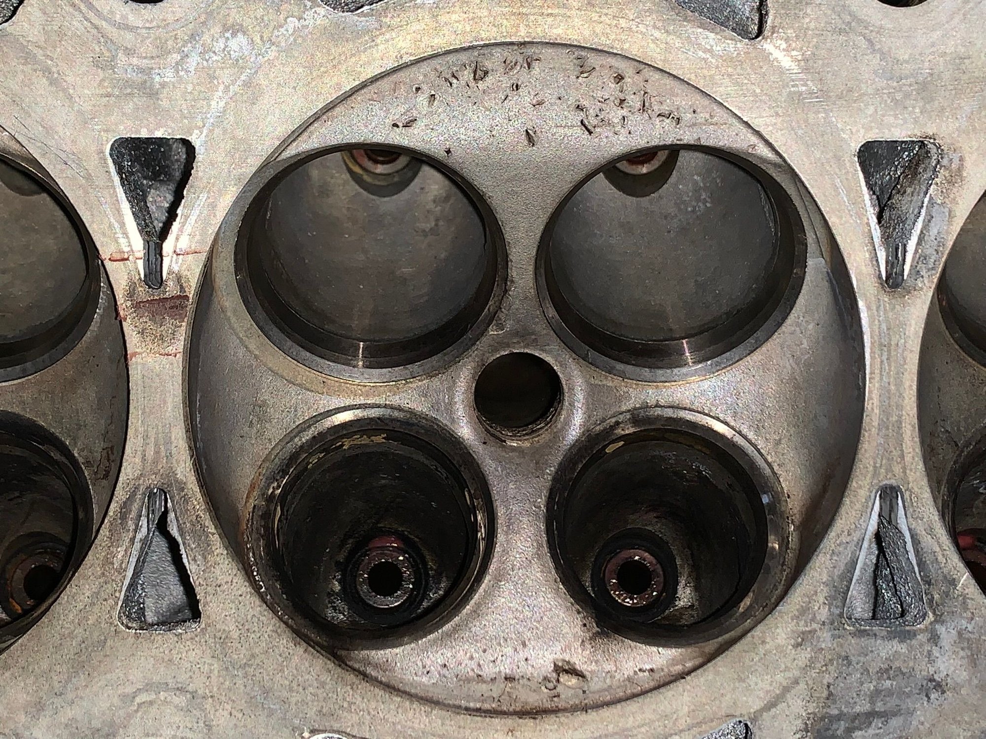

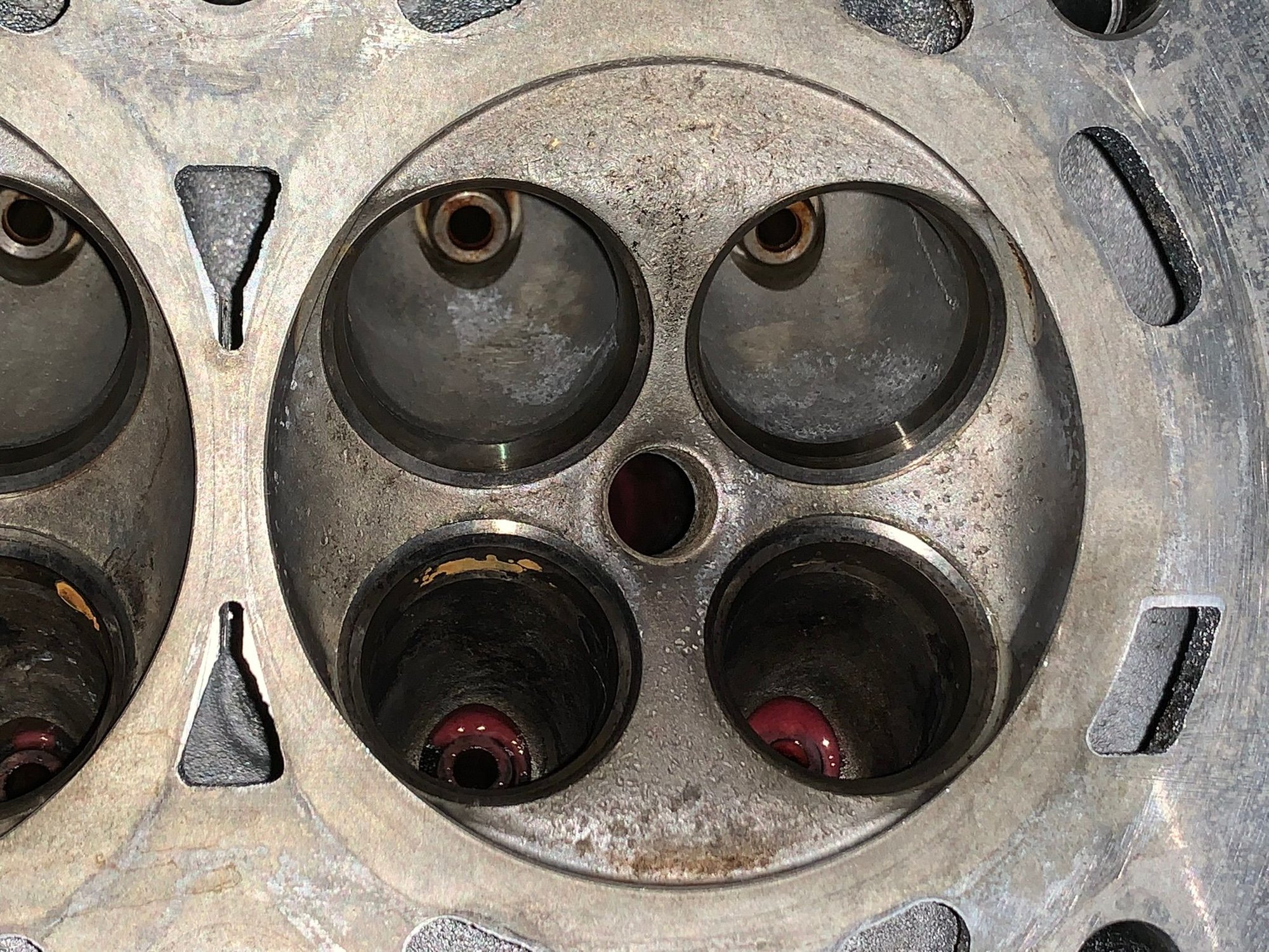

I meant the inside of the heads cylinder chamber, where it's damaged. I'm wondering if that can be fixed, or if the head is unusable for the rebuild? such sharp edges may surely create hot spots so they have to be dealt with, but not sure if that much material can be taken out of the heads combustion chamber.

There is a engine build process commonly referred to as 'cc'ing the head'. It involves machining the combustion chamber area (same area where you note damage), so that all combustion chambers are exactly equal in volume.
So machining that area isn't unheard of. But not sure that much can be removed, without lowering compression ratio significantly.
The existing damage, the raised areas, would likely cause hot spots that would make pre-ignition more likely.

Doesn't look to bad though,could just remove high spots with something like a sharpie ,was more concerned with corrosion around water ways.Think its good to keep the mottled finish as much as possible,as is designed like it for a reason.
Thanks will consult and machine shop about it
