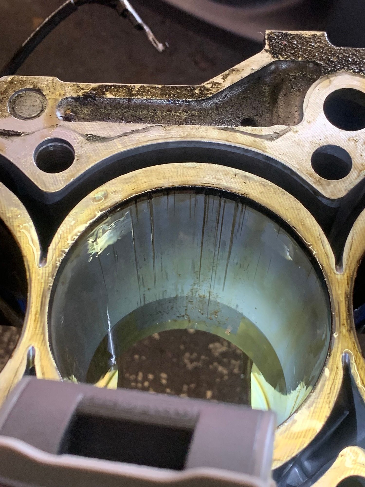

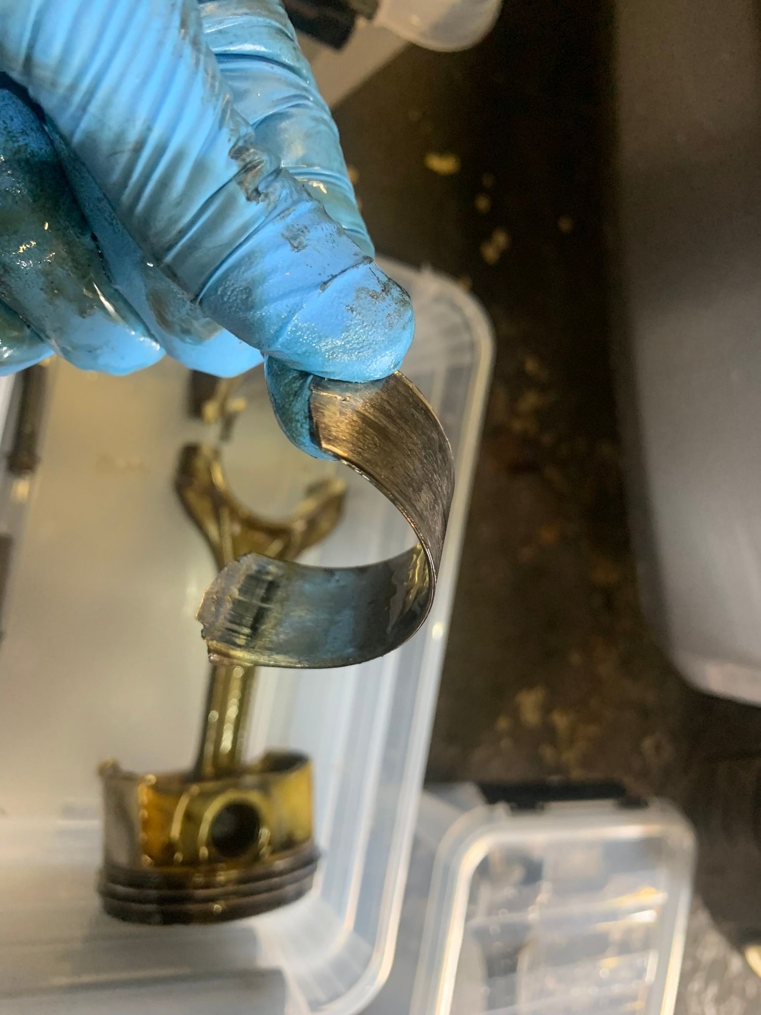

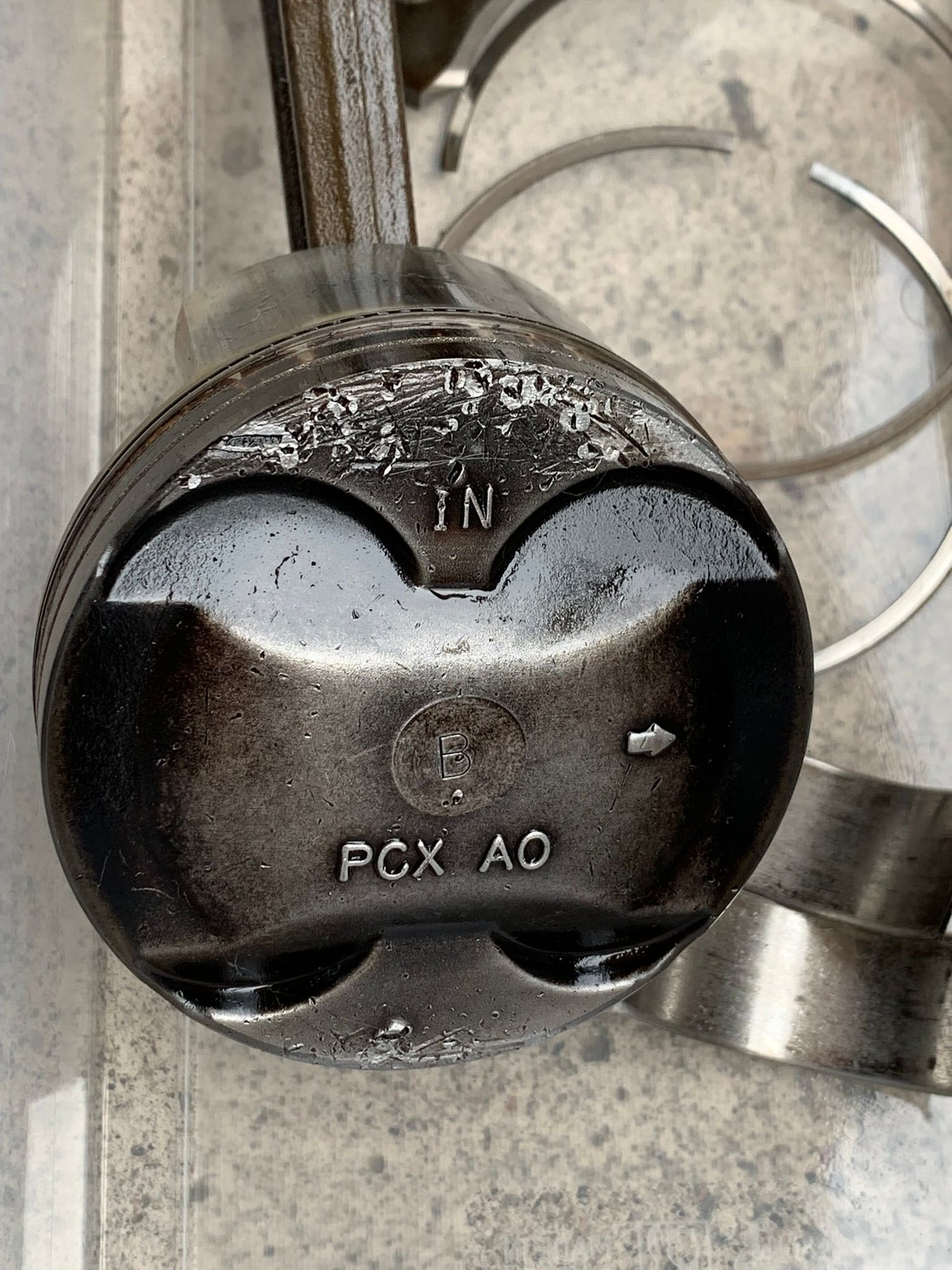

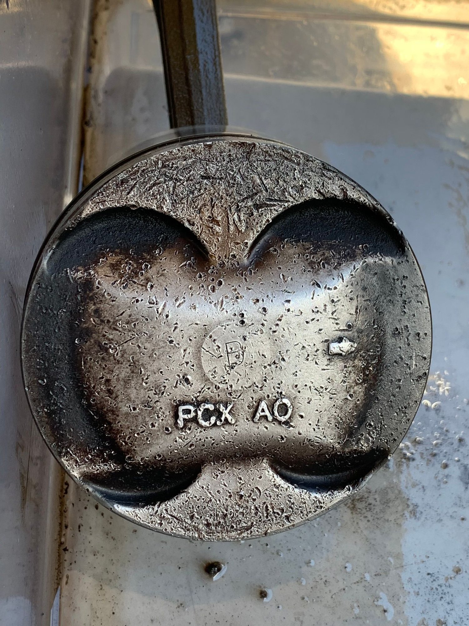

Disassembly reveled heavy damage on 2 of the pistons, deeply scratched cylinder walls and one heavily grinded down connecting rod bearing - photos at the end of the post. Rest of the engine seems fine.
From the research Ive done i have figured out the cylinder wall is probably beyond fixing, as the FRM coating is quite thin. So as for cylinder walls im going to go the route of stock diameter darton dry sleeves, which i have already ordered.
Pistons
Next i need to figure out which pistons to order, power wise im keeping the engine stock and just trying to build up the engine to stock standard.
There are CP forged pistons, but they don't seem to have stock compression rate, closest one seems to be 12.5 - does that matter?
Mahle ones say "For Use In Factory FRM (Fiber Reinforced Matrix) Cylinders Only" on some sites, meanings they are no go with sleeves?
Wiseco seems to have 11.1 and 11.4 compression ratio pistons, thats more than stock - but again does that matter?
Wössner has 11.7 compression rate pistons, again is that a problem?
Is there any other choice i should consider? Any advice here is appreciated, as i would like to place the order soon.
And can i use my stock connecting rods with these pistons if they are okay tolerance wise?

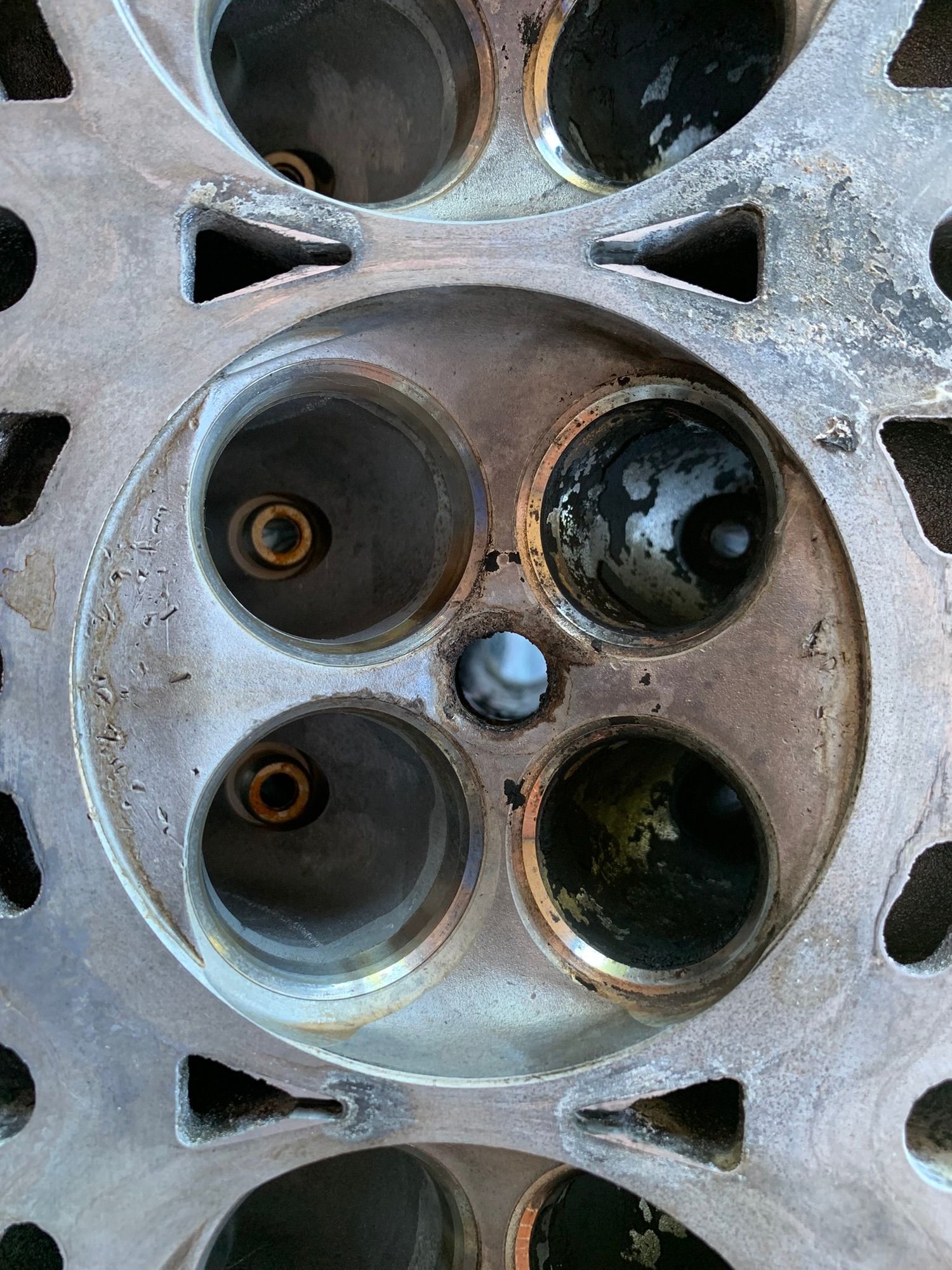

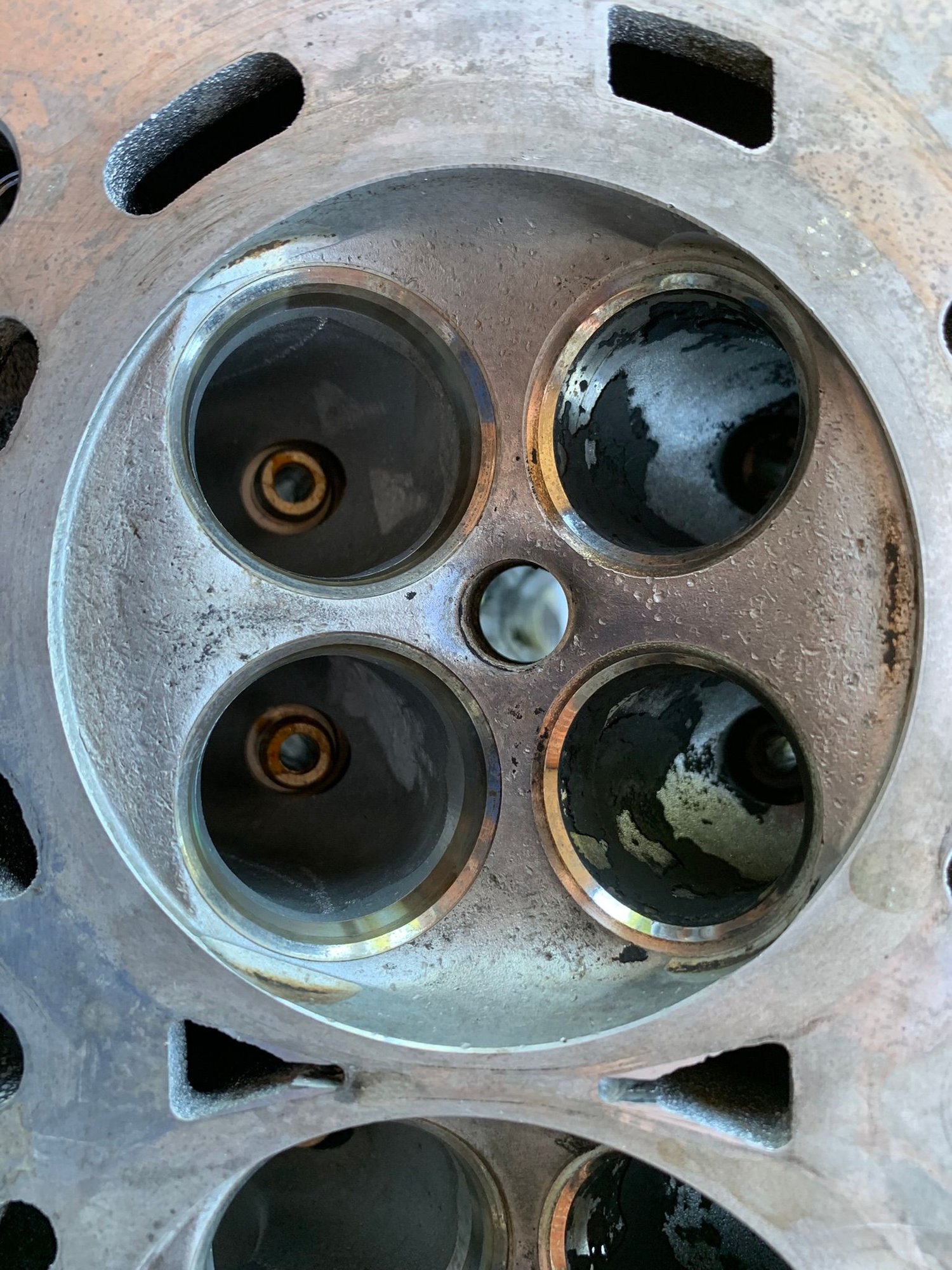

Head damage
Not sure how the cylinders and pistons of cylinders 2. and 4. got ****ed up that badly (photos below), perhaps an object / parts got into the intake, but it also left some damage on the heads combustion chamber.
How bad does this damage look, and is there anything i can do to save the head?

Since you want to do a stock rebuild you should use OEM parts wherever possible. No reason reducing reliability by going aftermarket without getting extra power for it in return.
JDM F20C had 11.7:1 compression and that still runs fine on EUDM ECU and RON98 fuel, 12.5:1 is pushing it a little bit more but anything below 11.7:1 is definitely fine.

... higher compression can lead to pre-ignition, knock. Requires higher octane fuel to prevent. Engine will pull timing when knock sensed, which greatly reduces power in our engines.
So yeah, what he said. 11.7 ok (use high octane fuel, which should be doing anyway with these motors), higher than that for race car race fuel, for street driven stock build not so much.
You know about matching bearings to motor, right? These engines were habd assembled. Tech would measure crank and rods, crank and block, and select bearing sizes for each location. Each rod, each main. If crank isn't being machined, use bearing sizes factory used. If crank is machined, will have to try different bearing sizes in each location, carefully using plastigauge to find right bearing for each spot. That means buying lots of the different bearing sizes, and having a bunch left over.

I would image the head can also be made usable by grinding the damaged surface by a professional? or a bare head without internals shouldn't be too expensive if i manage to score on? everything else on the head is fine.
If the head can be fixed by lightly grinding the surface, should all of the 4 cylinders be done? by intuition i would imagine ground up chambers would have slightly smaller compression ratio, thus the energy from the explosion in the chamber is not symmetrical with the non-ground chambers and that may cause fatigue damage in long term? of course the difference might be so marginal that it does not really matter in the real life.

If you machine the cylinder head or top of the block you'll bugger the valve chain geometry and the cams and valves won't align properly. These engines are totally reliable until they break after which they rarely experience a successful rebuild.
-- Chuck

I would not buy a sleeved S2000.
10-20k miles max if your lucky then another cylinder bore and new pistons and another £k? expense
Cranks can not be re-ground on an S2000.
Heads can not be skimmed due to TCT issues.
Non Honda Pistons dont fit Honda rods,so allow for new con rods<pin size difference >
