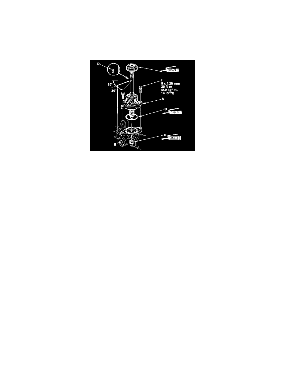

2. The stamped letters do NOT need to be straight up. According to the service manual and diagram (quoted below), within 30 degrees is acceptable. Mine did not go in perfectly straight up and it works fine after the repair, I just had to shift the steering spline over one notch to get the wheel straight. I did not need to reprogram the center potion.

-----------------------------------------------------------------------Steering Angle Sensor: Service and Repair
Torque Sensor Replacement
Note these items during replacement:
Do not allow dust, dirt, or other foreign materials to enter the gearbox.
Do not try to disassemble the torque sensor assembly. If the torque sensor is faulty, replace it as an assembly.
If the torque sensor is replaced, the EPS control unit must memorize the torque sensor neutral position.
1. Center the steering rack within its stroke.
2. Remove the torque sensor assembly (A).
3. Coat the new O-ring (B) with grease, and carefully fit it on the torque sensor housing.
4. Apply grease to the needle bearing (C) in the gearbox housing.
5. Install the torque sensor assembly (A) on the gearbox housing by engaging the gear.
The alphabet stamping (for example "AB") (D) on the pinion shaft aligns with the rack guide screw (E) when the rack is in the straight ahead
driving position.
When installing the torque sensor assembly, make sure the "alphabet" stamping ("AB") is within the range.
6. Tighten the 8 mm flange bolts (F).
