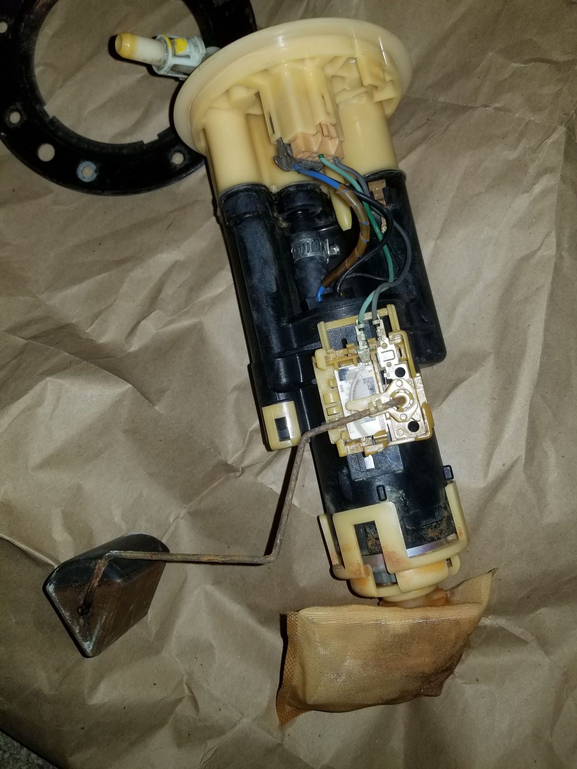

Late update. The rusty gas tank was causing the misfires from the fuel injectors continuously getting clogged by rust after having to take the injectors out and cleaning them multiple times. After replacing the gas tank and the fuel pump assembly, the misfire is finally gone and the engine couldn't be any happier since then.

jeezus.
thanks for the update.
how common is it for the tank to rust like this? doesn't seem normal.

How did you find the rust?
Maybe the PO ran without a gas cap or it was loose?

Damn that’s crazy! Never seen that before

How does that even happen on this car?! Looks like you would have to run the tank dry, pull the pump hanger assy out and let the car sit outside for several years in a wet environment. Even then its not like its directly exposed to the elements. I don't get it.
