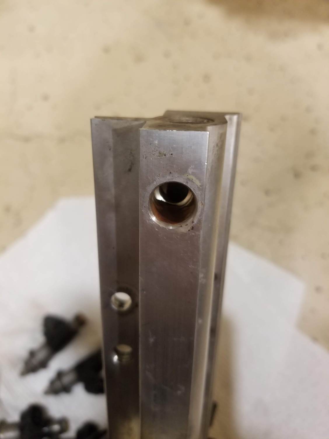

Okay to the next thing to troubleshoot, the fuel injectors. The pictures are self-explanatory. Look how dirty those holes were! Carefully cleaned them making sure none of the gunk fell inside the hole. Cleaning the fuel rail and fuel injectors were satisfying, watching all that gunk get blown out with the carburetor cleaner. Replaced o-rings, seals, and filter baskets.
Put everything back together. Turned the key to the ignition position, and there was a gas leak, noooooo. Went out to look for a replacement top washer for the pulsation dampener... Grabbed a M12 oil drain aluminum washer with rubber coating from O'reillys, it worked perfectly, no leaks. Now to start the car, she starts, and it already started to sound a whole lot better than before. Drove the car around, the acceleration was so much smoother, it didn't sound/feel like a sick person anymore. Checked the engine codes, and the misfire codes were finally gone! I'm still a bit skeptical, too early to celebrate kind of thing. Still no misfire code after 15 minutes. So far so good. The next day, ran some errands, and no more misfire codes. But... of course there's a but, can't fix something without something else breaking. There was a P1457 code that was pending after cleaning the fuel injectors, and stored the next day, but it was easily fixed by tightening the gas cap. After that, there's a P1410 code... I'll mess with it another day, maybe with the bypass thingy.

I'm wondering whether I should go ahead and pull my injectors too and clean their holes on the manifold like you did. You surely depressurized the fuel system by pulling the fuel pump fuse, then started the car and let it switch off by itself to use up all the fuel in the rail before removing the rail, correct?
I got the spark plug tube seals replaced too, they were indeed solid hard and a pain to get off.
Yep I did exactly what you said regarding depressurizing the fuel system along with disconnecting the battery and putting bunch of napkins around the fuel hose before disconnecting it so the fuel doesn't drip everywhere.

Alright cool. I may give the injector inspection/deep cleaning a try too.
