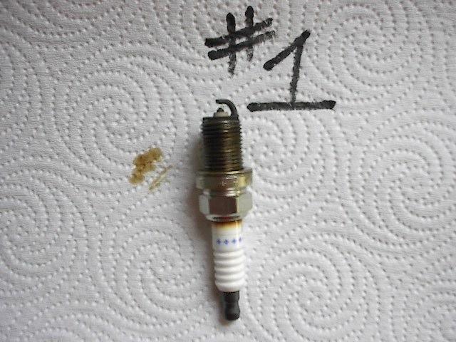

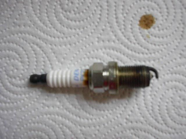

After reading Roger's and Barry WY's posts about the Netherlands recall and problem with #4 spark plug and cylinder, I checked my #1 and #4 plugs today. My car is MY2000 with 9,800 miles. No sign of tapping noises or performance problems so far. I use 93 octane fuel and have had 2 oil changes. Currently on synthetic oil changed by the Honda Dealer. However, both plugs #4 and #1 show oil fouling, sooty electrodes, and scorched insulators. I expect #2 and #3 are the same.
Please advise me as a newbie whether:
1) I should just change plugs and keep monitoring the situation.
2) Reinstall the plugs and take into the Honda dealer for service.
3) What to say to the dealer as far as expectations for service.

I'm attaching pics of plug #4
and plug #1 so you can see what I attempted to describe.
Please be patient, this is my first attempt posting pics on this forum.
I've never seen oil on a plug (on the threads) and the scorching (on the insulator) like on my car. These are the OEM (Denso) plugs with 9,800 miles.

Thanks Xviper. The plugs were easy to remove in the first place. I am entering my VIN in profile to try one more time to post pics. The oily spots on the paper towel were from the threads on each plug. Plug #4 is the second photo. The scorching is visible on the ceramic insulators. What causes that???

It's hard to tell from the photos, but they look pretty normal to me. Are you sure the oil didn't come in from the top of the valve cover? Each spark plug tube has its own O-ring gasket. If the oil was coming in from the cylinder, the insulators would be much worse.
Are the gaps correct on these?
You should probably just order the new plugs from www.sparkplugs.com

I concur with gernby. The scorching looks pretty normal except maybe for #4 which might be a bit more than what mine looked like. The oily depositsmight be a result of the plug not being screwed down tight enough. My plugs were oily too the first time but after I torqued them down, the next time I checked them, they were not oily. I'm no expert on the #4 cylinder failures but a loose plug may have something to do with it. In most 4 cylinder engines, it's the #4 hole that gets the hottest. It gets the coolant last.
