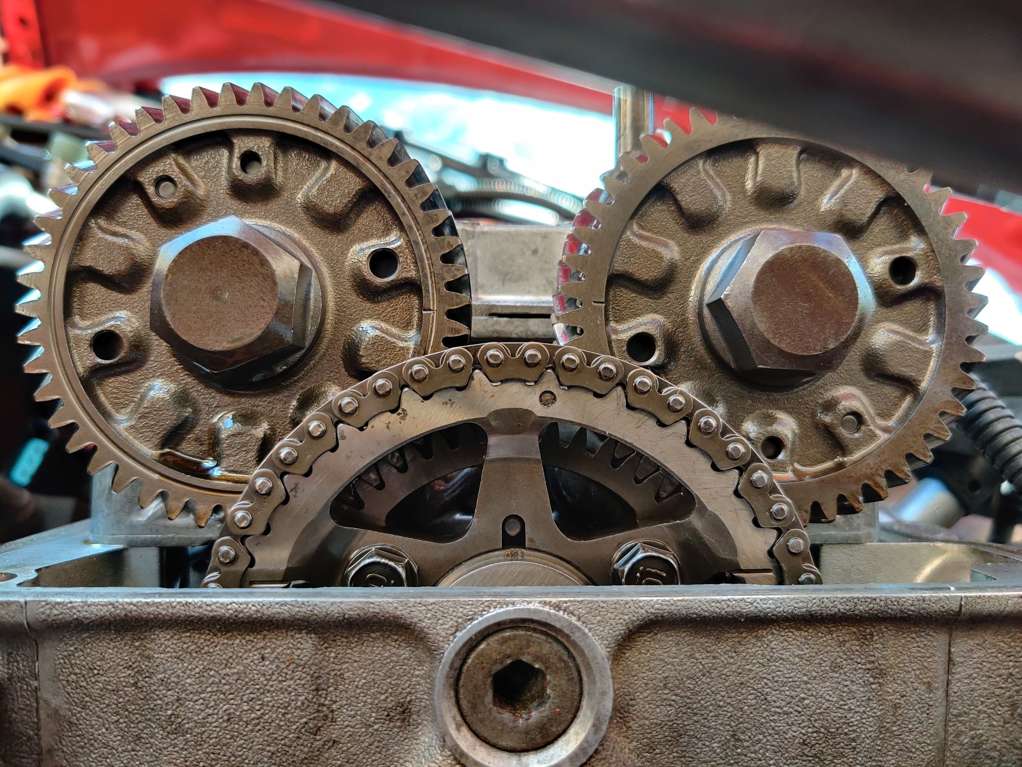

My timing marks were a bit intersting. If my crank pulley was lined up perfectly on the arrow my cam gear marks were just a hair off and if I lined up my cam gear perfectly, my crank pulley was just a hair off from the arrow. What do you guys think?
Cam gears aligned
Crank pulley just a touch off
Crank pulley aligned
Cam gears just a touch off

I think it's pretty normal for the crank to be just slightly off.
Doesn't sound good at all at VTEC there
Right! When I was assembling it, I couldn't for the life of me get the cams to line up with the crank set perfectly. I've been scouring other threads about timing and other people have had theirs further off than mine and report that the car runs decently still.
